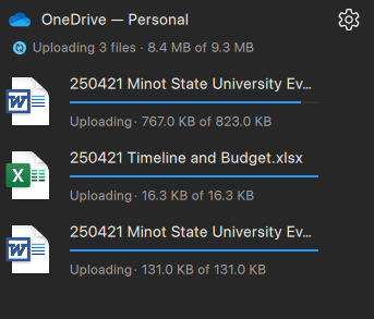

Buggy at best. I installed the other day. Now the finder and OneDrive not working politely with each other. When you move a file to or from a OneDrive folder, the "Preparing to move..." dialogue comes up and sticks there. Occasionally it is completing the move after 30 seconds or so, but most often it just sits. In the OneDrive dropdown (pictured), the three files have been sitting there for 10 minutes.
