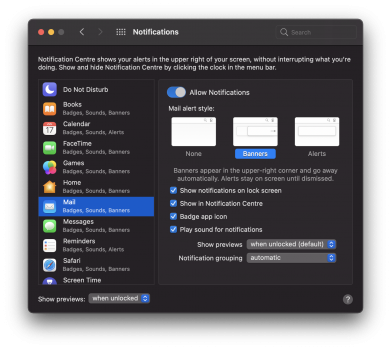

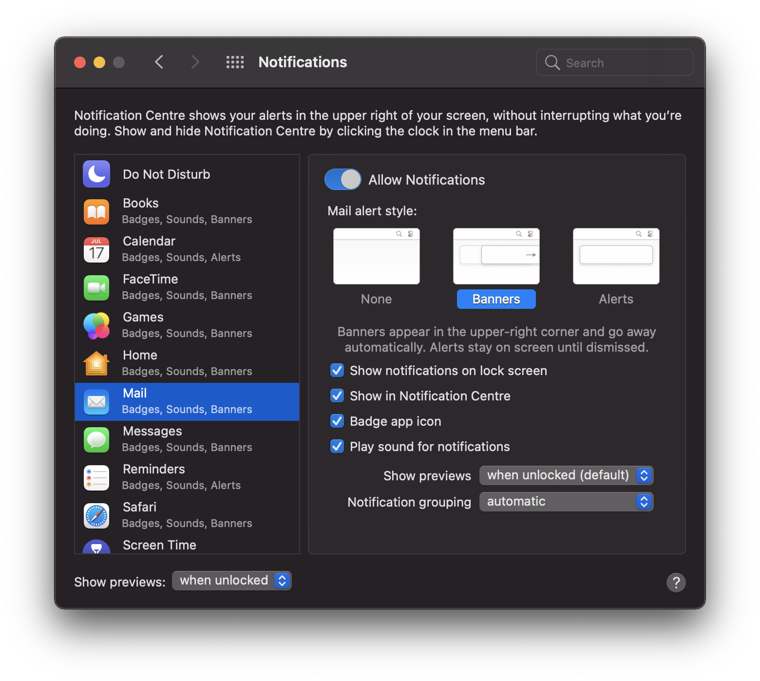

I created a new User Account called "Tester" and lo and behold these are the options I have in System Preferences - Notifications:

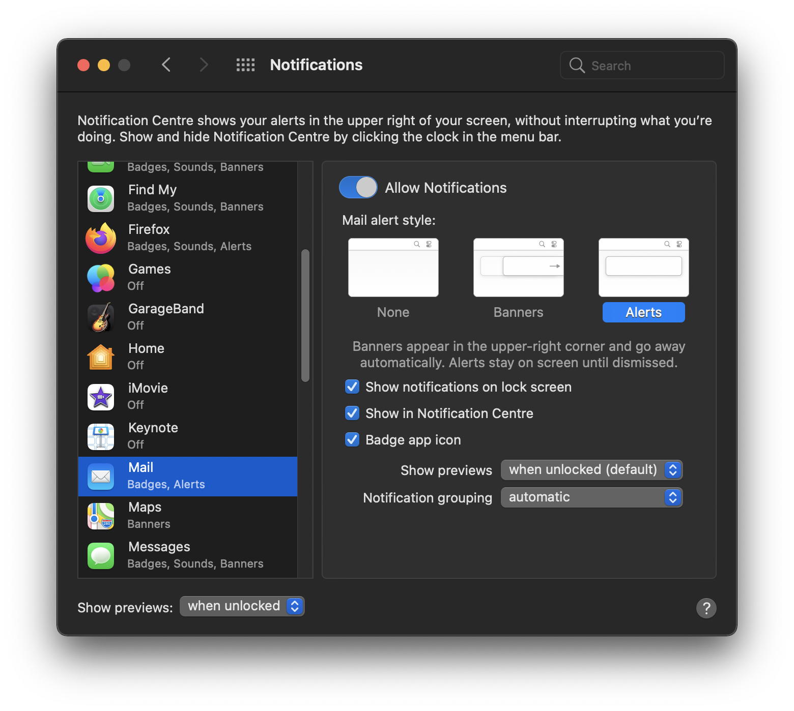

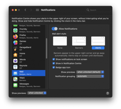

Instead this my main, Admin account's options:
How do I get that option to play sound, and why is it missing? 🤔
