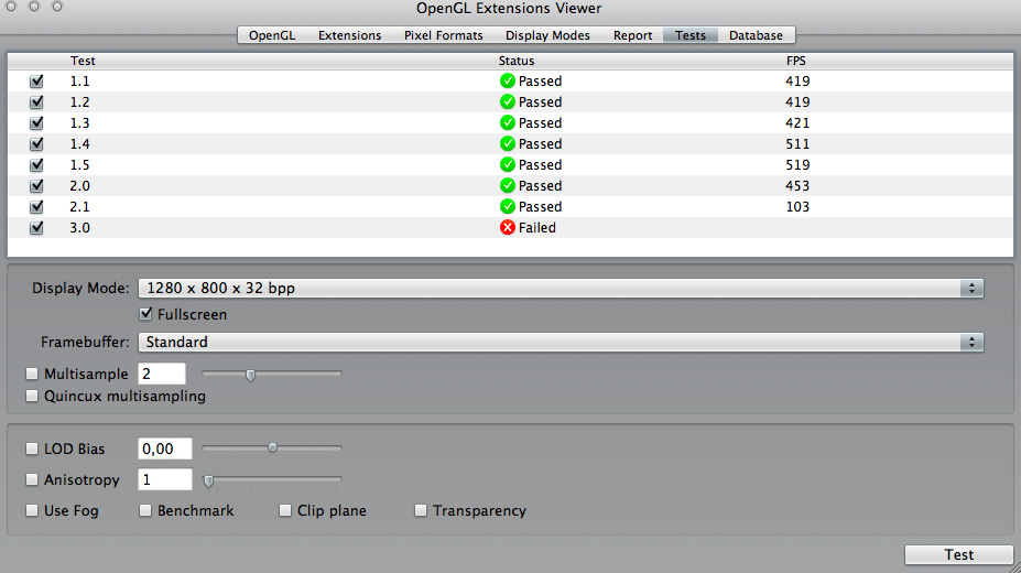

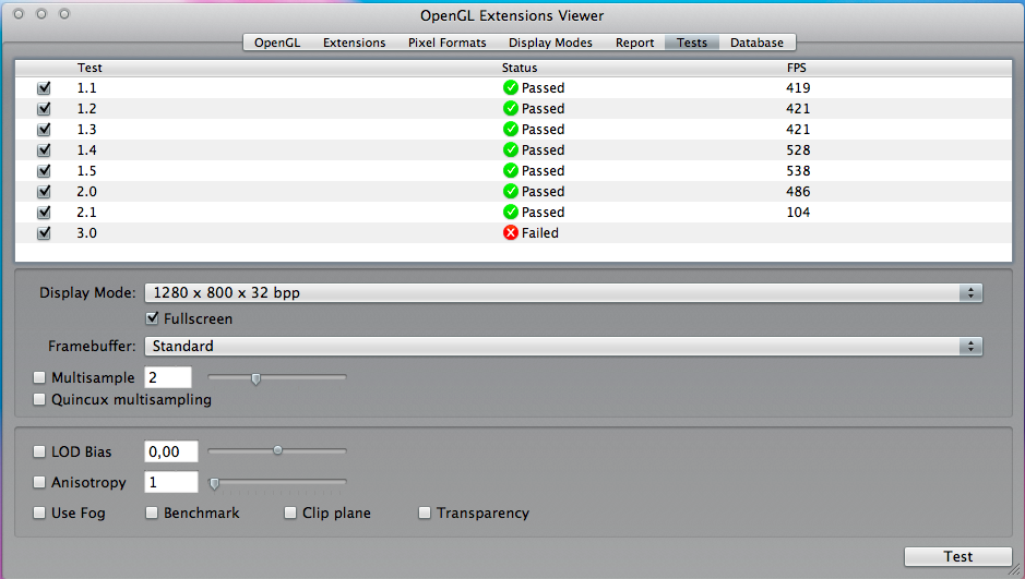

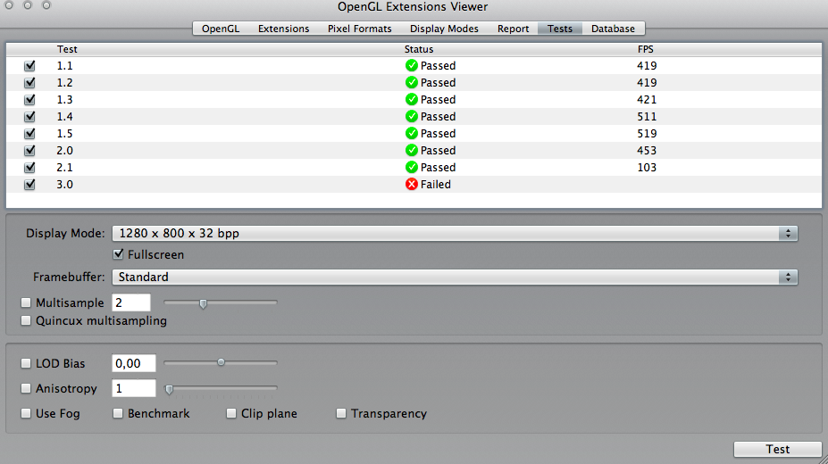

here's my test with my 13" MacBook Unibody first generation with 9400m
almost no changes with the new drivers 🙁

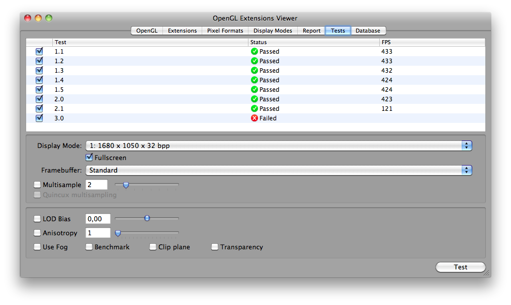

But i'm VERY happy with the results in my iMac.
For example WoW run ok (everything max no FSAA), still MUCH better than with windows 7 and now i can play with 2 - 4x FSAA mostly smooth.

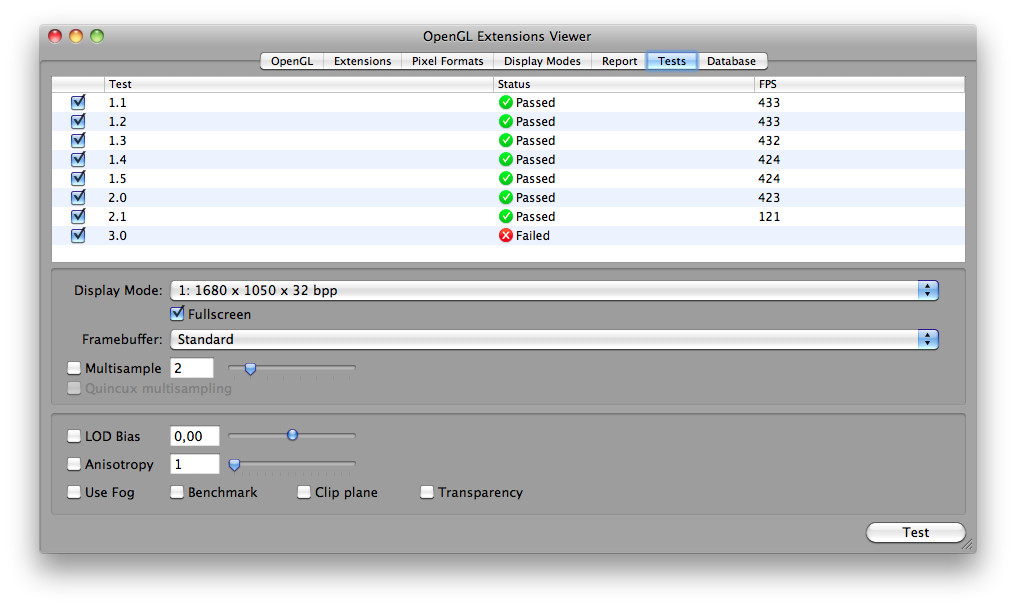

Look above these are the correct settings :
Please everybody doing these tests:
use OEV : 3.3.1 (they updated the new version)
use benchmarkmode
use Multisample: full
use Anisotropy : full
we have no comparable tests without this.

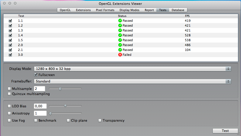

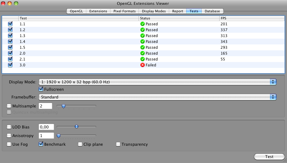

HD 5770
First test : benchmarkmode : multisample /anisotropy : 1
http://att.macrumors.com/attachment.php?attachmentid=246500&stc=1&d=1281953053
second test : benchmarkmode : multisample/anisotropy :full = 8/16
http://att.macrumors.com/attachment.php?attachmentid=246501&stc=1&d=1281953072
And look at this ! :
very strange : no difference between the 2 modes :
same framerate about 300 fr. in non AA mode and 16 mode

Interesting :
But please use the settings mentioned above.
i have a second diplay attached as well
no change in the benchmarkmode...

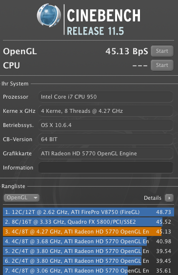

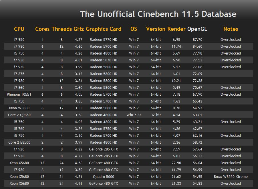

Top scores in OpenGL framerates

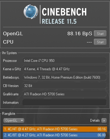

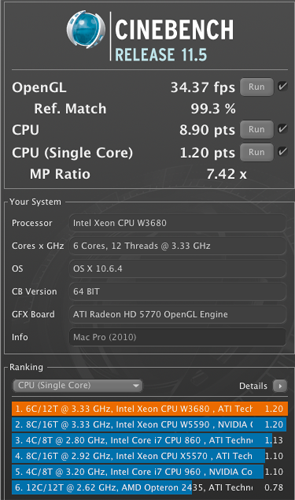

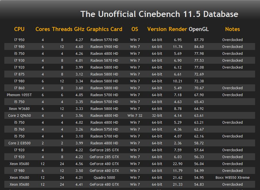

Built a new rig last week , some screens for you:
the new built is actually number 1 in Cinebench 11.5 unofficial database OpenGl Rendering
in Win 7 and OSX 10.6.4 (ATI Radeon HD 5770)
Some stock data:
Mac Pro 2010 (late August) 6 cores -12 threads
Framerate @ 3,33 GHz = 34,57 fr.
here:
Custom built Mac 4 cores -8 threads
Framerate @3,33 Ghz = 36, 82 fr.
Comparison : Apple MacPro 2010 vs. Custom Mac
Case : Lian Li ..(better cooling , better air flow , better fans ,dead silent)
CPU : i7 950 @> 4,0 (better cooling with 2 x 800 rpm silent fans in push pull)
GPU : ATI Radeon HD 5770 by Sapphire (advanced heatpipecooling -3rd generation)
RAM : 6 GB Mushkin Redlines 1600 6-6-8 (better RAMs -higher speed)
MB: Gigabyte ( USB 3 - Esata - 6 Gb Sata - 3 Hi-Speed PCIE-slots)
899 € with Win 7 on HD 1 ......MacOSX 10.6.4 on HD 2 - boot selection : F12
_______________________________________

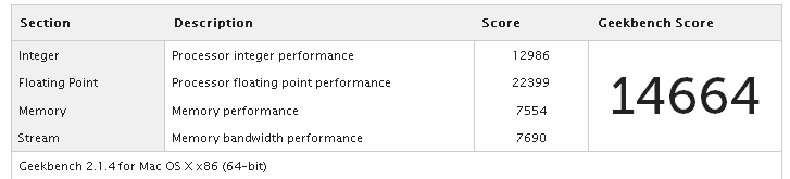

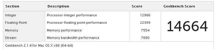

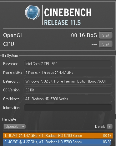

Best results :
My Custom built Mac OC :
Cinebench : OSX 10.6.4 : 45,13 fr.
Cinebench : Win 7 : 88,16 fr. (32 bit !)
OpenGL CPU : 7,1 pts.
OpenCL : 6,8 sec.
Geekbench : 14664
