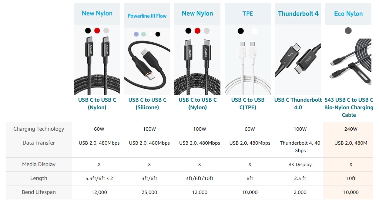

One of the issues is Thunderbolt cables or ones that support USB 3 speeds also tend to be less durable because of the extra wiring. See the attached image of some Anker cables. All except the Thunderbolt 4 cable are USB 2.0 speeds. The Thunderbolt 4 cable also only has a "Bend Lifespan" of 2,000 versus 10,000 - 25,000 for the charging cables.
There are options that aren't that expensive that do 100W charging, and USB 3.2 speeds, and supposedly have decent "bend lifespan" (https://www.amazon.com/Cable-QCEs-3-1-Thunderbolt-Compatible/dp/B07T19KQYF) but again, most people will just use the cable for charging so the extra cost for Apple isn't really worth it. It might only be a small expense per cable but that adds up with tens to hundreds of millions of them. Why do that if most people won't use it? Apple could have done it but there are tradeoffs in business. I'm not saying Apple's approach is correct, I'm just offering potential rationale.
Those who need to do data transfer with a cable should hopefully know about the transfer speed issues and buy a cable that will handle faster speeds. There are many options out there.
