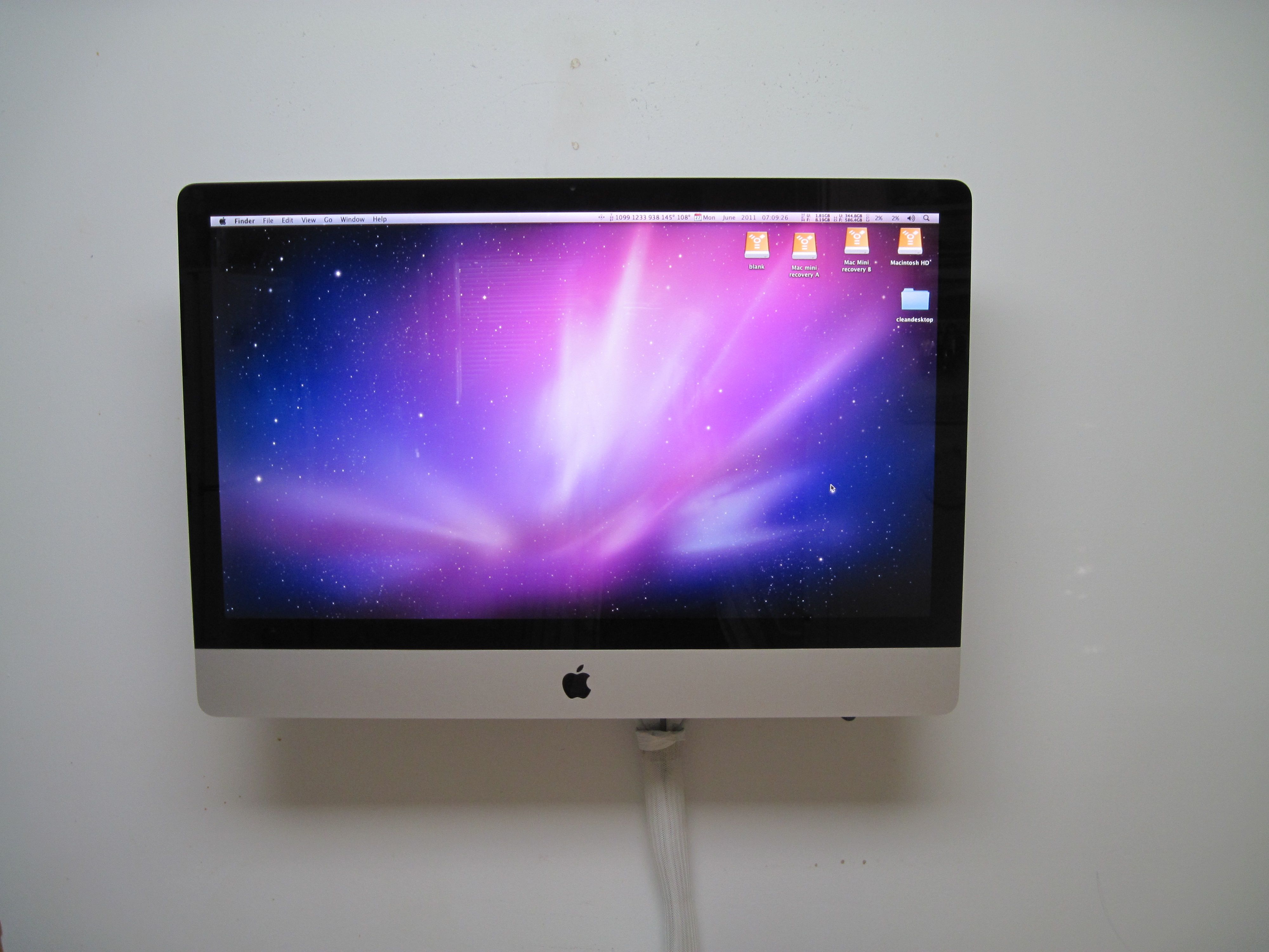

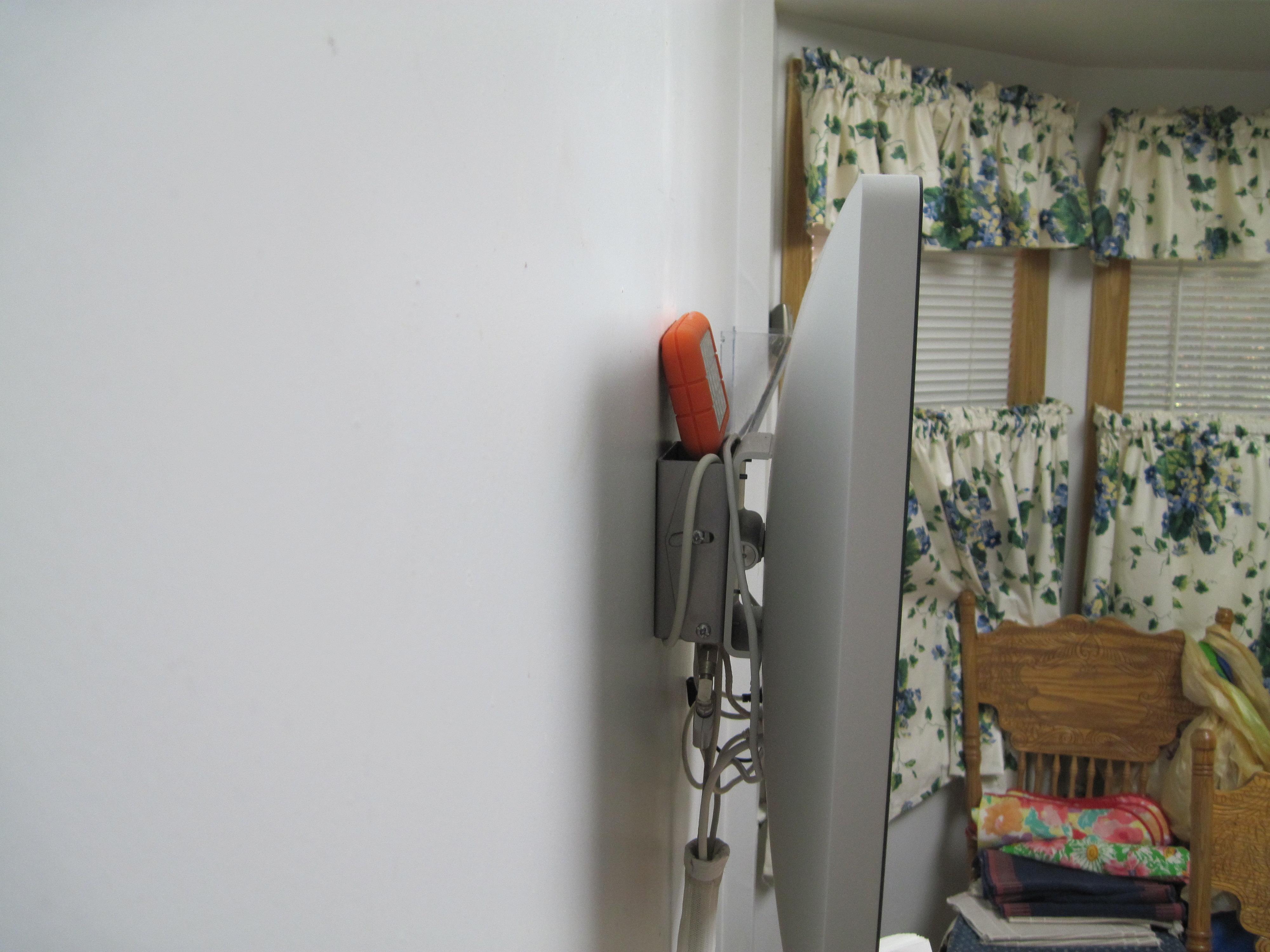

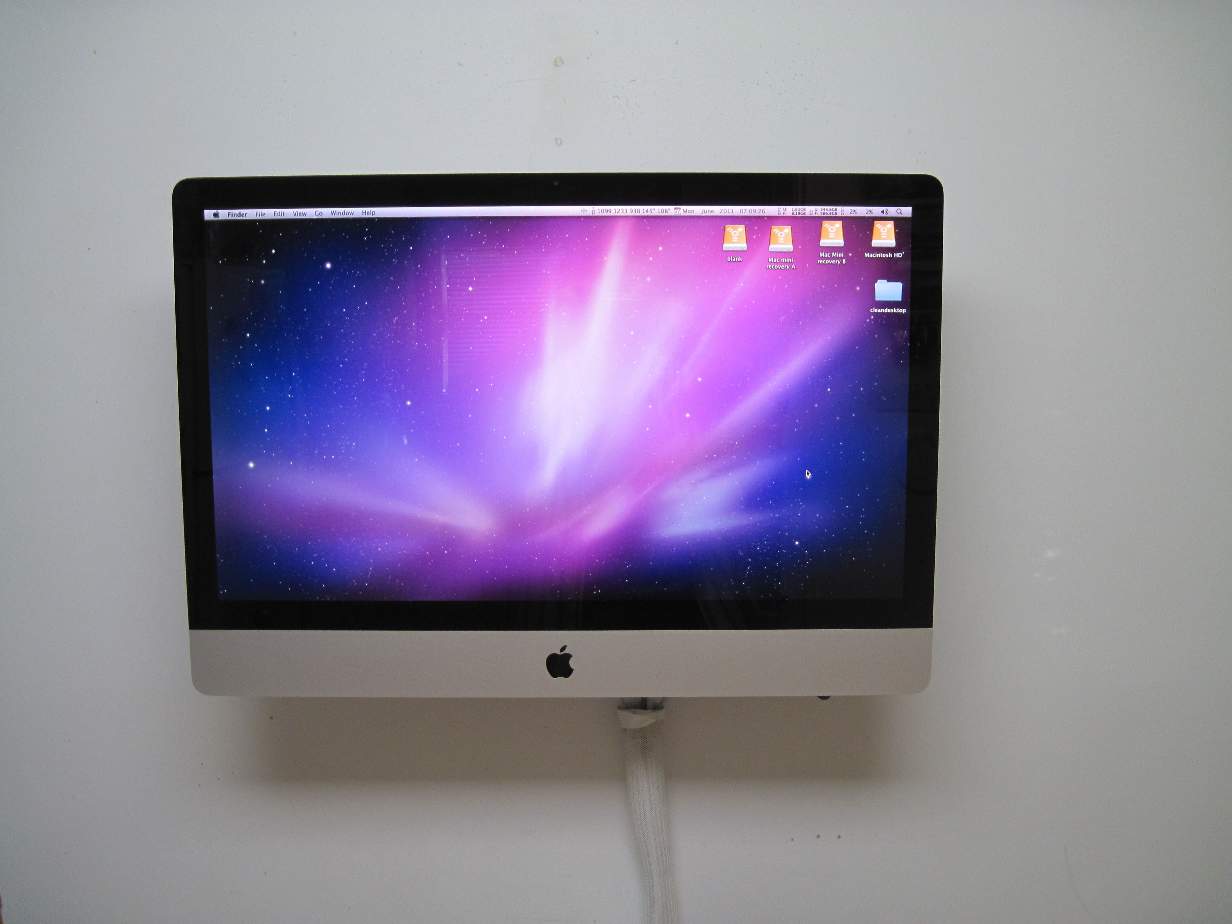

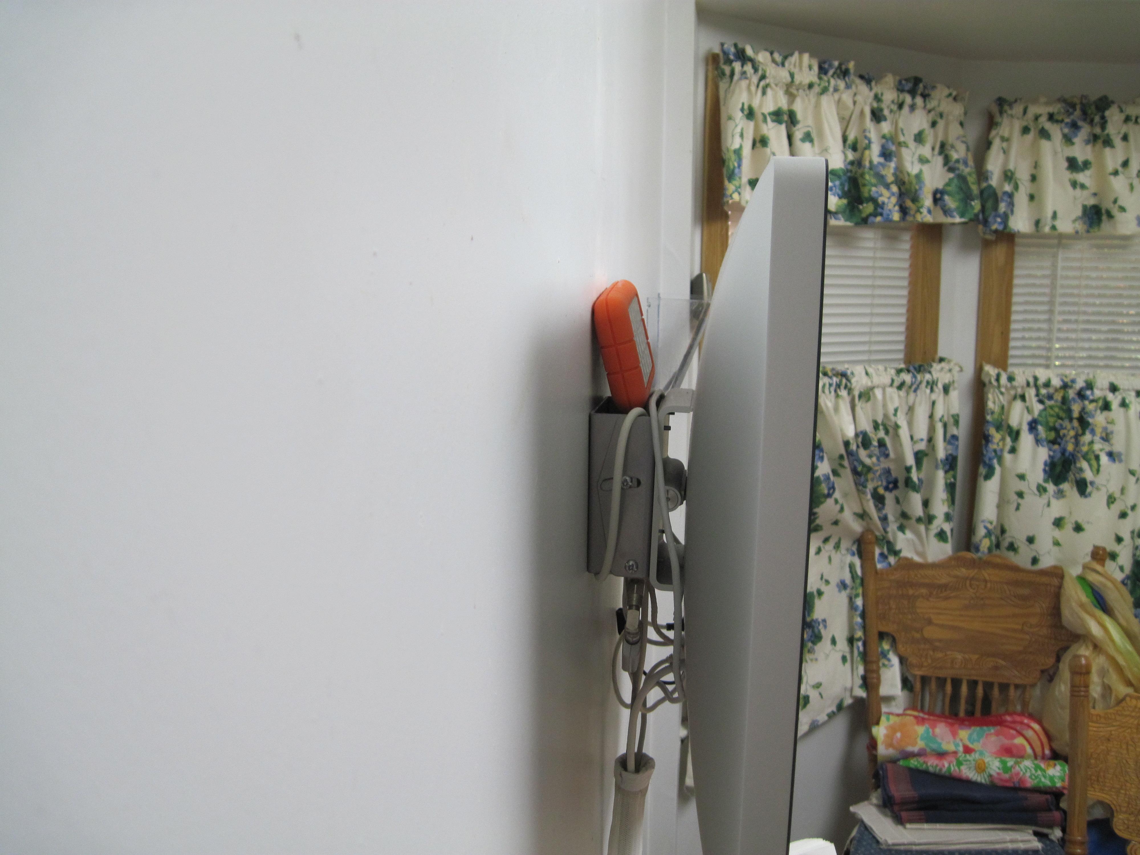

I have been thinking of doing this on my 2010 iMac. So you just select the FW800 SSD as the boot drive and from then on it just boots to that drive by default and otherwise operates normally?
yes here is a fw800 on a wall mount 2009 imac out of site out of mind
