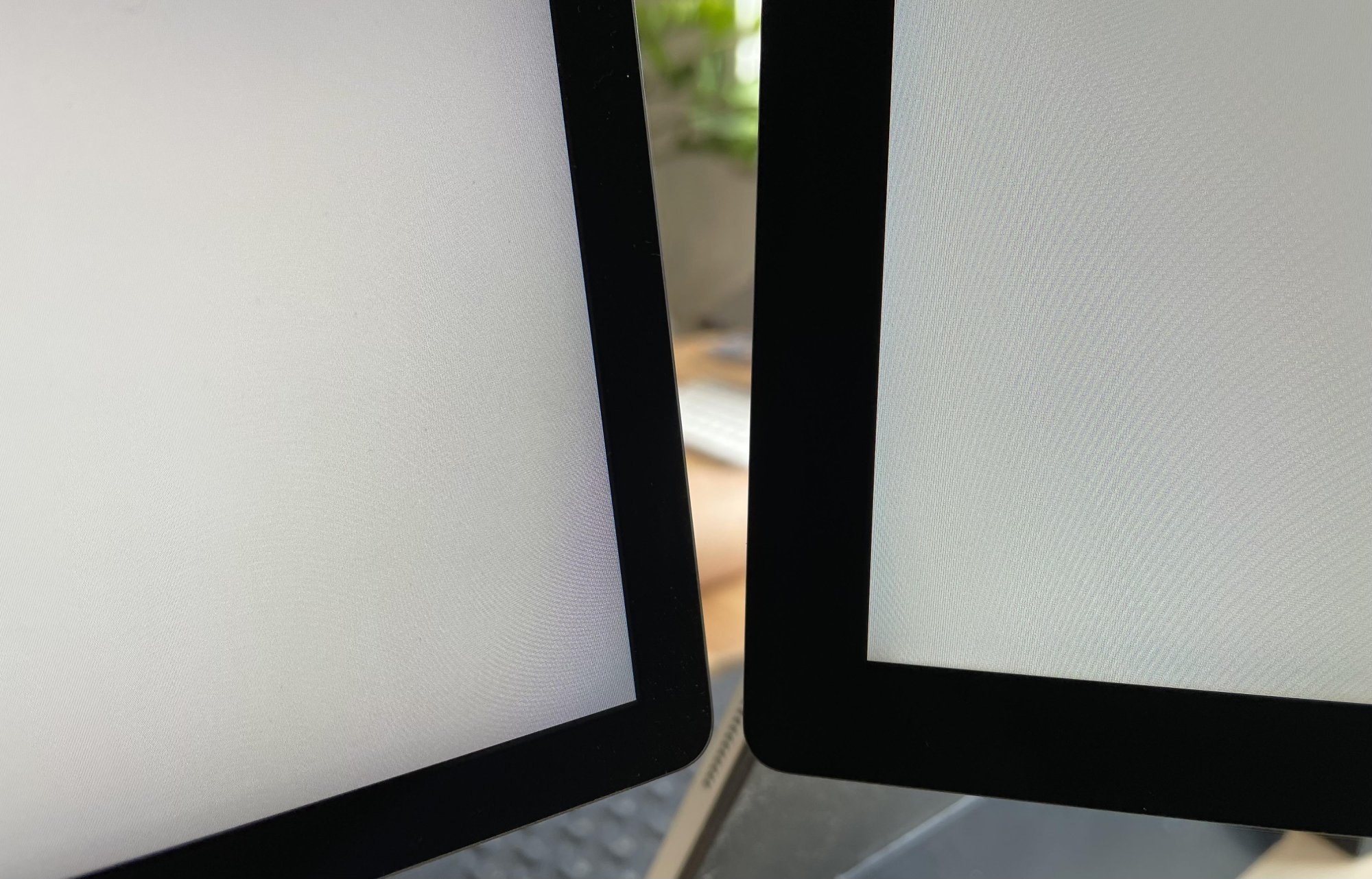

Ok, but would they be able to shrink the bezels down to the same size as on the Pro Display XDR?
Apparently the Pro XDR Display has the same size bezels as the Studio Display if you exclude the width needed for the webcam…
I don’t think Apple will remove the webcam just to allow thinner bezels.
