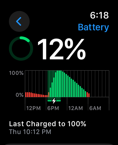

I wanted to share an update with you. I received the AWU2 last week and had no problems with it. I only had to charge it twice until this morning. However, after updating to version 10.1 last night and then checking it this morning, the battery was down to 10%. This seems unusual to me, as you can see in the attached screenshot. I'm not sure what's causing this, so I've decided to install the Public Beta version for now.
You can see it went from 100% around 10 p.m. to 10% around 6 a.m.
  • Wow
