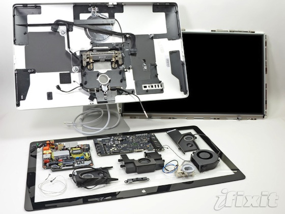

iFixit has managed to get its hands on one of Apple's new Thunderbolt displays, subjecting it to one of the firm's usual thorough teardowns. iFixit was pleasantly surprised at how easy it was to disassemble the new display, and upon opening found a considerable amount of hardware inside to support the display and the docking station functions included in the package.
Both sides of the logic board are packed with enough chips that it's hard to believe there's no computer inside this display. Standouts include:

The display also includes an integrated 49-watt, 2.1-speaker sound system with a small 1-inch subwoofer, as well as a 720p FaceTime camera and integrated microphone.

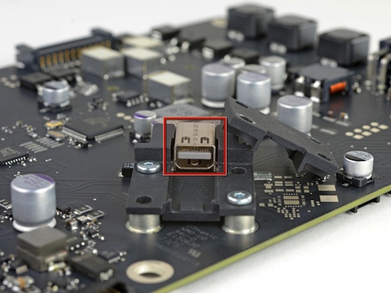

Thunderbolt port on logic board for accepting incoming connection
As for the display itself, iFixit discovered an LG LM270WQ1 panel inside, the same as that used in Apple's Late 2009 27-inch iMac. Interestingly, the Thunderbolt cable carrying signal to the display is connected to an actual Thunderbolt port mounted on the logic board rather than hardwiring the cable directly to the logic board. The Thunderbolt cable is secured to the logic board port with a cover screwed down on top of the connector.
