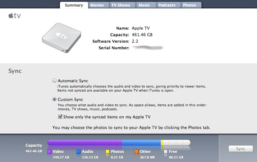

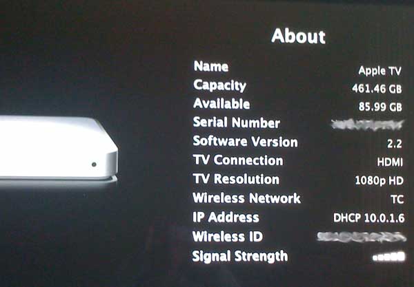

500 SATA GB Drive in apple TV - WORKS!

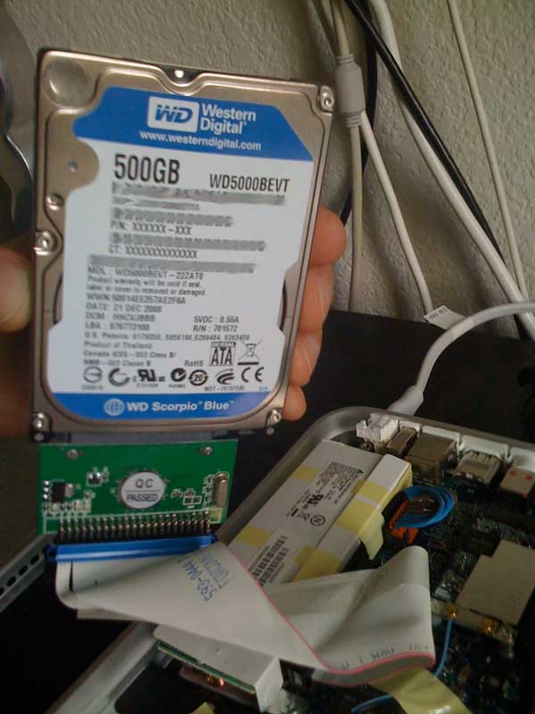

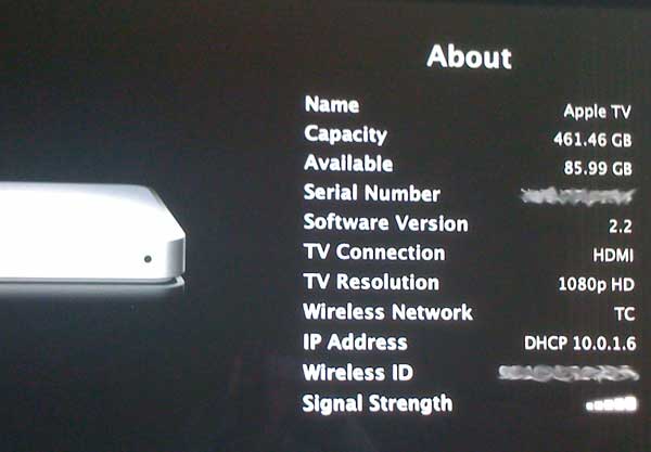

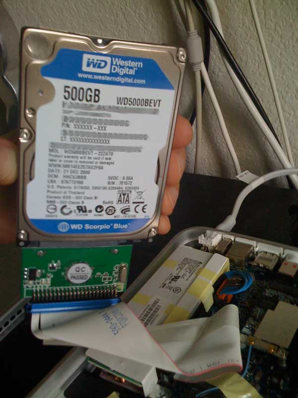

hey guys, just wanted to share some info to upgrade your ATV drive with 500GB SATA drive. it was very painful finding the right IDE to SATA card that will work, i read a lot of posts and none of them had working link to a seller of such bridge, after ordering 4 different cards, some are so nice and small but only one worked.
i used samsung SATA 5400 RPM 500GB drive or you can buy any other sata drive - they are much cheaper than IDEs nowdays. They supposed to release 1TB 2.5" drives soon so i will try that once on market.
Anyway, you will need 500GB drive and small 44PIN IDE to SATA bridge, i tried few and the only one that worked for me i bought here >>>> http://usb.brando.com.hk/2-5-ide-male-to-sata-adapter_p00856c032d015.html

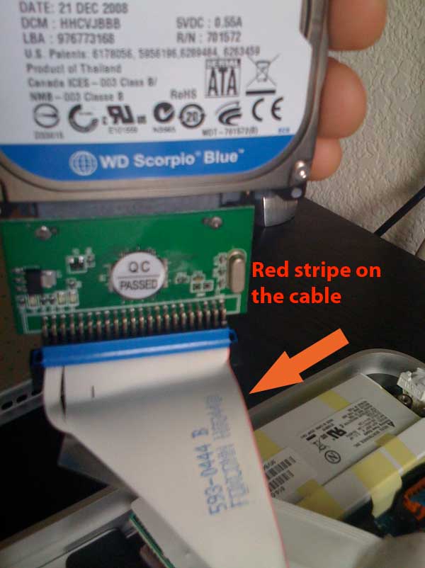

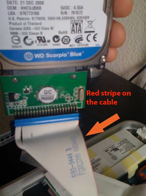

it took about 10 days to arrive but was worth the wait. i plugged it in - MAKE SURE you connect cable correctly!!!!!!! if you don't you will destroy this card, lucky me i bought two of those and of course i killed one but then flipped the cable and everything worked like charm.

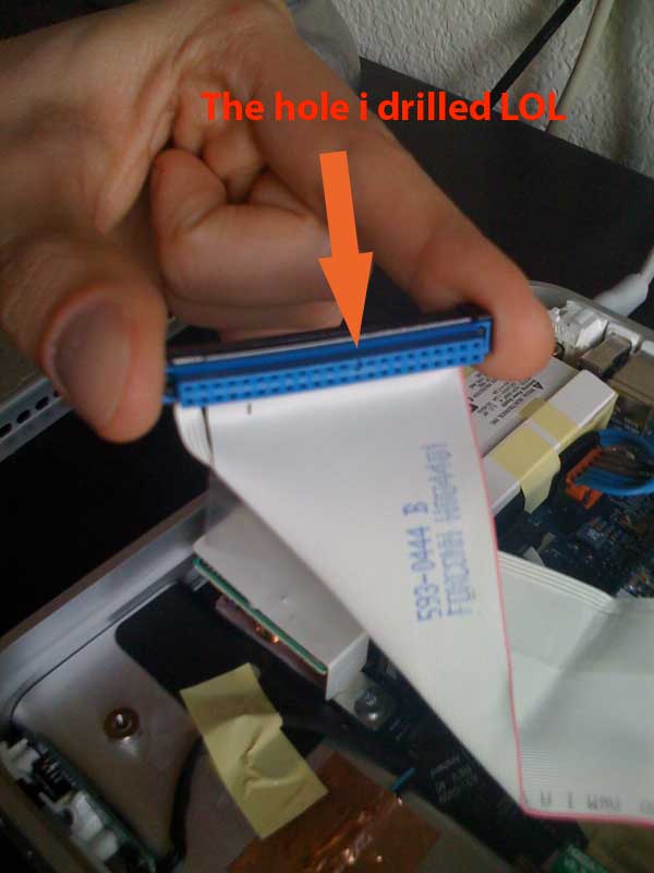

when you insert this card in your 2.5" sata drive, then keep drive label down and your cable should nicely fit in this card. Oh, you will need to make a little hole on the original ATV drive cable since this card has all pins.
anyway, here's what i have >>>

hi denlesko!
that's exactly what i wanted to d but wasn't sure about the adapter!
didy you have to set a particular voltage for the new drive?

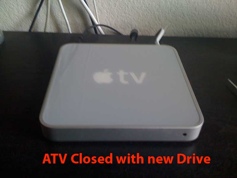

were you able to close the box? why did u have to make a hole in the atv?
Apple TV with 500GB SATA Drive
Hey paolo.sereni,
i didn't make a hole in ATV but rather in the IDE cable - card has all 44 pins while cable is missing one hole in the middle so i just took the smallest drill i could find and made a hole in it so card fits in the cable.

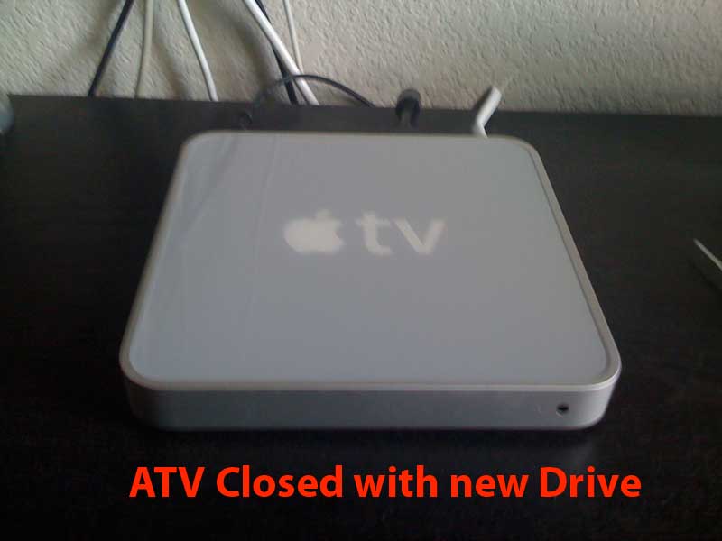

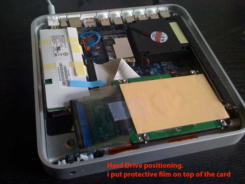

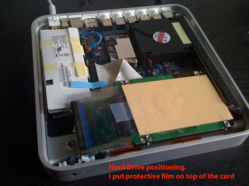

Yes drive fit in ATV but you will need to reorganize cable and drive, with this card you won't be able to screw drive back to where it was originally but there are plenty of space in ATV to fit everything. My box closed very nicely, looks like nothing changed.
one advice, i heard that IDE cables are very weak, so be careful with it. i read a lot of posts where people damaged their cables, if you'll be careful you'd be fine.
i didn't do anything else including voltage mods, etc... i just plugged the card in and it worked.

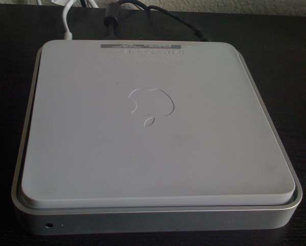

Some more Pictures as requested...
Hey guys here are some more pictures in case you'll find them handy, please see the notes on them.
thanks!
