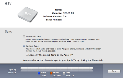

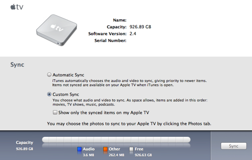

Dynaflash (and everyone else who worked on this) rocks! I used the newly updated AtvCloner on my WD 1TB Green Caviar sata and everything is working well. Hopefully I won't fill up this drive anytime soon. Thanks again!
