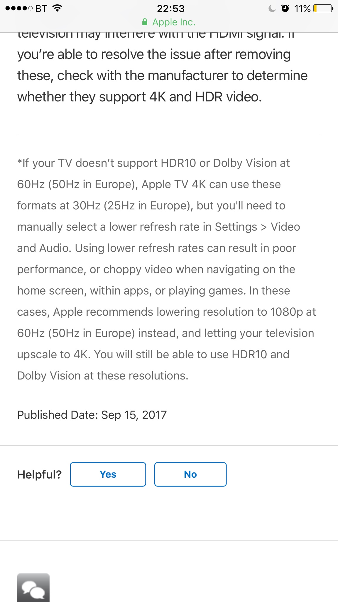

What's worse, Apple is converting 24hz to 60hz first, then sending to tv, forcing the tv then to backpedal and reduce to 30hz for DV. So 24hz-->60hz-->30hz. What a mess.
Ironically they’ll only play hdr versions of these films reasonably on the most expensive of 4k sets. On many others they’ll be streaming at 30fps because many TVs can’t manage to display HDR or Dolby Vision at 60fps. And that’s going to look pretty awful.

I was looking forward to getting this new AppleTV and being able to watch some of my movies in 4K but then see that my Panasonic TV that we've only had just over a year now might have issues as it's just a regular 4K panel, I don't even recall there being any HDR or Dolby Vision sets available at that time (if there was then they certainly weren't in our budget range)
Going by what Apple have put online I may have to set the ATV at 1080p then let the TV upscale to 4K which I'm not seeing much incentive to upgrade from my ATV4 as it's doing that already.
I fall into this category.
If you don't have an HDR set, then you're not effected by this.
So are you saying it still play movies fine in 4K just won't see the HDR side of things, if it will then happy days.
I just got a tad confused with what they'd put.
Right, the TVs that specifically can't do DV at 60 Hz is what the issue is. As long as your TV accepts a 4K 60 Hz signal, you'll be fine.
