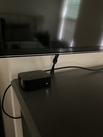

tv does not detect the signal , I’m in the right hdmi input, just is not showing anything .... Apple TV is on. i use a monitor to check the same , and monitor says : input signal not found. It seems the ATV is not sending signal.

Probably stupid, but did you try one of the other HDMI inputs on the TV? Or another TV as well. Even most small sets have a HDMI input option.

yes, I tried different HDMIs inputs,cables and also different TVs . I cleanEd the ports too.
