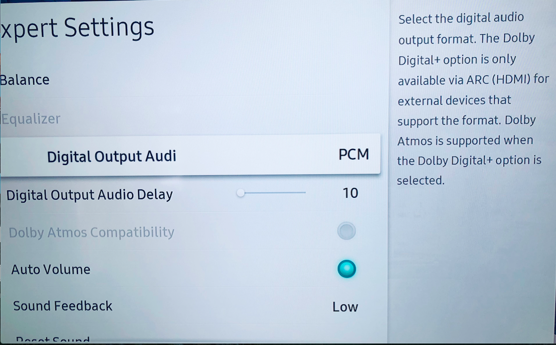

Having the same ATV4K buffering/pausing issue watching files from my itunes on 4K Samsung Frame tv. Also I find the the ATV4K menu more sluggish. Some files stream fine but some are not, especially after pausing - as I have to back out and resume. Some resume some do not.
To dissect the issue further
I have one ATV4K connected to the Samsung w/update 14.3
and one ATV4K connected to a Sony 4K display w/latest update 14.4
This issue is only happening on the 2019 Samsung 4K display (the Sony is fine)
I have switched out both ATV4K's with different updates with the Samsung and it has the issue with either update.
So is this a Samsung display issue? I am connected directly to the TV from ATV via HDMI.
Tried to find the "disable" Change Format as mentioned above on the TV settings but doesn't have the option.
My audio settings on the Samsung Frame are limited it seems and because I do not have a sound bar or receiver hookup I have selected PCM as an audio output option.
Just figured I would document my experience for those with same issue. Hoping a fix is coming soon as the Samsung Frame is our main display for our home.
The Change Format is only available in the tvOS audio Settings app (Video and Audio/Audio Format). Not sure if disabling Change Format or forcing stereo will help with this particular issue, but it's worth a shot...
Thanks so much for the quick info Jeff P!
Here is all I have on my Samsung Frame 4K TV for audio option settings or whatever. No "Change Format" option. I am connected directly to the TV from the ATV. So no Soundbar or receiver involved. I have never had an issue in over a year since purchase of TV and ATV until these latest 14.3 & 14.4 updates. The TV has never needed an update after set-up during this time either.
Here is a pic of TVos Sound Expert Settings screen:
