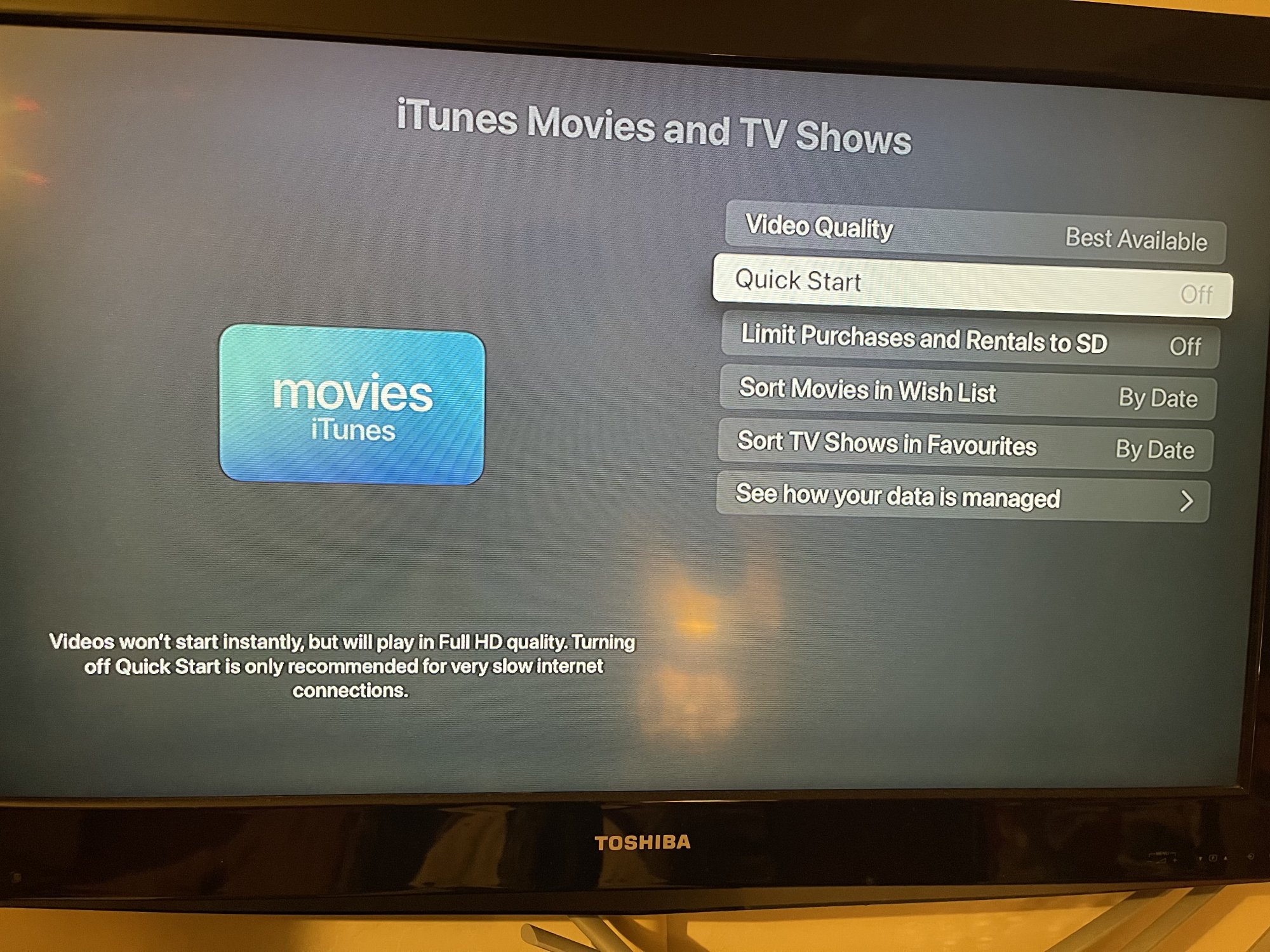

What you could try is open Settings then go to Apps, select iTunes Movies and TV Shows and turn off Quick Start.

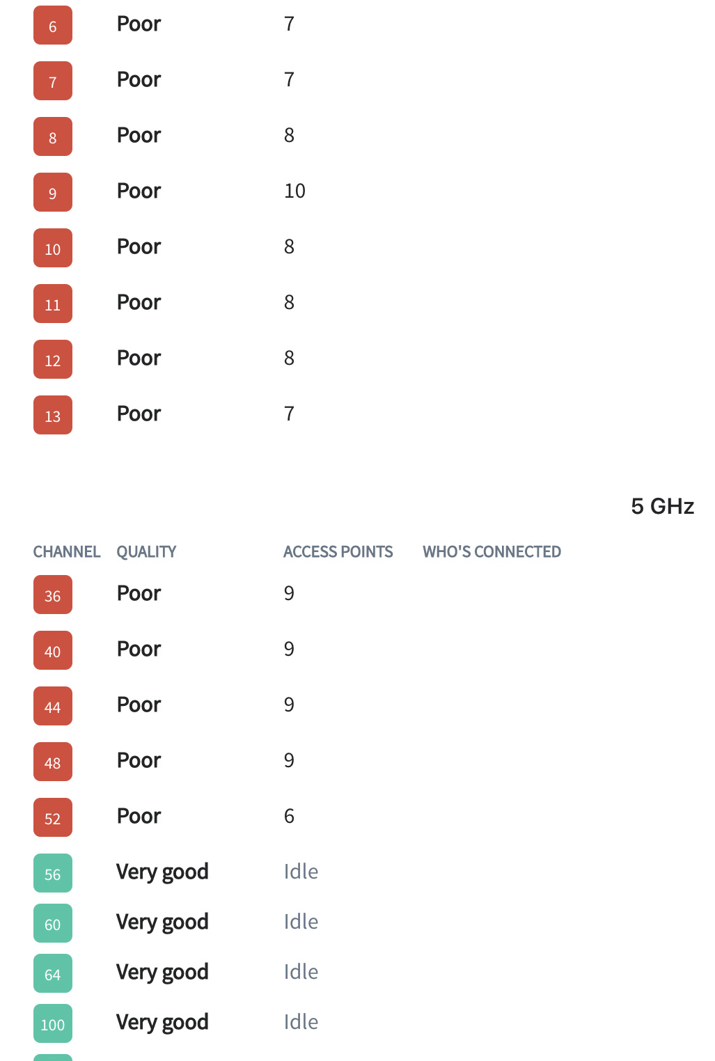

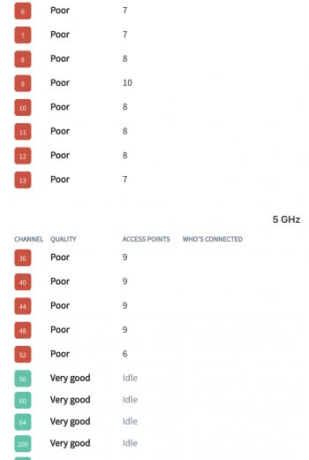

1. How many WiFi networks are active in your vicinity?
2. Are you connected to a 2.5 or 5.0 GHz network?
3. What channels are you using?
I have some 52 networks active in my vicinity. All of the 2.5 channels have poor quality due to network saturation, up to 10 networks sharing the same channel. However there are some 5.0 channels which offer good connectivity:
Currently I am connected to the 5.0 GHz channel one, and I am the only one on that channel.

Have you done any Wifi debugging?
Yes; I have several good WiFi monitor apps on my MacBook Air
Two others beside mine; both are neighbours and they are operating on different frequencies to my channels.
Both at different times but primarily on 5GHz as the Apple TV is some distance from my modem/router
Both networks were connected to "Auto". But on the advice of my ISP the 5GHz network has been left on "Auto" and I have experimented with channels 1, 3, 6 and 11.

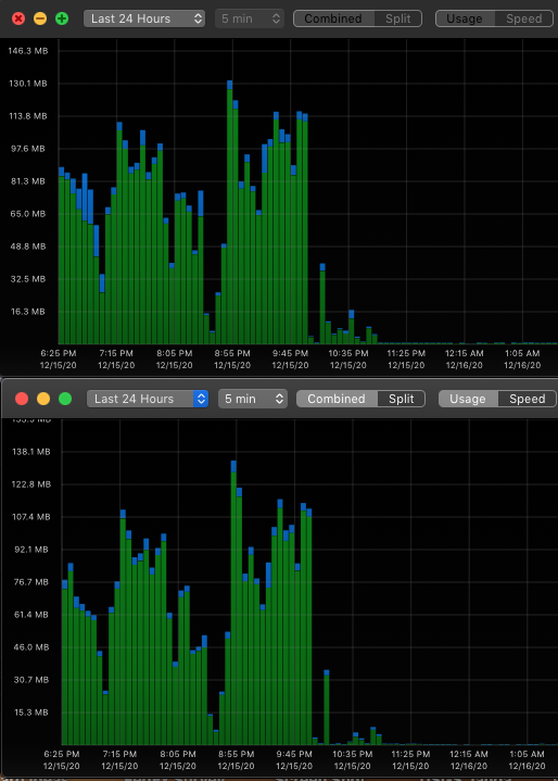

It would be interesting to compare graphs of your download and upload traffic —
1 - when you are streaming and your Apple TV acts up and
2 - when you stream the same content with your iPad with no problems.
FWIW I use PeakHour 4 (SNMP) to monitor the traffic on our old school LAN with an Airport Extreme as our main router and an Airport Express which extends our LAN (via ethernet) to our media room with the Apple TV.
This is a clip of the traffic while we were streaming video on a recent evening. The top graph is the Airport Extreme and the bottom one is the Airport Express. Both are set to graph the usage in 5 minute intervals.
BTW despite the warnings from Netflix etc about the minimum bandwidth, we successfully stream 1080p Netflix, Amazon Prime, etc. with our Apple TV v4 with only a 4Mb/sec (yes bits) download internet connection. We only see poor picture quality and “buffering” when the download slows to more like 2Mb/sec. When that happens we pause the stream and allow the Apple TV to "buffer up". We can see this happen in real time with PeakHour 4's other graphs with 1 sec updates.

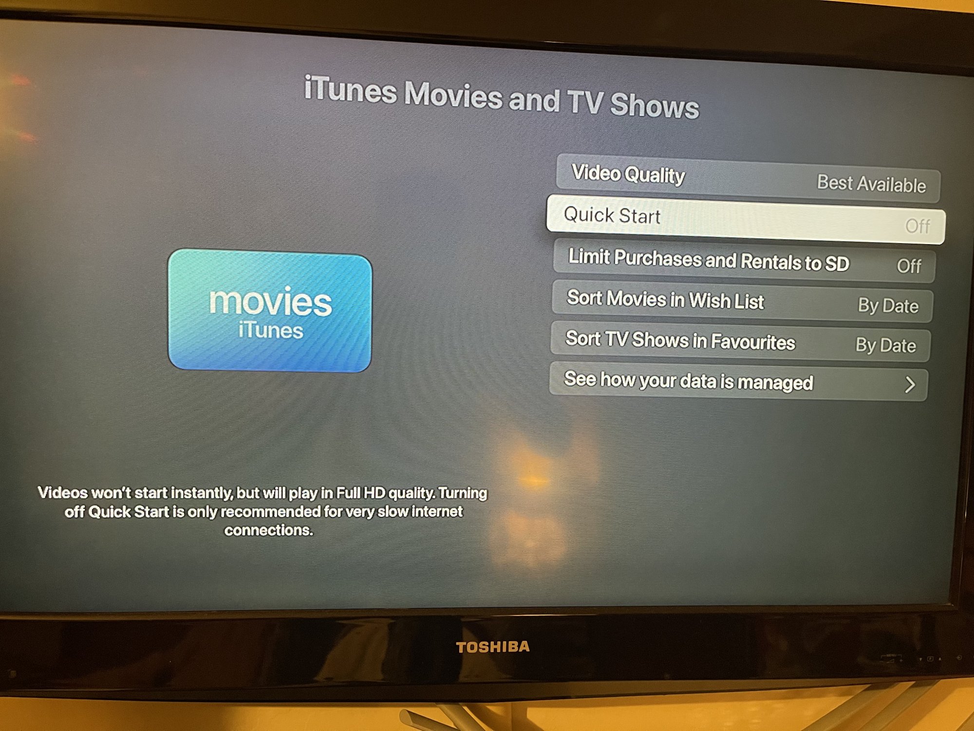

Have you tried disabling Quick Start as I mentioned before?
With Quick Start enabled it streams on the fly which can become problematic if there’s a dip in your bandwidth during playback.
Turning off Quick Start downloads enough beforehand into a buffer before it starts playing so as to prevent any issues during playback.
