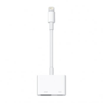

I think the best way of streaming video is to connect your iPad or iPhone directly to your TV via HDMI and Apple's Lightning Digital AV Adapter (see attached). This method provides higher and more reliable WiFi speeds with the drawback of no remote control.
