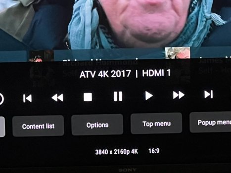

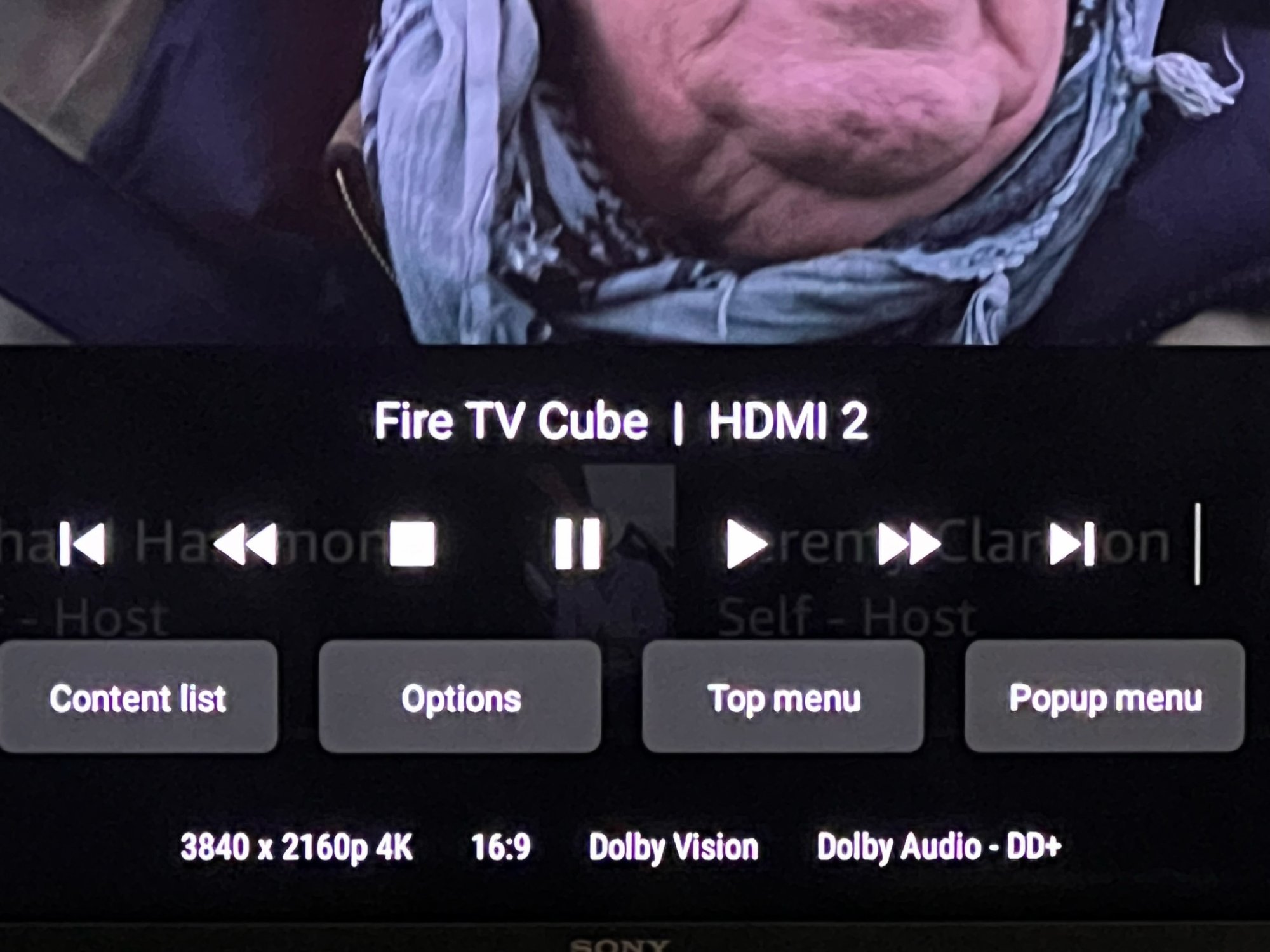

No HDR while viewing Grand Tour on the ATV 4K 1st gen, but has HDR on Fire TV Cube 3rd gen. See attached images. I’m using both streaming boxes on my Sony Bravia 4K HDR TV.
