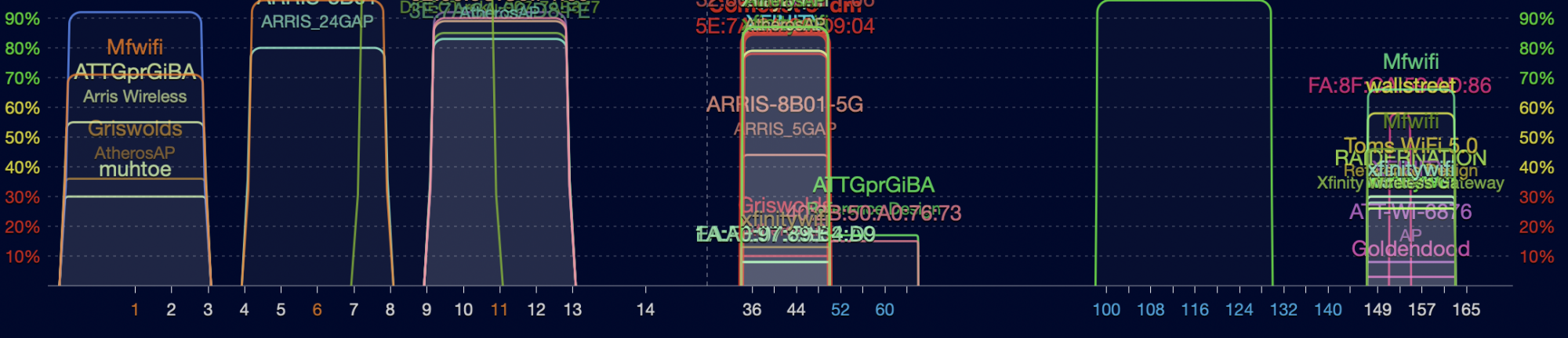

You can also make changes at the router end. My 5G access point was glopped together with 19 other routers at at ~149-165. I changed the router configuration so now I am the only one in the 100-132 range.
