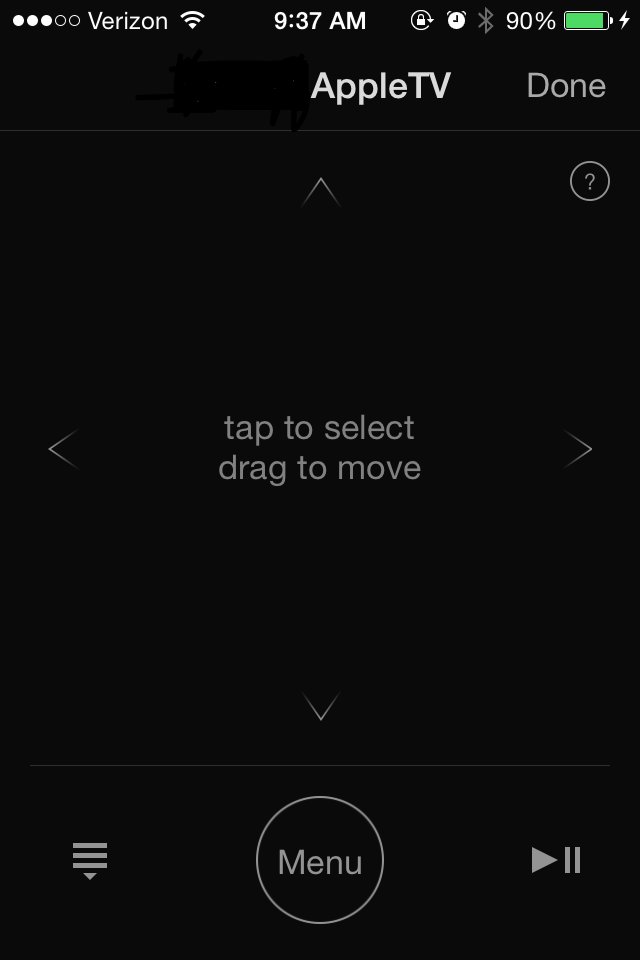

The Remote App is capable of what you are looking to do.
When you start the remote app you should be presented with a screen that list your AppleTV. It sounds like you are getting that.
After you click on it what screen do you see? It should be something like this (I removed my AppleTVs name thats why AppleTV is off center).
From there you just slide your finger around to select things like the ATV remote would. Its nice because a keyboard will come up in search fields making it tremendously easier to type.
If you are getting a list of your media while connected to the AppleTV the center option on the bottom should be labeled "control" which will get you back to the screen I linked in the pic.

Ok, got it. Thanks! 🙂🙂
On the top right a small icon with 4 arrows pointed in different directions. If I touch that, I get a black screen, don't see the little arrows on the outside edges, but there is a menu button on the bottom, and swiping on this screen controls the interface on my TV.. To the left of the menu button is a selection icon with a series of parallel horizontal lines. Touching it does nothing and I don't see an icon like this on the physical Apple TV remote. Any ideas? Thanks! 🙂
