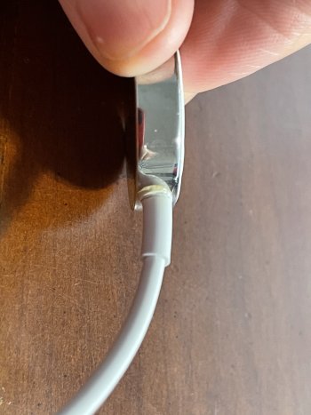

Last night I woke up to my wife letting out a quick scream at 3am. Apparently, she had woken up and wanted to pick up her apple watch to check the time. The OEM Apple charger had gotten so hot that it burned her finger pretty badly (blister already beginning to form) that she dropped the watch/charger right back onto the nightstand in pain. We unplugged everything and went back to sleep.
We woke up this morning to her Apple Watch Series 4 not powering on, and upon inspection I realized that her OEM charger puck had gotten so hot that the plastic melted and started to peel away exposing the charging coils beneath! Unfortunately she doesn't have apple care on the watch. I've never heard of this happening before. Is there any recourse through apple to at least get the device / charger repaired or replaced?

Externally the watch looks pristine. Not sure if I want to try plugging it in on my other apple watch charger till I hear from apple. The fault could be on the watch-side in the charge controller for all I know. They said they'd call me back tonight so I'll see what the support folks tell me to do.

Is the cable free of any cuts, nicks, kinks, etc? Anywhere that something might have cut or dug into the cable’s insulation?
Not from what I can tell by amateur inspection. Except for the melty bit where the cable enters the charger housing, the rest of the cable looks pristine to my untrained eye.
