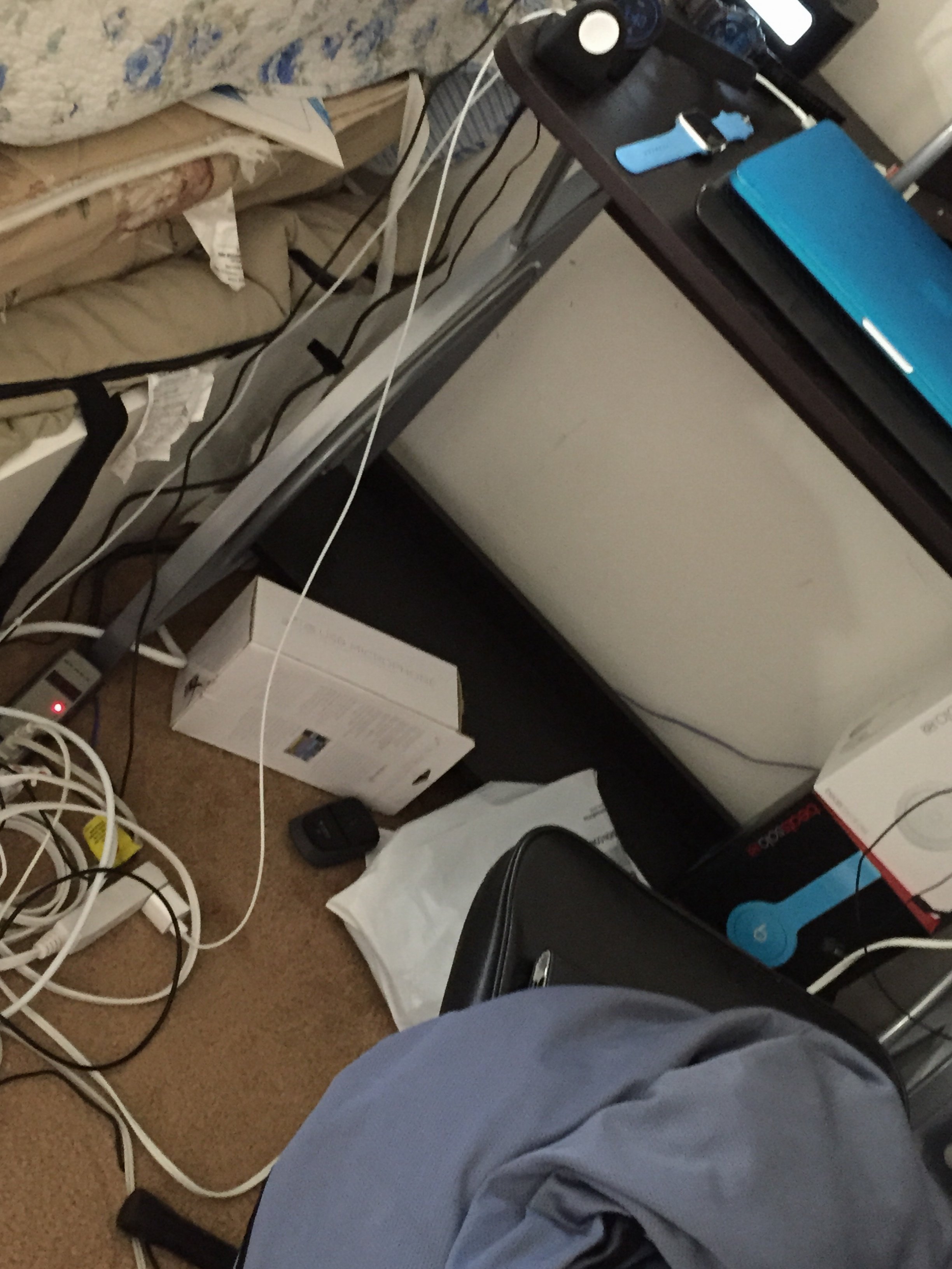

There a photo where I have my apple watch charging

If you keep encountering charging problems with your iDevices/macbooks and it requires a specific solution to make a particular device charge optimally, the house is likely the underlying problem.

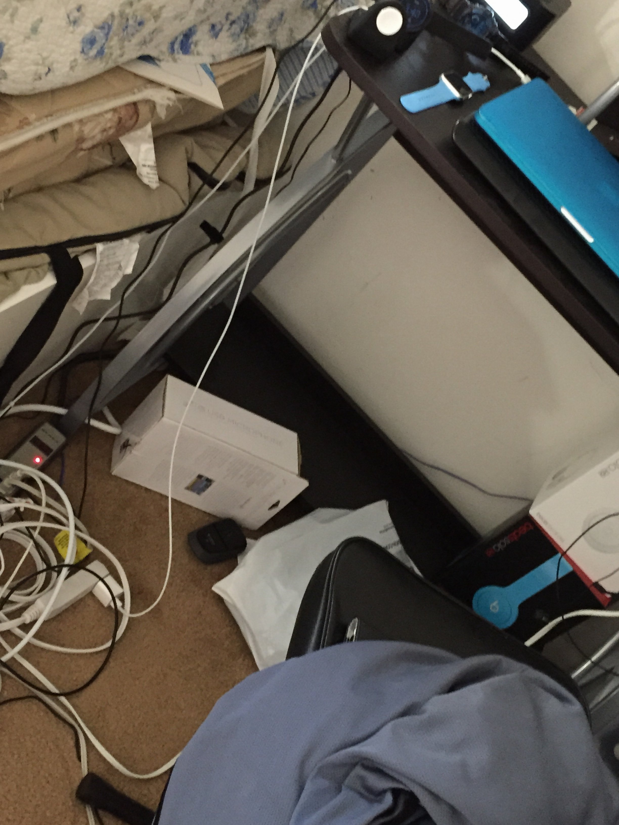

You've plugged directly into the outlet to rule out defective or overloaded extension cord/power surge protector, right?
Best thing OP can do is unplug everything in his/her bedroom (shouldn't take more than a couple of hours), lose the extension leads, and try plugging the Watch charger directly into a socket.
Yep, call the landlord and see if they can inspect it. You can also go to Home Depot and get outlet testers. You basically plug it in and it tells you a bunch of stuff on an LCD screen which you can google and see if it's right. Obviously don't do something you're not comfortable with but that would be my next step if the landlord refuses to check it.
I would also say test it on a few different occasions, so you can see how the readings change (if they do at all), as the issue may be intermittent.
To eliminate the chance the issue is between the outlet and the charge, just unplug everything else for a day and see if it works normally. It could be that because there's so much stuff hooked up its overloading the outlet.
