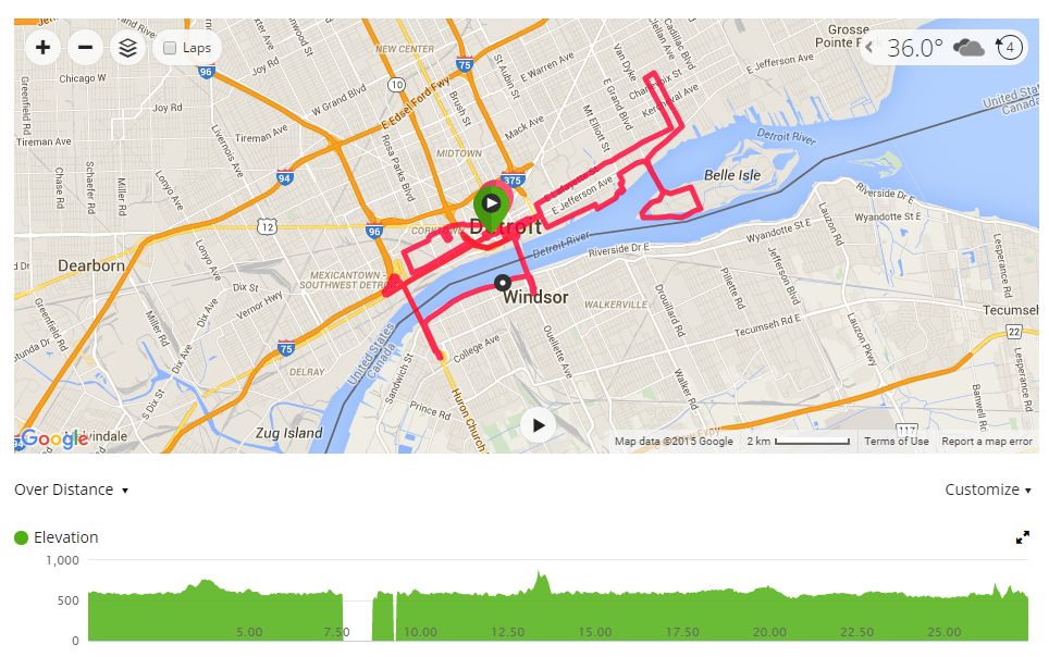

Today I ran the Detroit international marathon which starts in Detroit, goes across the bridge to Canada then through the tunnel back to the USA then is basically flat for the next 18 miles. I started workout on my Apple watch and started my Garmin. I didn't bother with Runmeter because it was just above freezing and I'd had enough of digging my phone out in the cold to operate it with freezing fingers.
The results were not good. My Apple Watch ran out of charge. I ran 4:04 in the marathon and the Apple watch ran out of charge after a mere 4 hours leaving the workout app running. This is the same Apple watch that has been giving me 12-16 hours a day. So I didn't get to compare workout's splits to Garmin's splits.
Garmin wasn't flawless either. While the times in memory later proved to be accurate, the screen kept reporting I was running 9:20's when I was really running 8:20's so I ran too hard and tuckered out around mile 23. I mixed walking with jogging to finish the last 5K but I crossed the finish looking more or less like a runner. Perhaps it was the mile through the tunnel with no GPS and no cellular (for my iPhone to figure out where I was and tell my watch) that blew my Apple watch's mind so badly it discharged itself in a mere 4 hours. Perhaps the tunnel also caused my Garmin to report inaccurate pace on its screen.

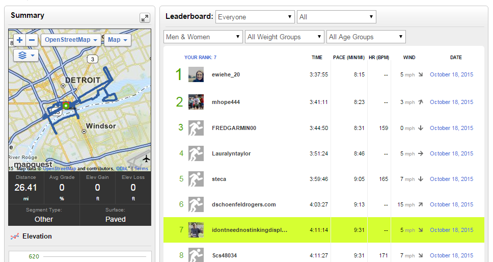

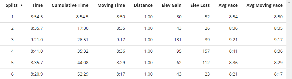

I'm pasting in the first few miles of splits which includes running over the bridge to Canada...
Lastly, here is the leaderboard for people wearing their Garmins for the race. My time is inflated because I forgot to stop my watch at the end and I had to turn off stop detection for the watch to work in the tunnel...
IMHO a screenshot of split times (or no data at all!) from the workout page of the Activity app is useless in comparison to this level of data from a race. And another thing. I wiped my iPhone in an attempt to solve a nagging bluetooth problem so even my steps data is gone! Nobody owns my data but me. I ran this marathon, not some engineer in Cupertino and my data should have been presented to me in the format of my choosing and at the time of my choosing (like before I wiped my iPhone). Apple needs to up their game if they don't want professional or even recreational runners (like me) leaving our Apple Watches on our nightstands on race day.
