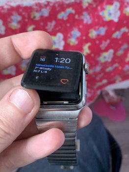

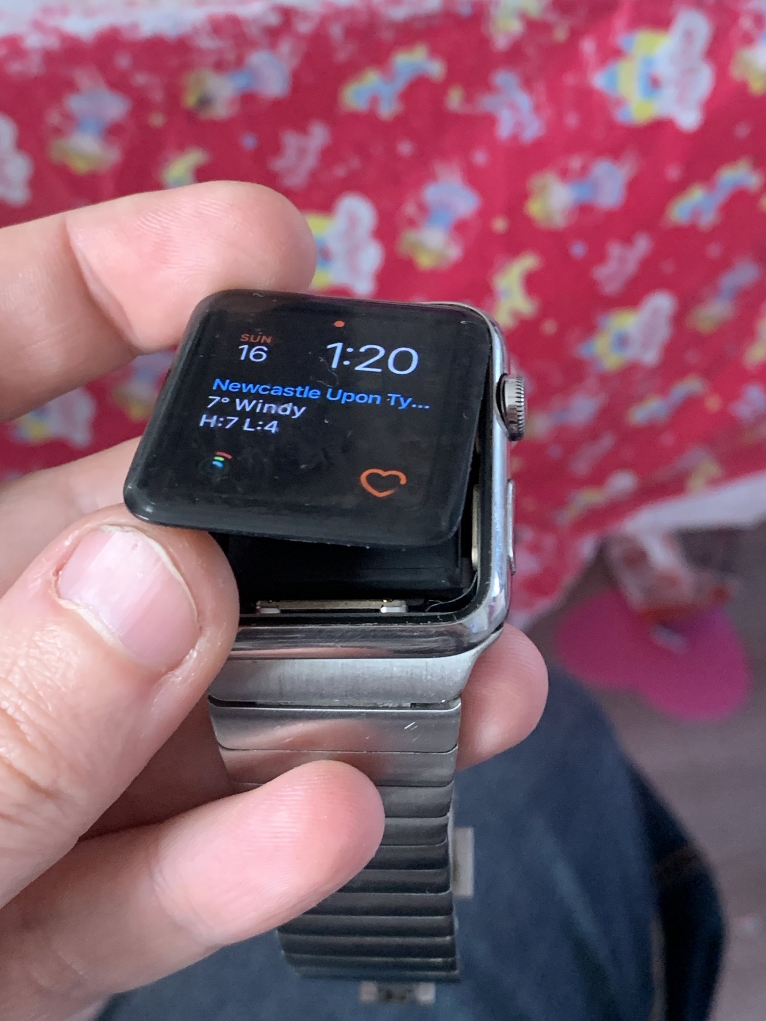

This happened to my series 0 42mm SS at the weekend too. It’s with Apple now who have emailed to say they are replacing my watch. I don’t know yet if this is like for like or if I’ll be lucky and get a newer series. Fingers crossed for the upgrade!
edit, store manager discounted the out of warrant battery replacement cost from £89 to £50.
edit, store manager dis punted the out of warrant battery replacement cost from £89 to £50.
Apple treats every situation variably. You probably won’t receive a first GEN watch back in return, It likely will be a Series 2 Apple Watch, being that you have a stainless Apple Watch as it is.
