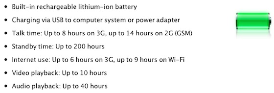

Since the release of the iPhone 4S, some users have been complaining about poor battery life. Even with Apple having quietly reduced the standby battery life from 300 hours on the iPhone 4 to 200 hours on the iPhone 4S, active-use battery life for the iPhone 4S was supposed to remain the same or better than on the iPhone 4. But some users are indeed seeing rapid battery drains, both while in active use and in standby, suggesting that some sort of background task is sapping the device's battery under certain circumstances, according to The Guardian.

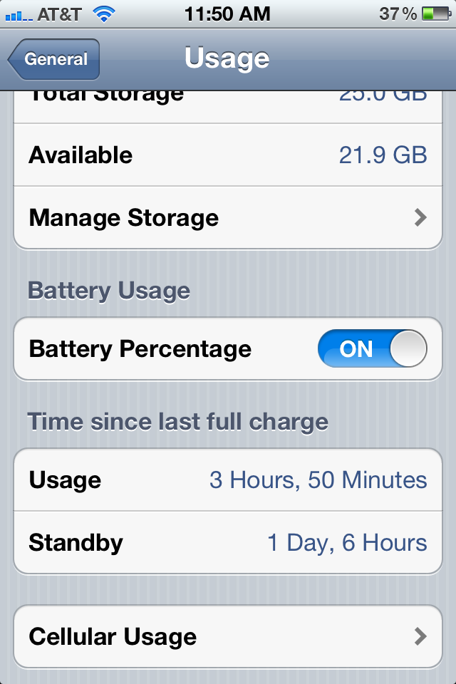

I've had days where I've been at 30% battery with the phone on standy after a few hours, as has my wife. In general, though, its not bad.
My phone has currently been off the charger for 7 hours, was used to play 30 minutes of music this morning, and has otherwise primarily been in standby, and is at 70%.
