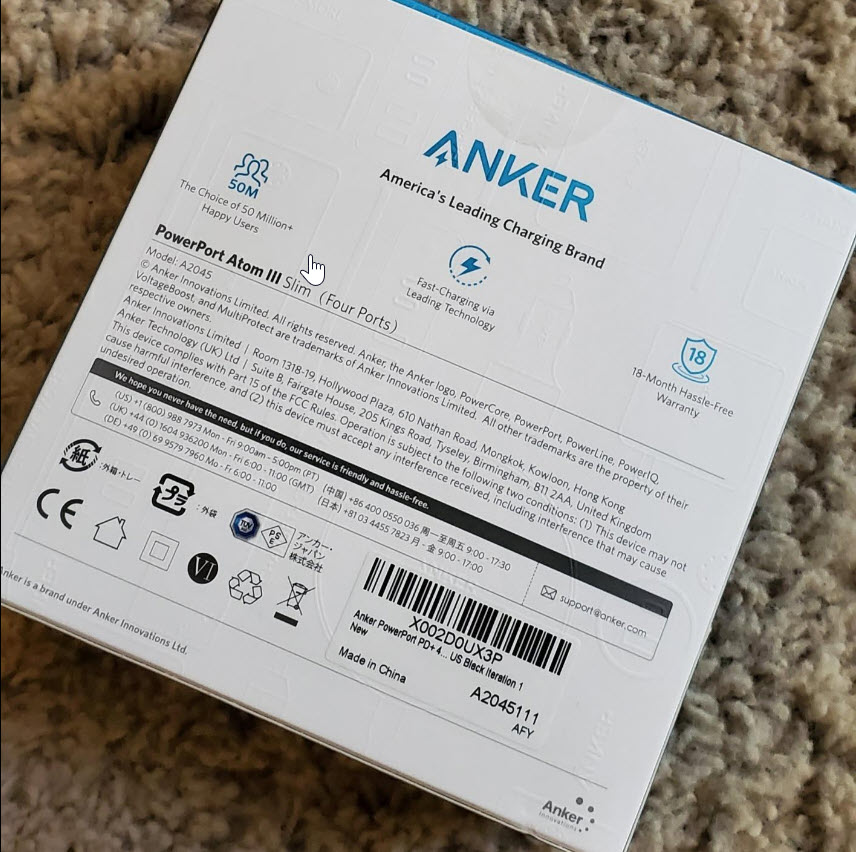

Anker is a good company— that doesn’t surprise me.
They are a good company, but not all their chargers are UL Listed apparently. I randomly picked one off Amazon and the box does not show UL Listed anywhere. I would expect to see the UL symbol if it was UL Listed.

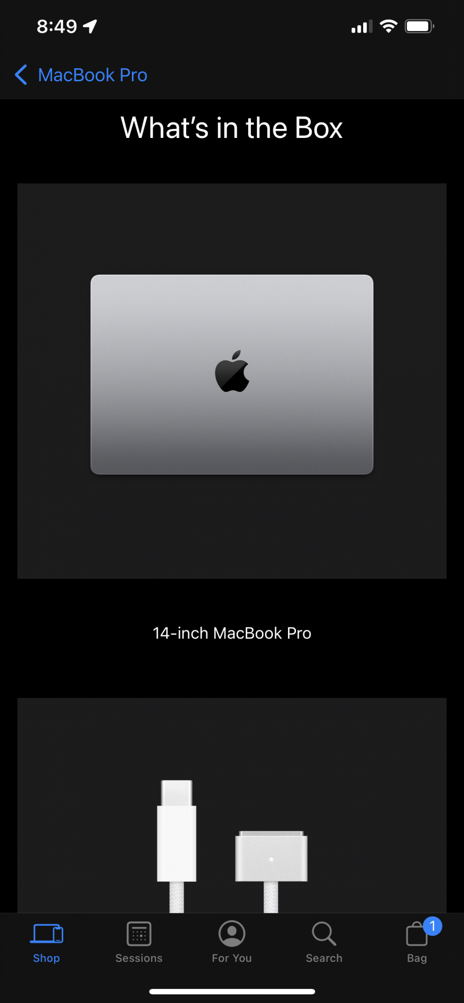

MacBooks come with the cable when you buy them. Apple power adapters (even for their smaller devices don’t come with the power cables.
