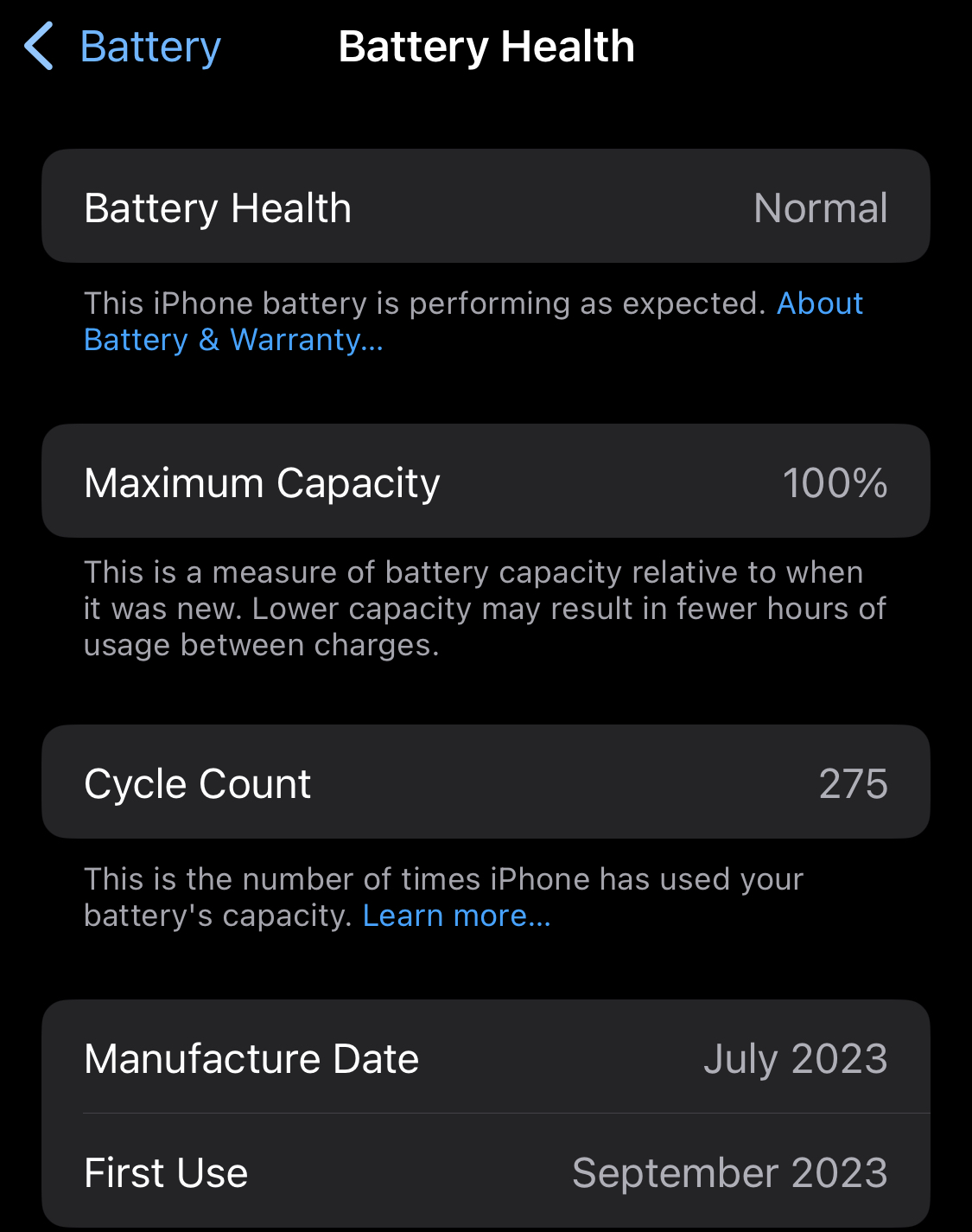

I believe it helps. On my iPhone 15 Pro Max, with a cycle count of 275, I'm still at 100%. More than 95% of my charging is done via Magsafe or Qi wireless charging, charging overnight every night on the Magsafe charger. An 80% charge is enough for my all day use at least 90% of the time and of the other 10%, some sort of charging capability is readily available. The only time I've had real issues is when using an app that didn't turn off location services as it should have.

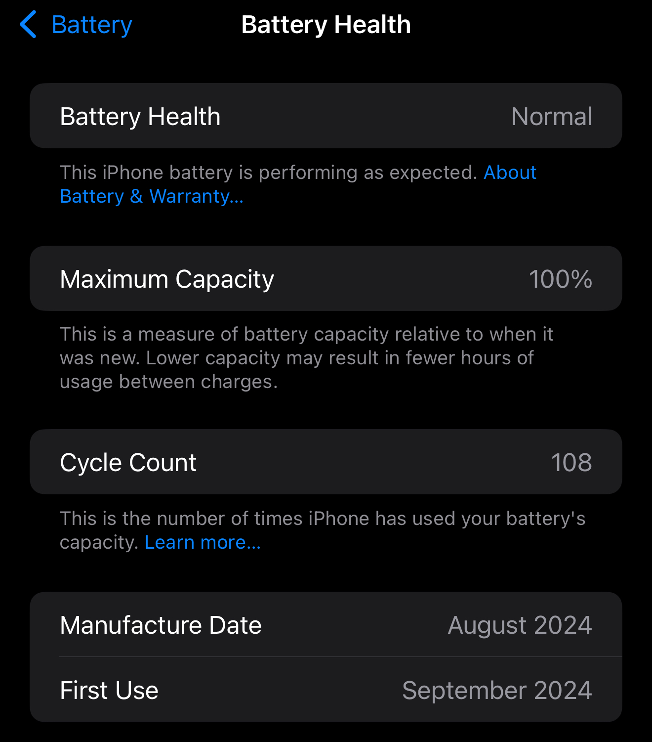

My launch day 16 PM is still at 100% health with 108 cycles so far, I always charge to 100% capacity even overnight, and it's only ever been charged wirelessly using the newer faster charging MagSafe.
Optimised battery charging is turned off as always as I hate this feature, if I charge my phone I want a full charge every time.
