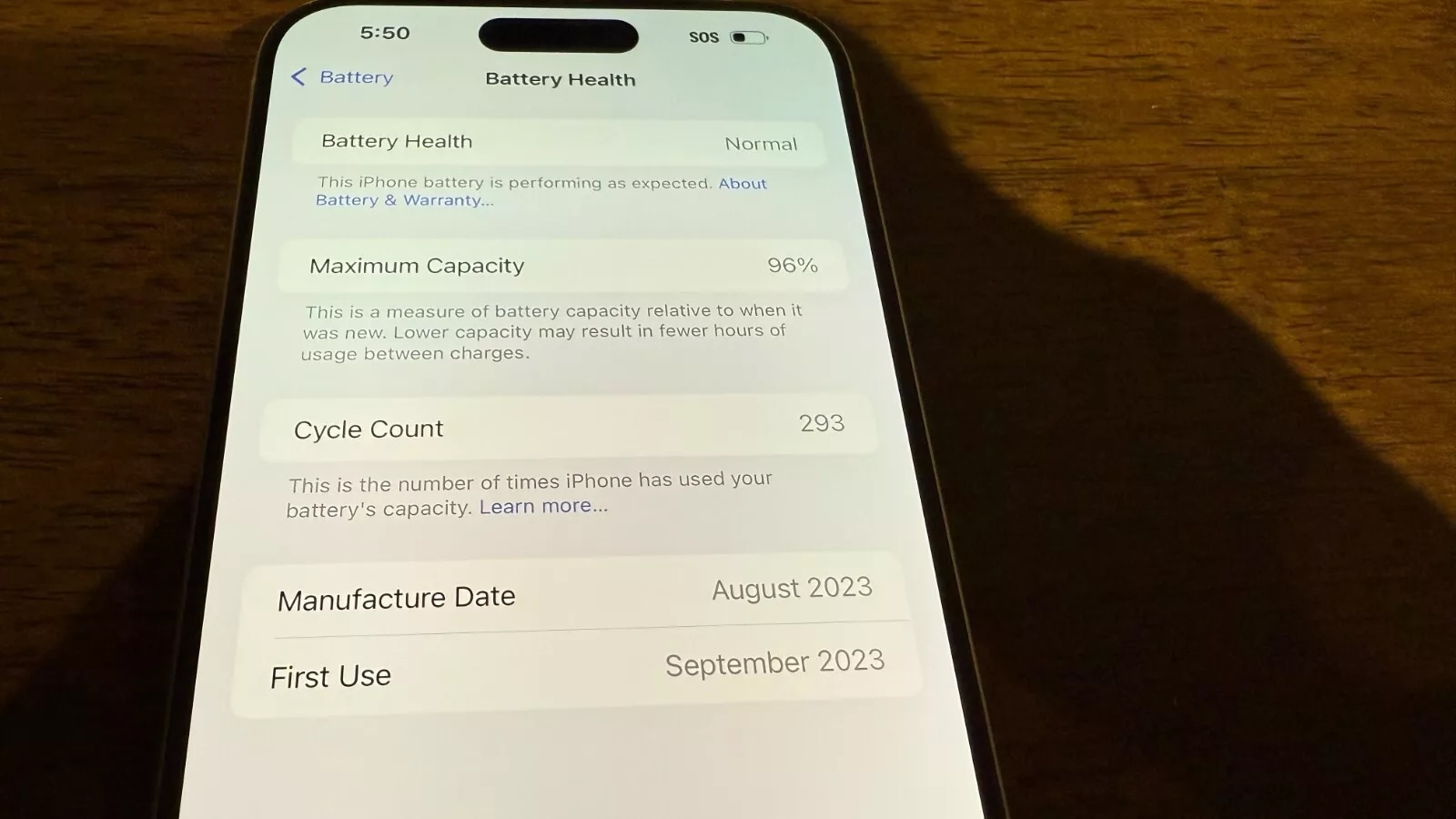

100% capacity, 75 cycles, 80% limit since day 1, Early october 2023 first use.
I'm not a social media addict and I get thru the day with plenty to spare.
I've been manually using an 80-82% 'limit' on my 13 mini by just making sure to always unplug it when I get the Shortcuts alert that it hit 80%. Had the phone for about 2.5 years and the battery's never been below a 25% charge.
According to coconutBattery, it's got 323 cycles and 97.6% capacity (97% reported by Settings.app). I'm satisfied.
I set the charge limit to 100% on day 1. I have had it since launch day - 140 cycles, still at 100% capacity.

i used the 80% charge limit on my 15 Pro Max since new except for 20 to 25 days while away from home. Almost all MagSafe charging - I rarely plugged it in.
97% health after 277 cycles
15 pro, 6 months @ 80% = 100% battery health, 173 cycles. I’ll probably change it to 90% when I update to iOS 18 or just turn it off completely. I do need to charge during the day while at work but it’s not a problem as I have a plenty of options to do so. Mostly tried it out of curiosity.

My iPhone 15 Pro with 345 cycles has 100% health and always charged to 100%. I even used MagSafe as my sole charging method. Couldn’t put a dent in that health.

Bought on launch date, enabled 80% limit on day 1. I never let it go pass 80% and I often unplug just before it got to 80%. Always use fast wired charger (45W or more, but this iPhone can only do 30W AFAIK). I never used wireless charging.
Still at 99% after 250 cycles.

15 Pro
91%
471 cycle count
during the da often have connected to usb-c at night it's been on a wireless charger with the clock radio thing on screen
I got my iPhone 15 Pro Max on day 1, and has set the charging limit to 80% for typical use and to 100% when I am traveling or out on the weekends. I have used MagSafe charging about 80% of the time, and USB-C about 20% of the time.
After 306 cycles, its maximum capacity is 98%. I am very impressed.
