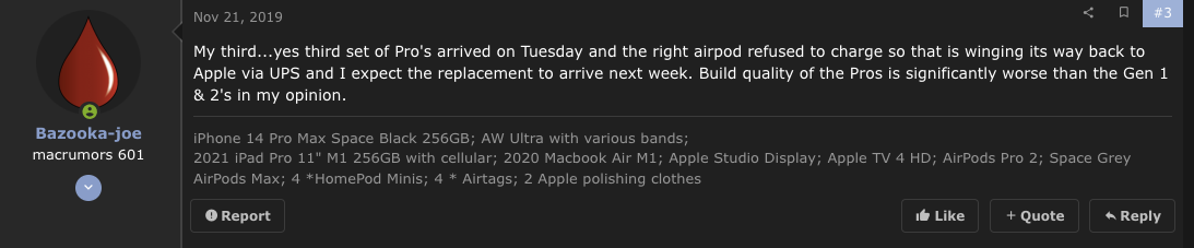

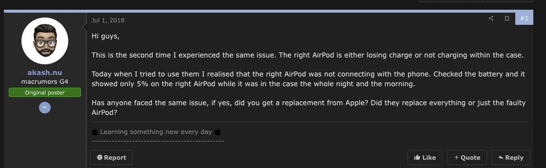

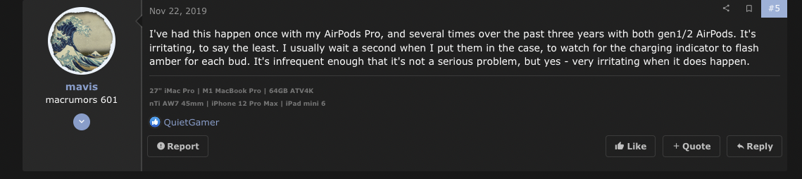

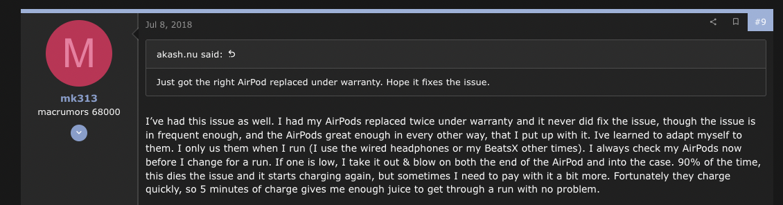

Wrong! Eight reports in this thread, and here's a bunch more with just a quick two seconds search. Many users reporting multiple issues with multiple pairs, as I have (and others have in this thread).
