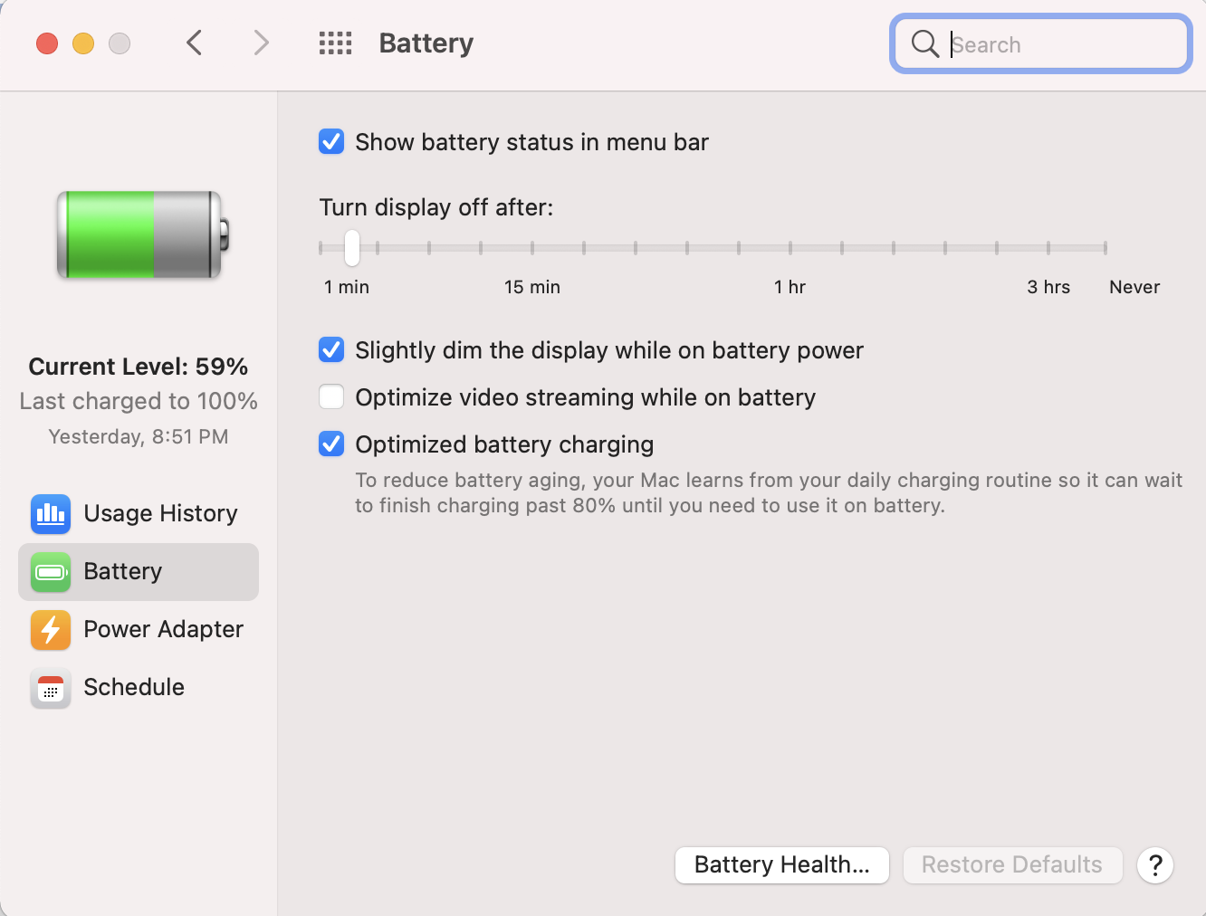

As another user shared, the option to turn it off is there under "Battery" for M1 Macbook's.
Reactions: George Dawes

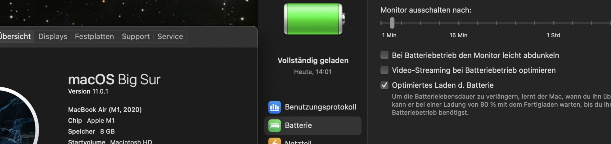

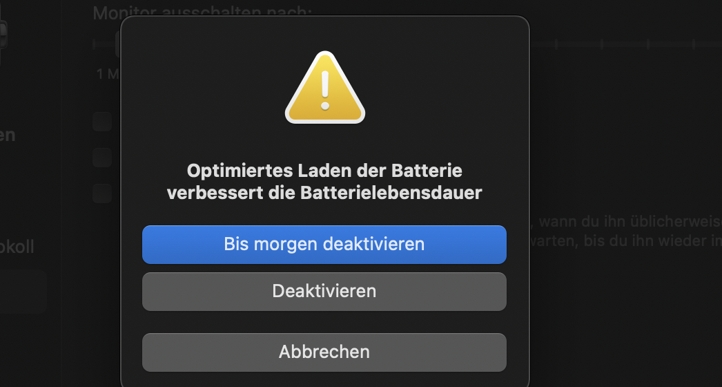

On my new MBA M1 it is still possible to switch between normal and optimized charging.
There are two options:
1. deactivate until tomorrow
2. deactivate

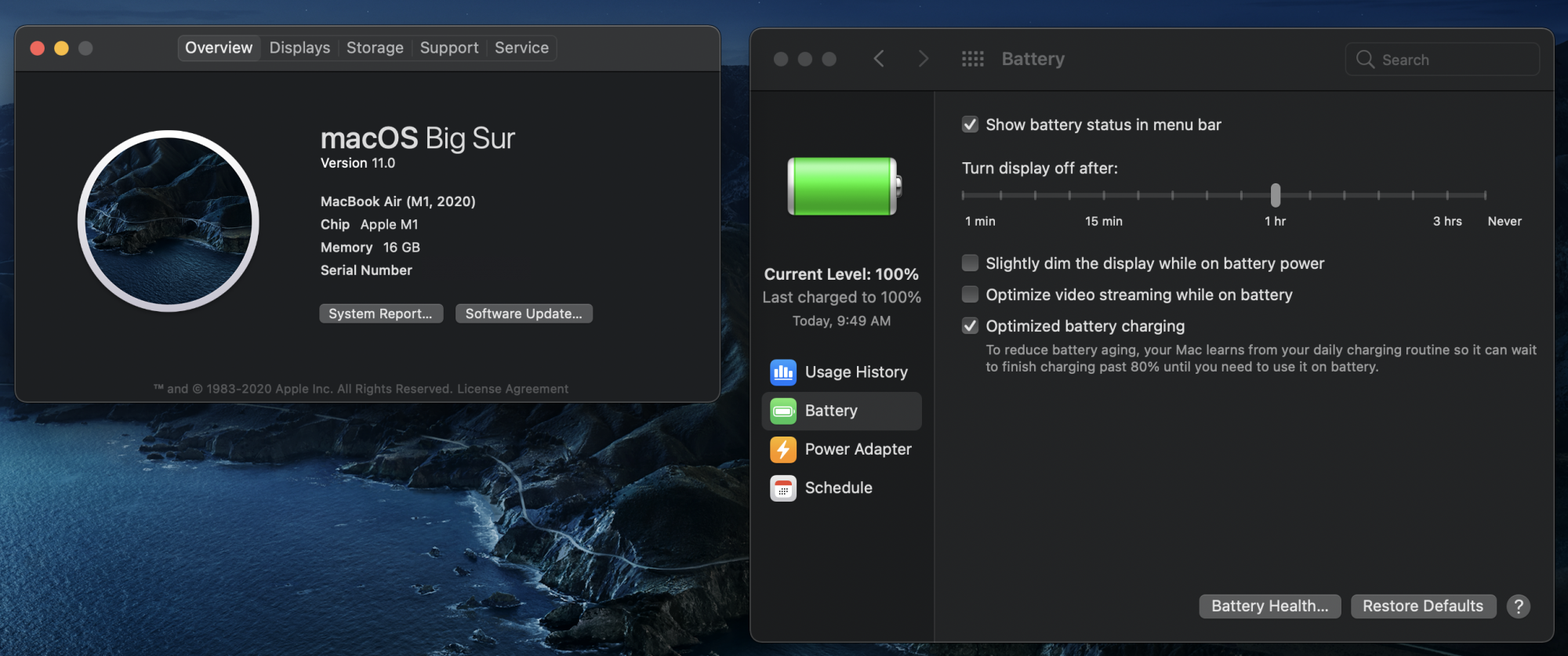

Is this talking about "Optimized Battery Charging"? Im able to disable that on my M1 Macair.
Click battery icon in menu bar -> battery preferences.
