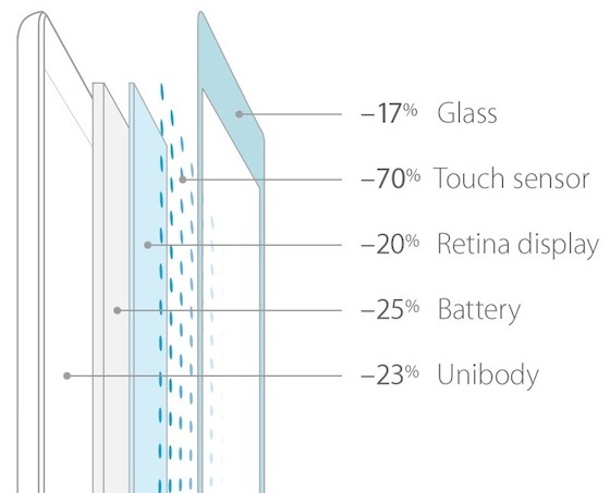

Apple's new iPad Air marks a significant technological step forward for the company, improving performance while reducing the device's volume and weight by over 25%. Much of the size and weight savings have been enabled by improved power efficiency, allowing Apple to reduce the device's battery thickness and capacity by roughly the same 25%.
Component thickness reduction in iPad Air
As noted in IHS iSuppli's component cost analysis released earlier today, the iPad Air now uses just 36 LEDs to light its display, down from as many as 84 in previous generations. Apple has also reduced the thickness of the display assembly, and so it appears that the display is indeed one of the areas where Apple has been able to make the most improvement on size and weight, both in the components themselves and in the battery capacity needed to drive them.
