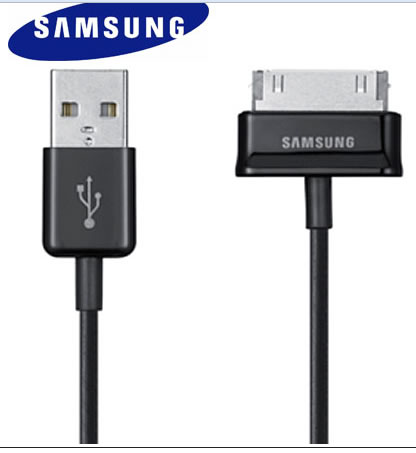

Amazing. When does the Samsung version come out?
Note: I do love Samsung TVs but sometimes the things they do just make me laugh. It will be extra funny when they do adopt it because they just bashed it in their printed ad.
