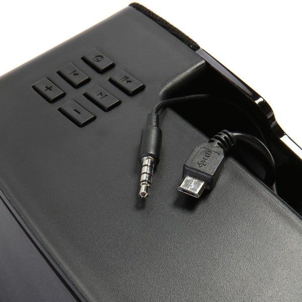

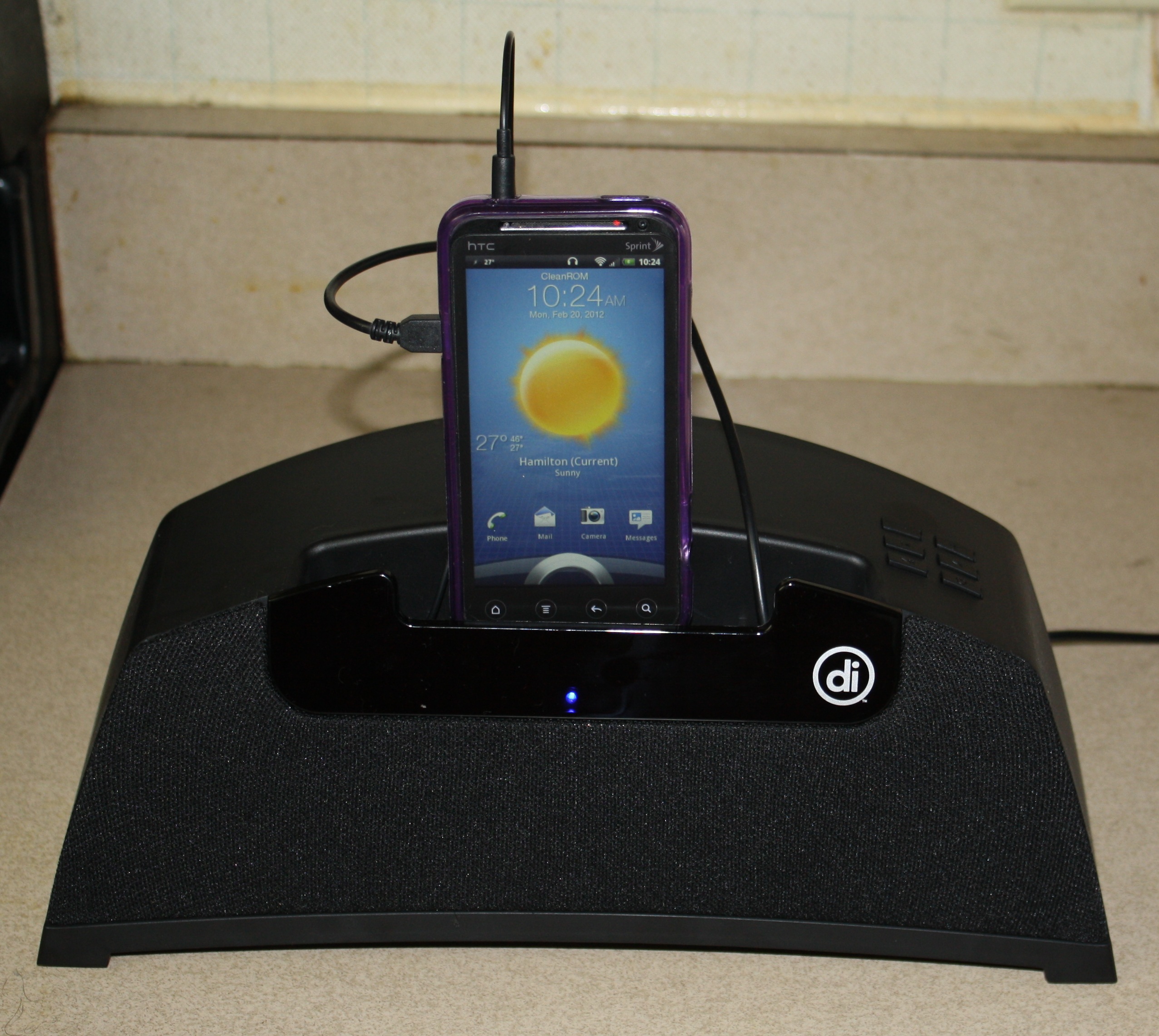

Does the micro-USB standard even have docking accessories? I am not informed so pleased enlighten me. Micro-USB is that tiny plug that looks like a grain of rice right?
I've never seen a dock that accepts micro-USB as the source.
There are a few MicroUSB speaker docks... but you gotta use an AUX cable for audio since USB doesn't natively carry audio. You'd think with a billion Android phone out there... someone would have come up with a better way.
That's why Apple's solutions, albeit proprietary, offer a great way to make a speaker dock. The original Dock Connector spawned an entire industry of speaker docks and other accessories... and the Lightning Connector will too.
All while MicroUSB will only charge and sync your phone.
