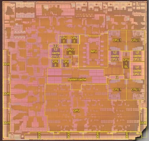

That definition of binning (in bold)is somewhat ambiguous. "Binning" is the division of a production run of the same unit into different "quality" groups based on the outcome of testing. The base line is the same model of chip - those that fail to meet some standard are put into a separate bin (a literal bin in some cases) and may be destined for lower spec machines if not discarded.
A14 and M1 are (almost certainly) different chips and would not be binned across Mac and iPhone/iPad product lines. M1 chips are binned into those with 8 functioning GPUs and those with only 7 (of the 8 on the die).
A14 and M1 are (almost certainly) absolutely positively different chips and would not be binned across Mac and iPhone/iPad product lines. M1 chips are binned into those with 8 functioning GPUs and those with only 7 (of the 8 on the die).
Fixed. They have much in common (like the CPU core design) but they are different.
A14: 11.8 billion transistors
M1: 16 billion transistors
(images courtesy tip3x)
Now, if you told me that iPad Pros used M1s binned for lower clock speeds, then that I might believe. And I have to assume that the 7/8 core GPU business is a result of binning, because I can't think of any other conceivable reason for it.
