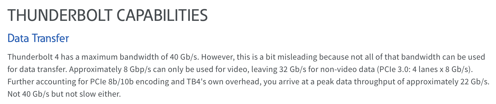

TB4 doesn’t support 5K @ 120Hz.
TB4 has a theoretical maximum speed of 40Gbsp, and that includes the protocol management. In reality the peak speed is ~22Gps. Moreover, TB4 allocates a maximum of 8Gbs to video, so there’s no way to support 5K at 120Hz.
I was just saying that bandwidth wasn't the primary problem because of DSC, not whether it was supported.
Where is your 22 Gbps number coming from? I'd like to see a URL breaking that down.

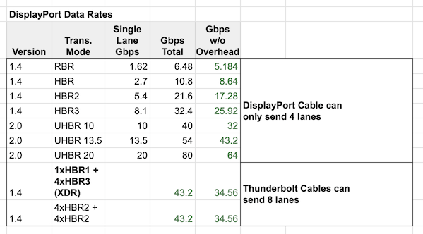

When the RX 580X Mac Pro was used with the XDR it didn't support DSC, but was still able to work because the Mac could send more than 4 lanes of DisplayPort (thanks to Thunderbolts). When using TB, there is a trick where bunch of DisplayPort stuffing data can be dropped, but that doesn't save 14 Gbps worth of data.
The lane setup was: 1xHBR1 + 4xHBR3 (I need to double check this, the math isn't' quite right, but I can't quite find the MacRumors conversation that talked about it years ago).
which still ads up to about 35 Gbps.

Thanks. I think there's one inaccuracy in this paragraph, because Apple is tricksy, and it seems a bit muddled to me.
If you are just using USB-C DisplayPort alt mode 1.4, the above is mostly true, though I believe the display bandwidth is about 25Gbps, not 22Gbps.
HRB3 8.1 Gbps * 4 = 32.4 Gbps
32.4 * 0.8 = 25.9 Gbps (removing encoding overhead, but there is MORE overhead, noted later)
But... that isn't what Apple is doing. If it was, the base Mac Pro 2019 never would have been able to run the XDR at 6K, the math doesn't work.
DisplayPort alt mode can use 4 lanes of PCIe, but there are also 4 lanes of TB available (as long as the total doesn't go beyond 40 Gbps).
When Apple is running a "Thunderbolt Display", it can run more than 4 lanes of DisplayPort. This bandwidth approaching 40Gbps.
Apple also breaks the tunneling layers a bit. Apple doesn't transmit some of the DP protocol timing and framing data (blank stuffing, etc), which lets them pull off non-DSC 6K throughput in 40Gbps across >4 lanes.
The 8/10 encoding is DisplayPort 1.4 overhead I think, not Thunderbolt overhead.
With DSC, there is a pile more effective bandwidth available, it is just a matter of all the steps in the chain supporting it.
