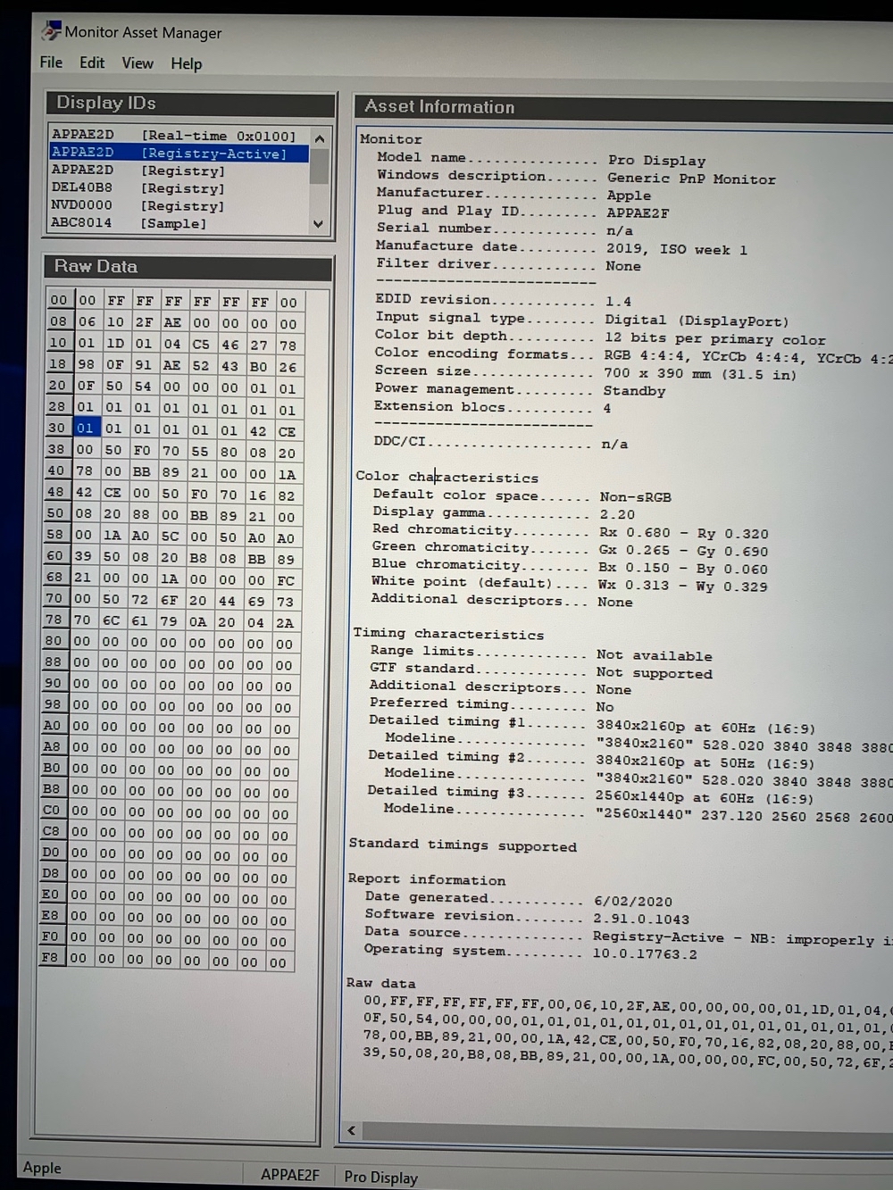

I feel like a caveman throwing sticks at a monolith! You remember I mentioned how I got the official EDID in the first place - by copying it from the EDID entry in the registry when it was correctly supplied after using integrated graphics?
Well for the life of me I couldn't work out to copy and paste hex codes from the custom EDID .txt into the registry editor, so I ended up manually typing in the hex codes!
Anyway, here is the custom EDID as it appears to Monitor Asset Manager.

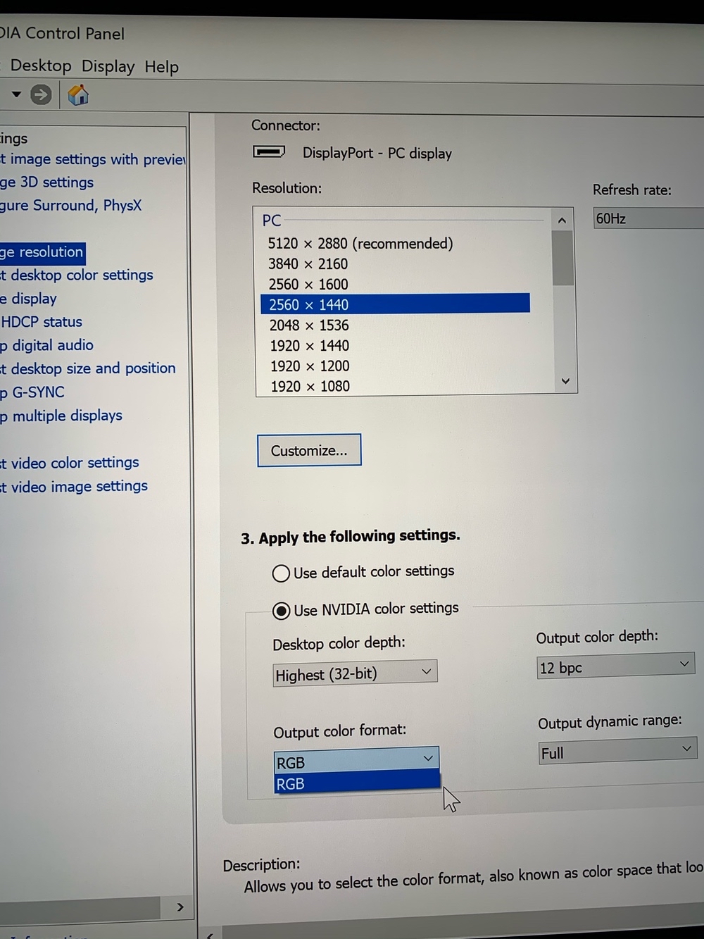

I couldn't get any of the chroma modes to appear in the Nvidia control panel. Expected, or have I screwed something up?
Monitor Asset Manager moninfo.exe doesn't seem to always be able to show the other extension blocks even though CRU is able to edit all the extension blocks. I guess I would trust CRU more. It has an option to export the EDID as bin so it can be easily decoded by edid-decode on macOS.

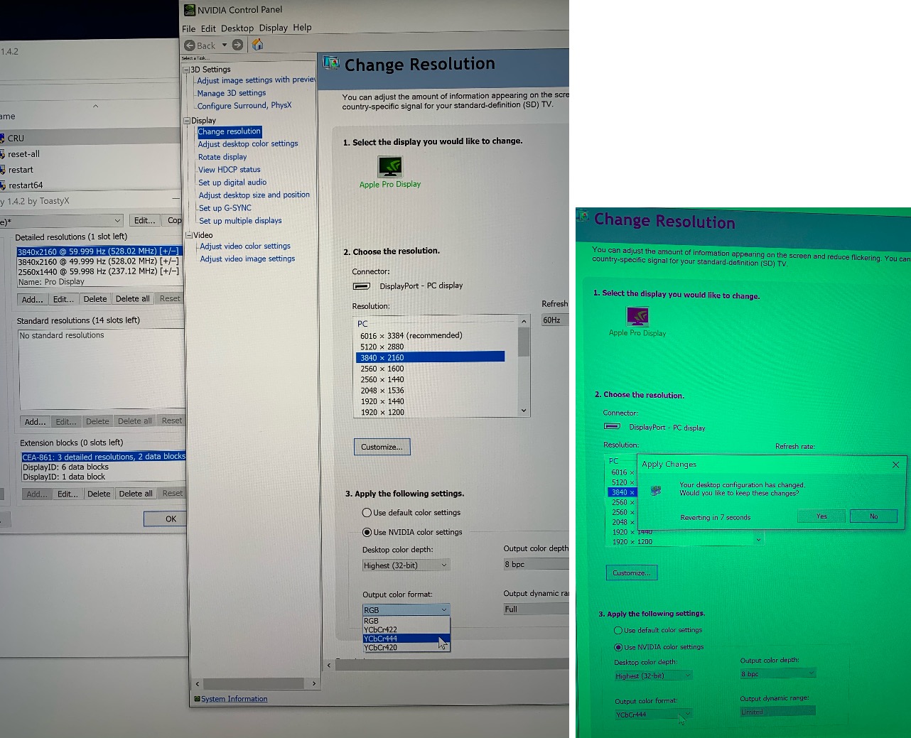

Okay, I think I got your modified EDID installed correctly this time, using Custom Resolution Utility.
It exposed a lot more modes in the Nvidia Control Panel.
Unfortunately, just about all of the new modes resulted in either a black screen or a green & purple display in the case of YCbCr444 (which as you said is close enough to RGB to still show something).
Does this conclusively prove that the chroma modes are not supported by the Pro Display XDR?
Thank you very much. It seems chroma sub sampling is not an option for XDR (unless someone makes a chroma sub sampling to DSC converter - very unlikely).

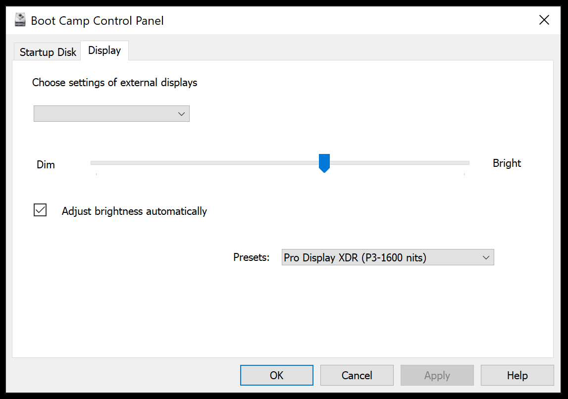

I installed Boot Camp package and it worked at 6K, with the ability to adjust the brightness. See my post, and the package download link is in #7 as joevt posted.

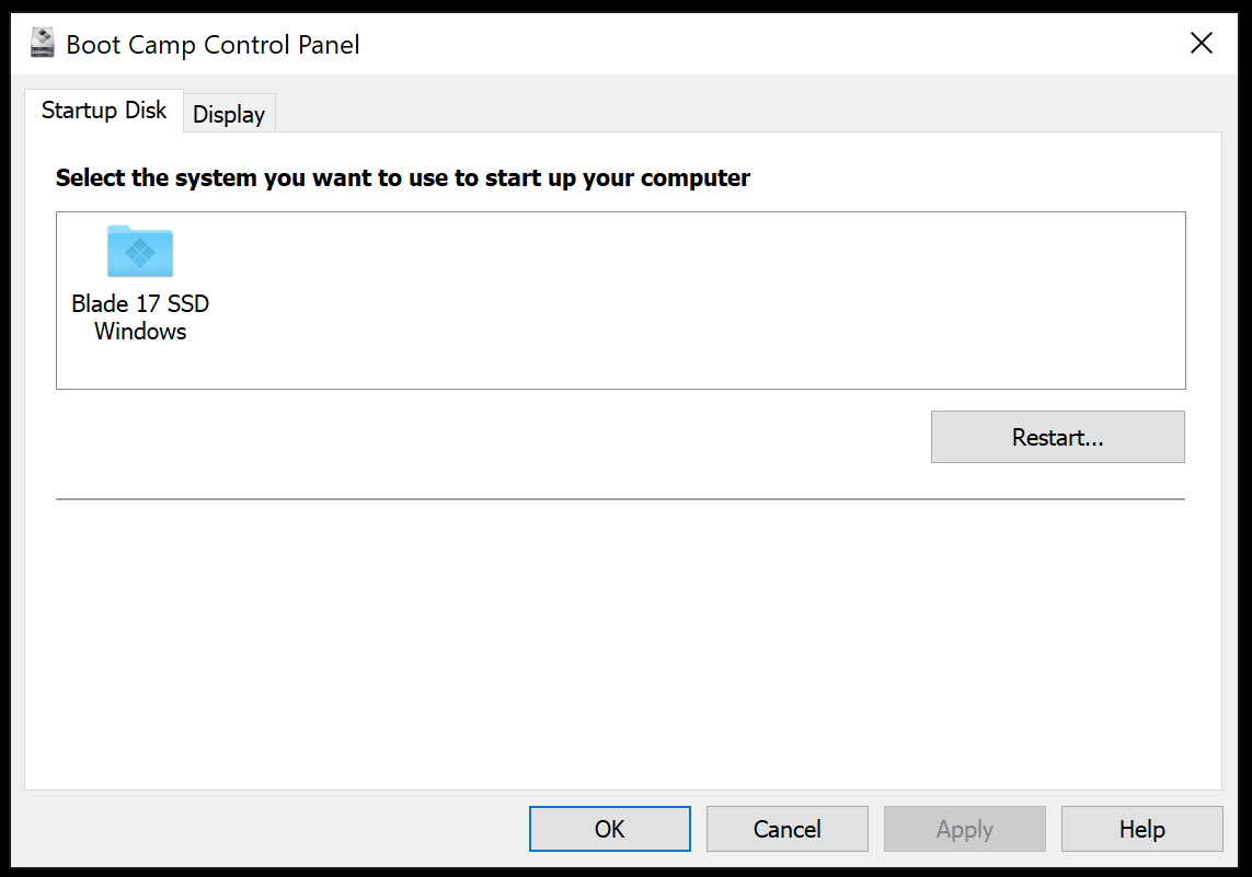

Dear ksc323,
I tried to repeat the installation process and I found out that there is a little detail that I have forgotten to mention:
Don't double click on the "Setup.exe" file in /BootCamp6.1.7748/BootCamp/, but instead run the "BootCamp.msi" file in /BootCamp6.1.7748/BootCamp/Drivers/Apple/. This should work.
Here I'm attaching two screen shots as a proof (I also changed the display language as English for convenience). As you could see, that unlike a real Mac, there are only two tabs that are displayed in the Boot Camp Control Panel, which are "Startup Disk" and "Display", where (in the second tab) you could adjust the brightness and change the presets.
Please let me know if this works. I really hope that I'm not the only lucky one. -Henry
