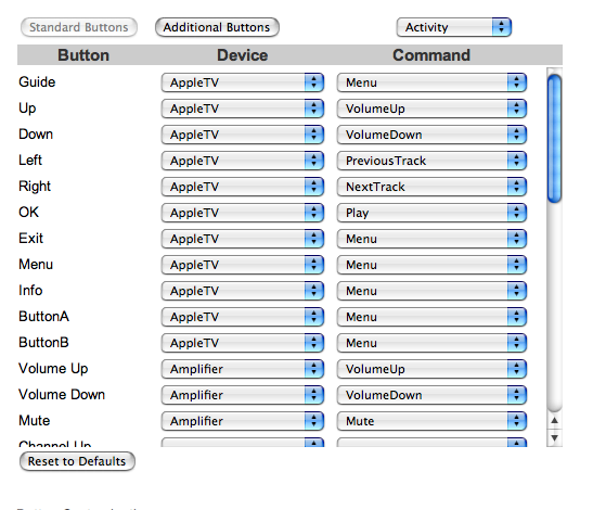

Ok Now you have to assign the correct AppleTV buttons to the remote
1 Click on "customize buttons" for the AppleTV activity
2 Just go down and select the "AppleTV" for the device, and the appropriate commands. I also set Menu, A, B and the guide buttons to the AppleTV Guide so I could hit any of them to go backwards. Set your Volume up, mute and volume down to be controlled by your amplifier/TV. I set my left and right direction buttons to skip forward and back as I wasn't sure if the rewind and fast foward buttons send a longer IR pulse...
3 Click done and you're as good as gold.

Thanks for posting. I have tried to program my Harmony 880 and had issues. I am clear on all steps except for your learning the remote.
"I also set Menu, A, B and the guide buttons to the AppleTV Guide so I could hit any of them to go backwards. Set your Volume up, mute and volume down to be controlled by your amplifier/TV. I set my left and right direction buttons to skip forward and back as I wasn't sure if the rewind and fast foward buttons send a longer IR pulse..."
Not sure what you did here. Any help would be appreciated. Thanks
Basically you just have to assign the AppleTV functions to the buttons you want to use. You pull down the little menu item until it says Apple/TV (or computer if you didn't change the name). YOu then will have about 6 choices, play, menu, direction left, right etc to assign to the button.
Check out the pic below.
Hope that helps
