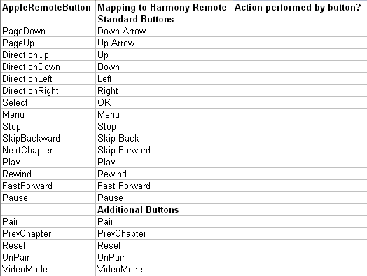

Can anyone describe what each of these Harmony buttons does when using them in the context of AppleTV?
Harmony Remote Standard Buttons
PageDown
PageUp
DirectionUp
DirectionDown
DirectionLeft
DirectionRight
Select
Menu
Stop
SkipBackward
NextChapter
Play
Rewind
FastForward
Pause
Harmony Remote Additional Buttons
Pair
PrevChapter
Reset
UnPair
VideoMode
Quick answer. The Menu, D-Pad and Select buttons mirror the buttons on the Apple Remote, and should do exactly the same thing on an Apple TV. I have found that, in addition, the "VCR" controls on my Harmony remote will also perform their usual function during playback: i.e. ff, rew, chapter skip, play, pause etc., but they don't do anything when navigating the on-screen menus.
