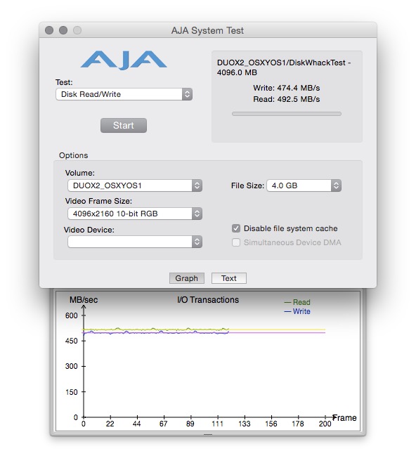

Here is a single Samsung 840EVO 1TB SSD on the Velocity DUO card in slot-3:
Now that’s what I should be getting. I’ve got the same Mac with the card mounted in the same slot, I’ve even got the same drive.
Have you recently done a "forced TRIM" on your SSD? Maybe with all the testing, etc. it simply has become full and hasn't had a chance to clean up the array.
Nope. Was a brand new drive, first thing I did was use the official Samsung tool to update the firmware.

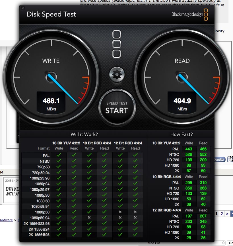

No Raid. Left is an 500GB 840 EVO that I tested when I had a Solo x2, Right is an 512GB 840 Pro on a Duo x2. Virtually the same.
Lou

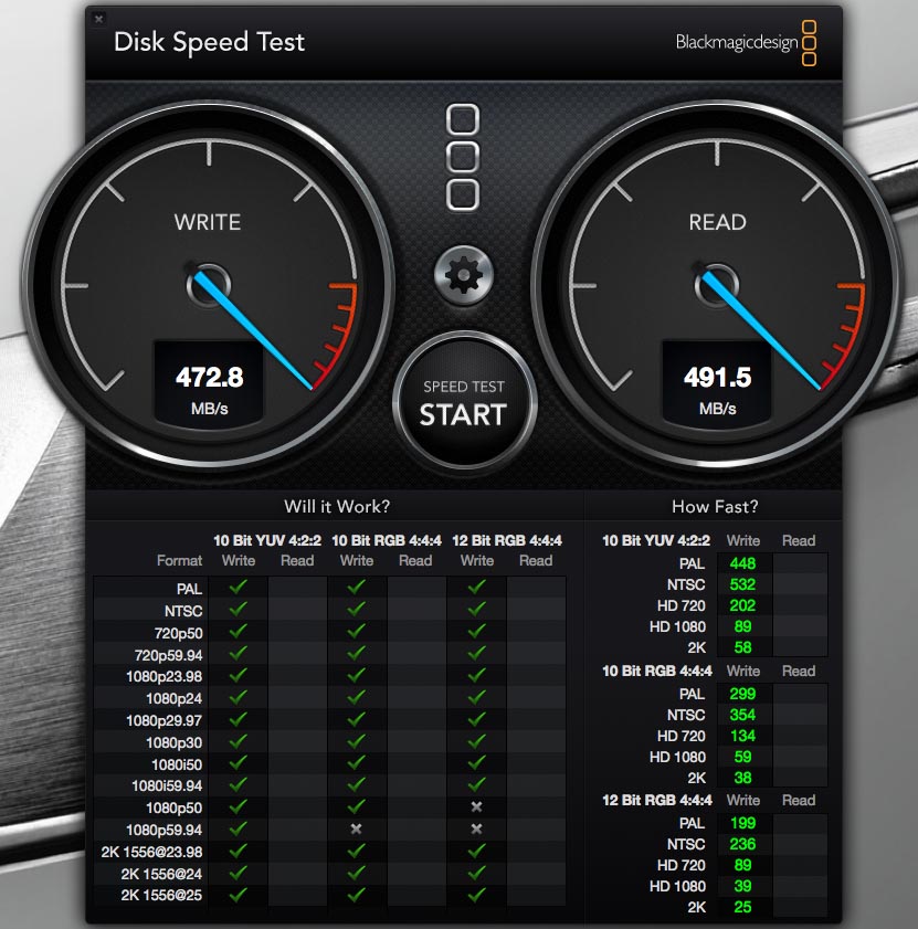

I can see your read/write speeds. There must be something wrong with my set up. You ain’t the only one that seems to be running at full chat. What slot are you in?

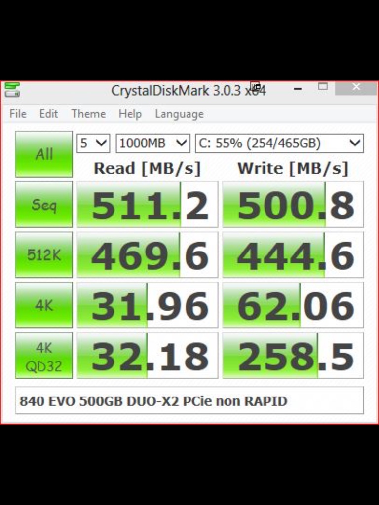

In my cMP 5.1 (2012) it's in PCIe slot #3. Here are my test results for a Samsung 840 EVO 500GB SSD on J2 on the DUO x2 in Bootcamped Windows 8 Pro x64 non-RAID & NO RAPID mode!

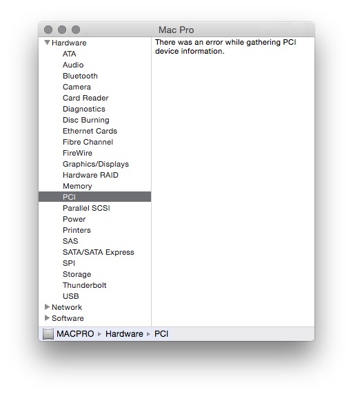

Is my assumption correct that due to the installation of a NON-EFI GTX-670 I can't read out the "PCI" section of System Profiler?
Is there another know application to read out the "PCI" section of my MP 5.1?

But even this gives me a PCI read out error. Any directions?
EDIT: the Terminal command:
Code:
system_profiler SPUSBDataType
does give a good readout for USB.
Cheers

I’m not sure what’s wrong with your PCI bus, do you have another card of any sort that you can insert?
As for other applications, I know of none on the Mac side though I’m sure there are plenty for Windows.
