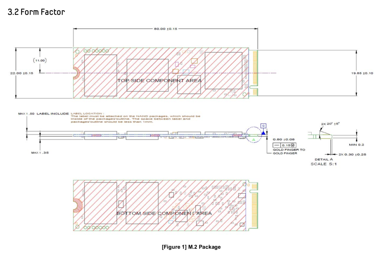

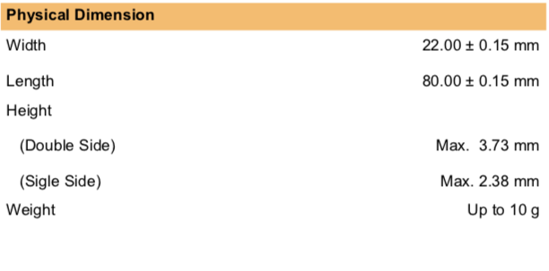

2.3mm is the usual height for most single sided blades, so I doubt that this information is correct.
SM951 128GB is a single side blade with 2.38mm, while 512GB is a double sided with 3.73mm height:
