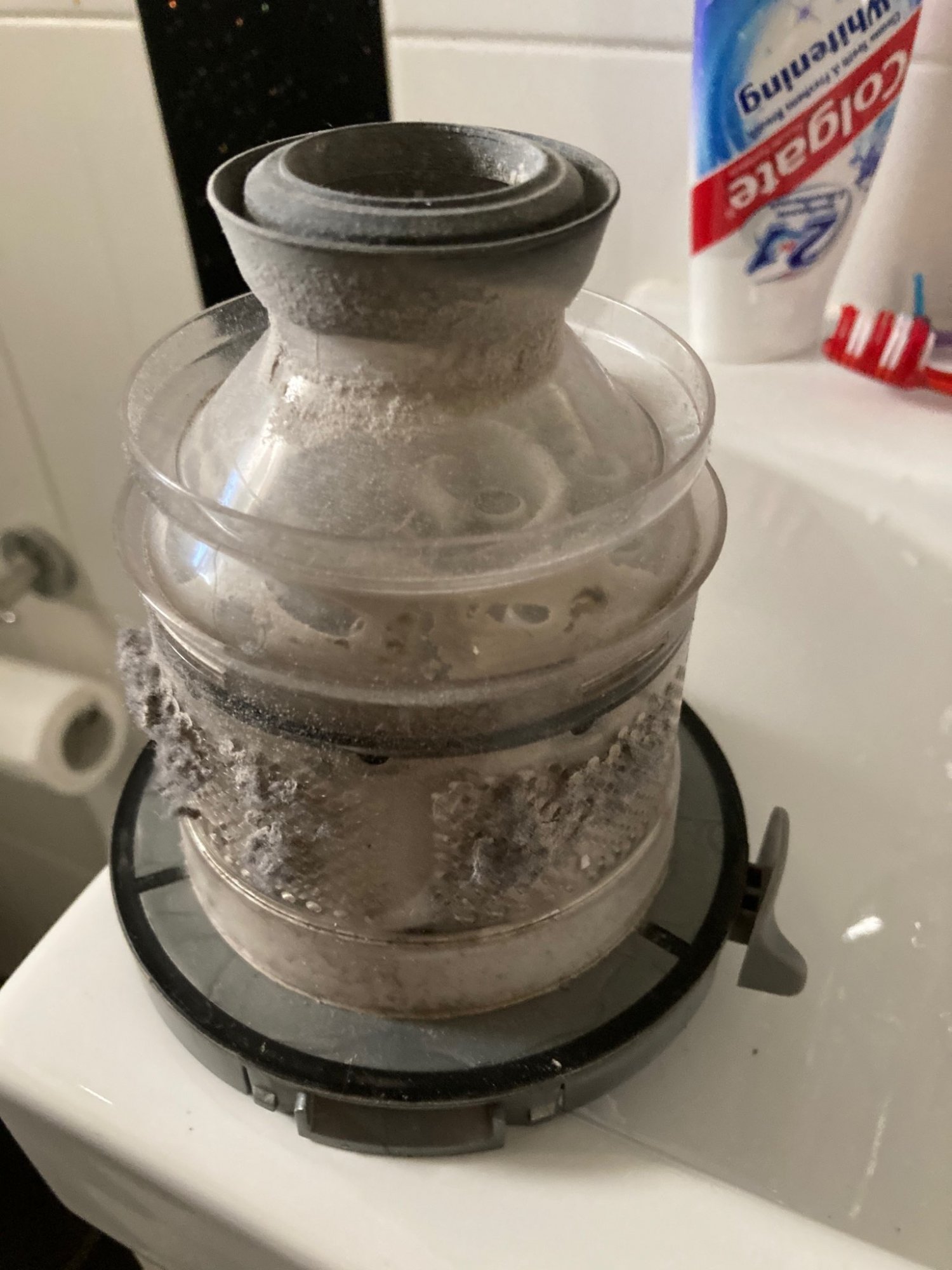

Recently I also started to wonder about the nature of the persisting white powder in the filter of my handheld vacuum. Upon contact with water the powder seems to turn into a paste/cement like substance. I lived in a different flats but I don't think I ever saw my vacuum filter look like this.
