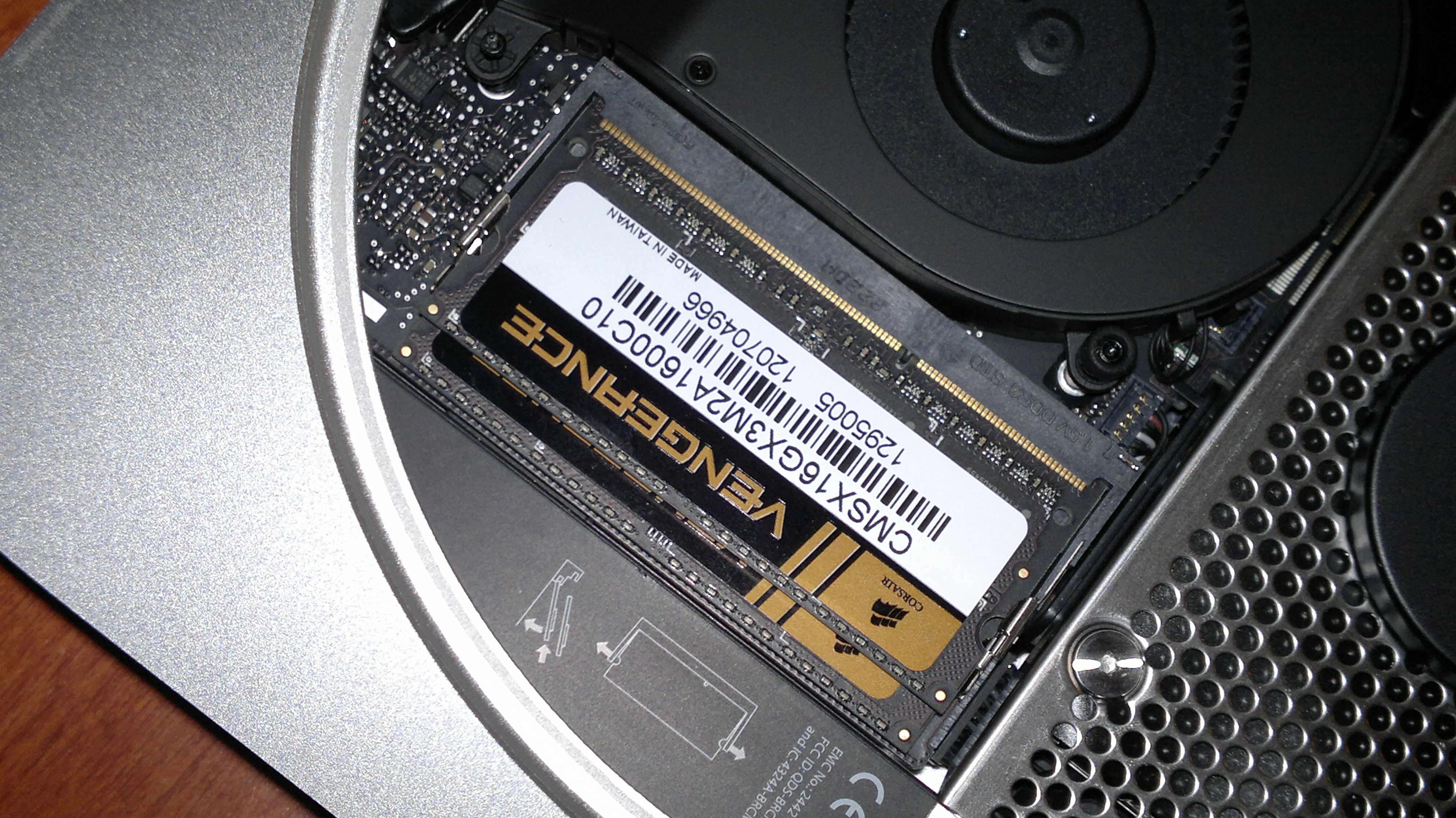

I got Rember test failures (and kernel panics) when I tried 16Gb of Corsair ram (regular speed) in my i7 2,7 mini. I returned it for a refund.
Today I have been running 10 more laps of Rember and again in test 10 out of 10 I get the same strange error as posted before...
I will bench over the weekend and go pick up my Kingston PnP 8GB kit on monday, if the 8GB kit benches very close to the 16 (or better because its faster) then I will try to return the Corsairs for refund.

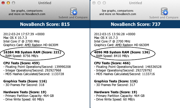

4GB DDR1333 vs 16GB DDR1600
NovaBench:
Faster RAM speed + more RAM = higher score.
Will have to see what the Kingston PnP 1866 gives because it's only half the size but even faster speed.

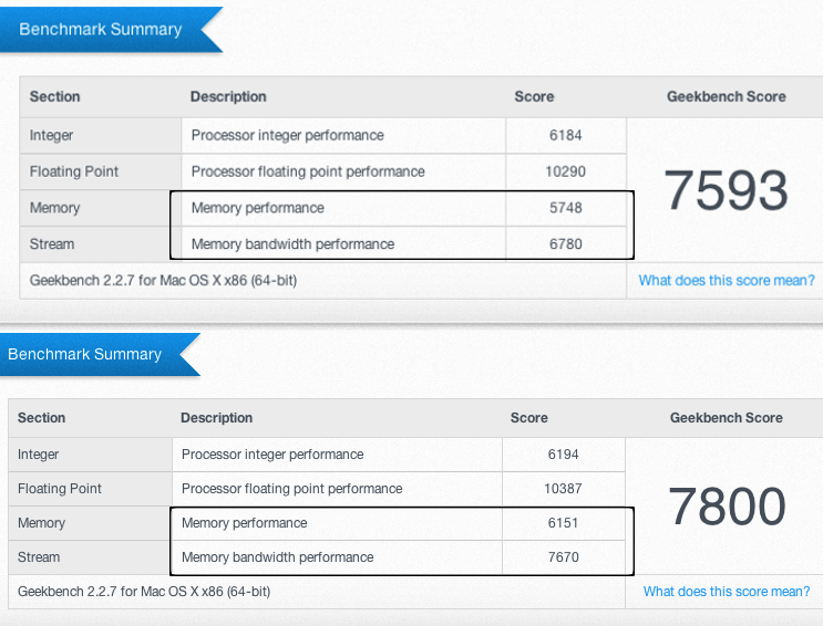

GeekBench:
Memory performance a little bit higher, mostly due to RAM speed I guess, but will see that when I have the Kingston PnP number because they are even faster.
Memory bandwidth gives a BIG difference, my guess is due to the much bigger memory size, 4GB vs 16GB. 8GB numbers should land somewhere in between.

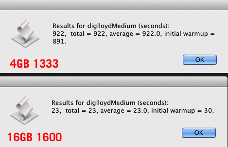

Lloyd Photoshop benchmark:
Photoshop CS6 is a really memory hungry app, swallows the 16GB like candy but also gives a HUGE speed difference.
Will wait to see if it's only speed as in RAM speed or if amount also makes a difference.

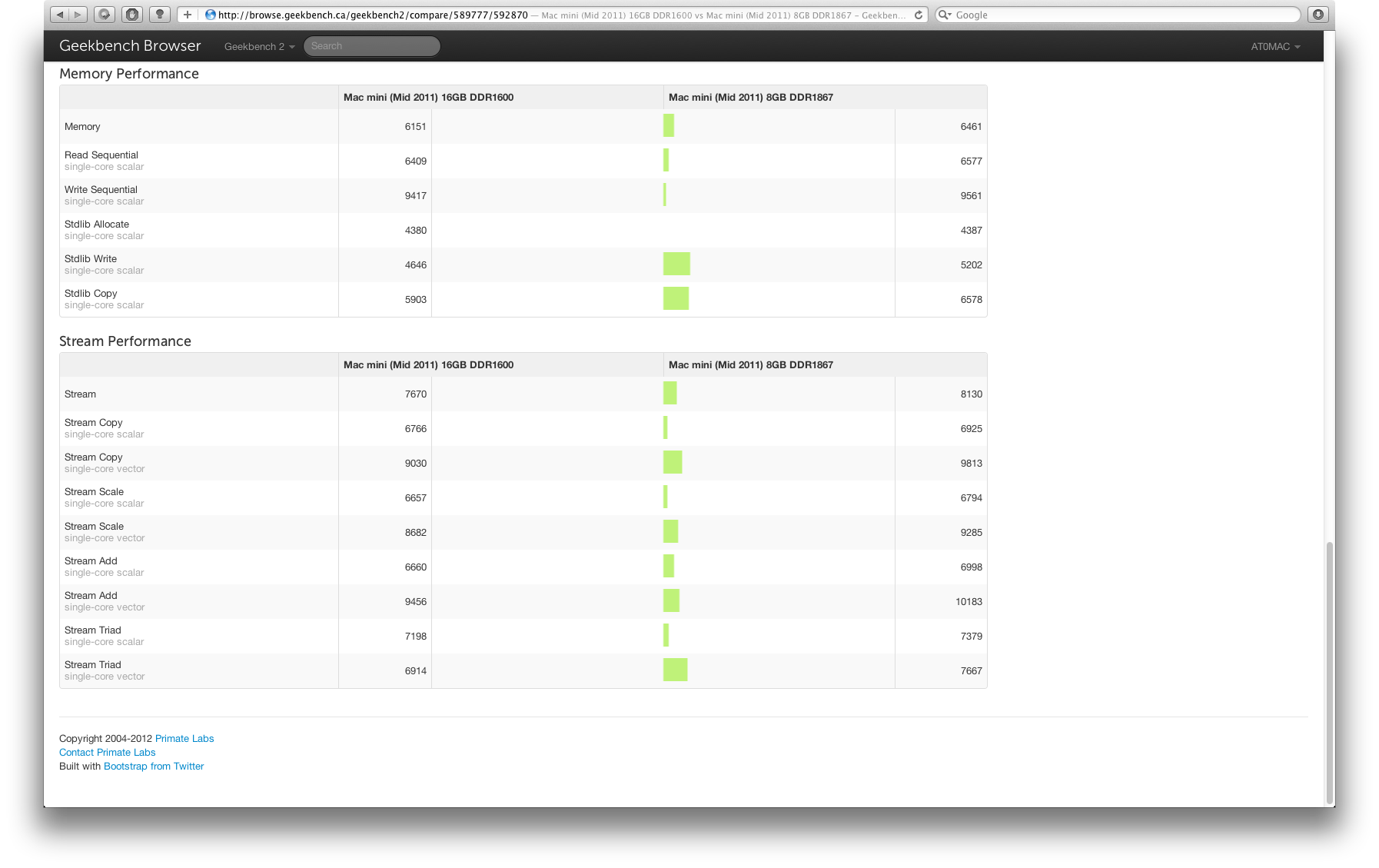

GeekBench:
I posted the result difference on my 2011 15" MacBook Pro 2.3GHz Quad-Core Intel i7. This was a very good apples to apples comparison because the previous memory was the same capacity and vendor, so the only change was the memory speed.

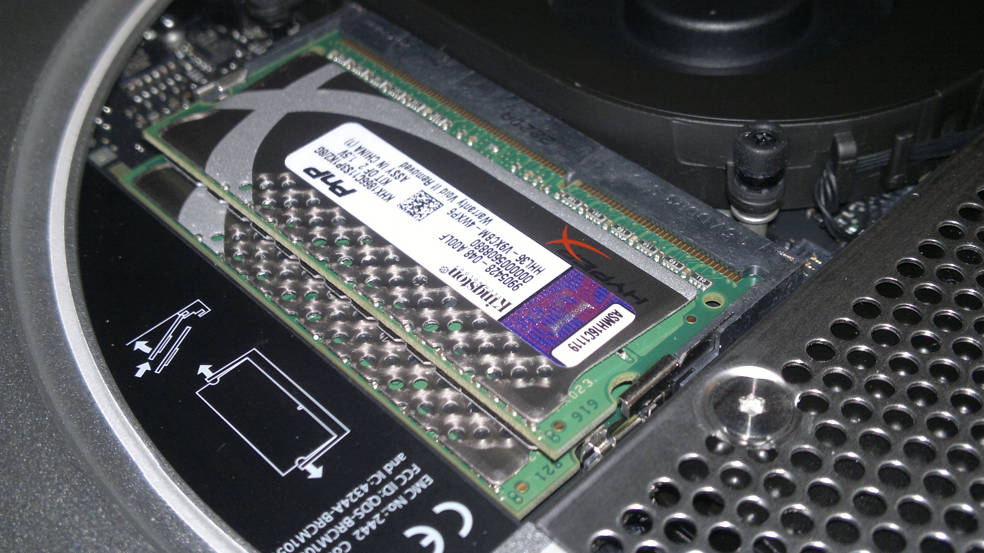

Just installed my new Kingston HyperX PnP 1867MHz DDR3 2x4GB kit.
Am going to Rember test them the next few hours to see if they work as expected before benching anything.
Am thinking about if I have damaged my SSDs and original Apple RAM because I have placed them next to my small desktop speakers with 4" midrange?
Can the magnetic field from the speaker do anything bad to RAM or SSDs?
Just a thought, have not tested them or anything but moved them further away just in case it was a bad place to put them...

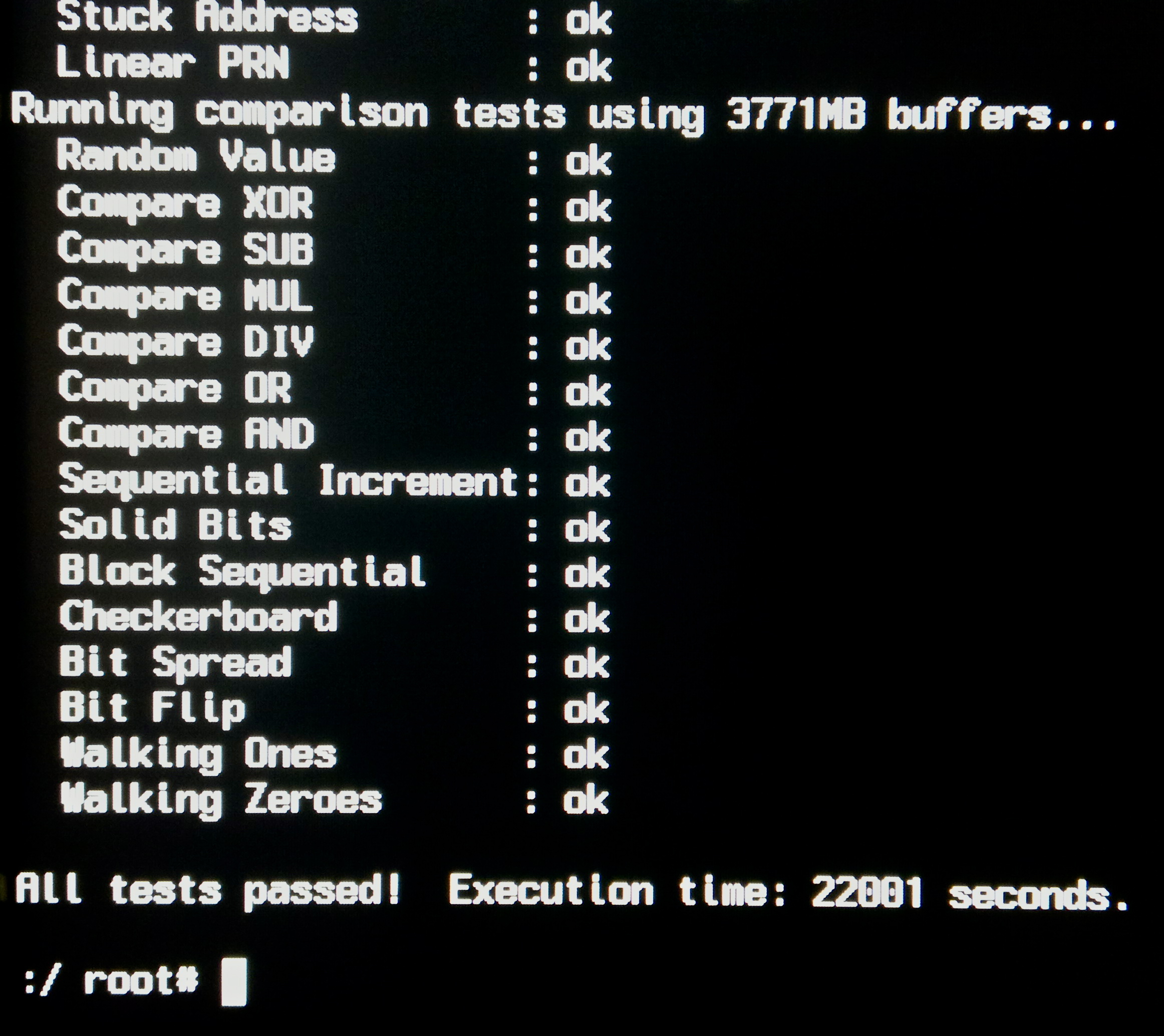

After running Rember most of yesterday, failing the first few tests with same strange error as the Corsairs I finally figured out how to run the real memtest in Single User mode!
Feels like going back to the old days when I started as a computer enthusiast (ca. 1991):
The new Kingstons passed with flying colors!
A small minus regarding the Kingston compared to the Corsair is the look, they just don't look as good :(not that you will ever open up and look, but just to know that they look awesome is a nice thing)
Kingston:
Corsair:

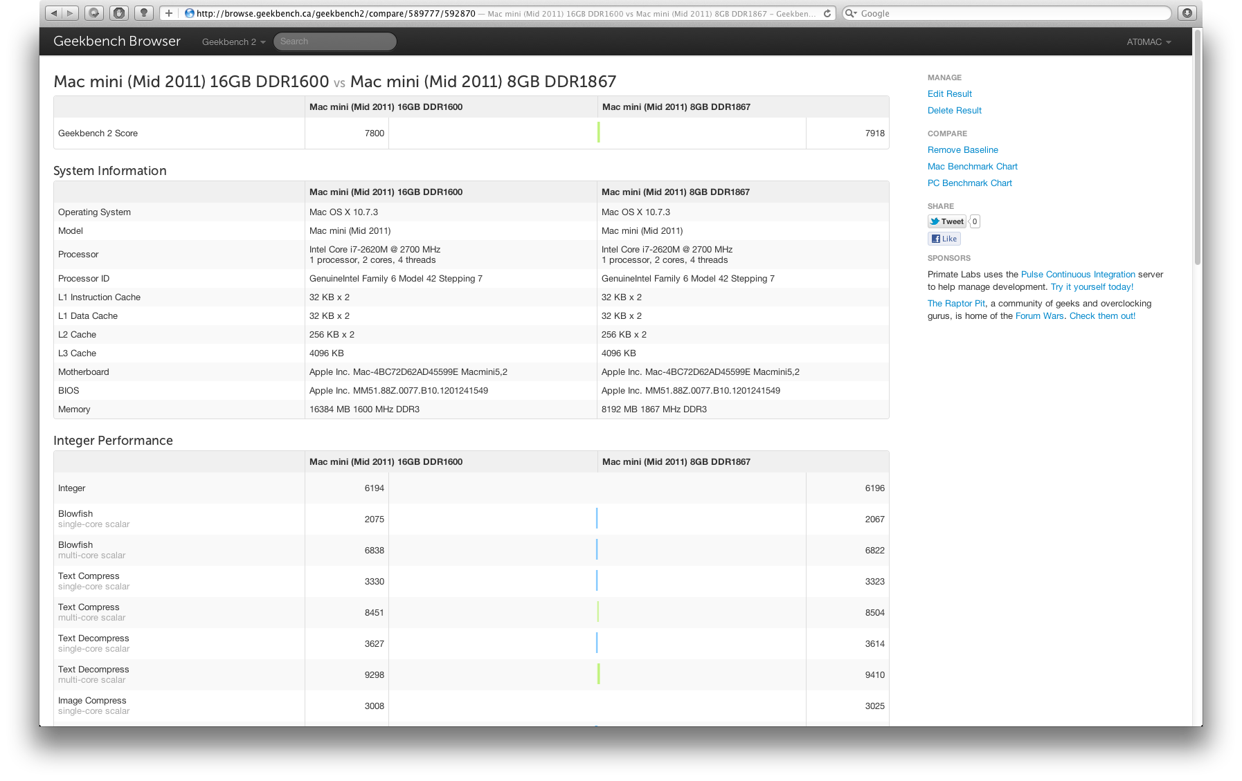

After benching GeekBench I had quite a surprise!
CPU test are very similar between the two RAM kits:
But memory benchs on the 8GB Kingston kit are a whole lot better:
Gave me a 7.918 total score in 64bit!!
Sorry the pics are so small, they are also on my Flickr

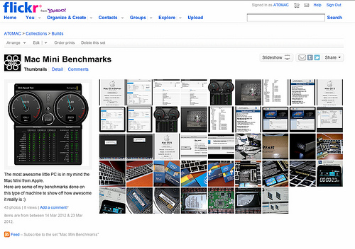

Final results have just been uploaded to Flickr.
I don't have time now to sort them out and explain them, but you can sneak peak until I return.

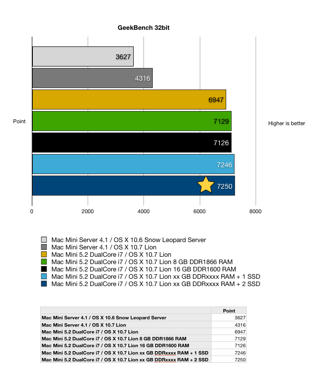

GeekBench 32bit:
As expected the GB score kept climbing until it reached it's max of 7.250 points wich is a lot in 32bit as far as I can tell!

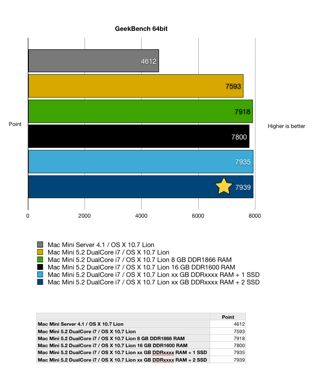

GeekBench 64bit:
Same story goes for the GB 64bit scores wich tops out at 7.939 points!
An interesting fact is that the 8GB Kingston 1867MHz kit scores higher than the 16GB Corsair 1600MHz kit. Seems that GB really likes fast RAM and don't care much about the amount.
Another interesting detail is how close the SSD scores are, GB don't utilizes the read/write speeds of a RAID0 very well apparently...
For short, it's a true synthetic benchmark that only gives a faint hint of how powerful a machine really is.

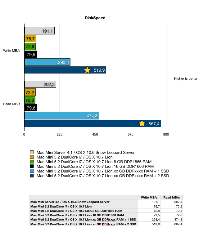

DiskSpeed read/writes:
Aboslute AWESOME read/write speeds this little machine have now when it is in RAID0 = 520MB/s write!
Thats half a GB! It's like the usual amount on a a Music CD written in 1 second (if just there was a CD burner that could write that same speed...)
870MB/s read speeds!
Thats about the same read speeds as the OCZ Z-Drives have in four way RAID (whatever that is?)!
A strange thing here is that the fast Kingston 1867MHz 8GB kit scores the slowest read/write on the stock Apple 5400RPM drive.
The 16GB 1600MHz gave it a good overall speed improvement of a few MB/s more.

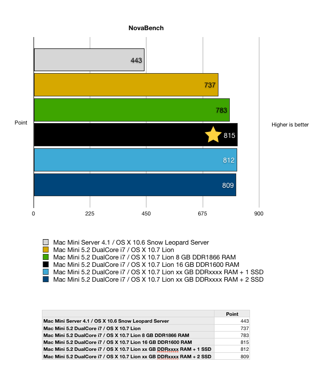

NovaBench:
NB looks a lot like GeekBench like a real synthetic benchmark, wich it is.
It favors a lot of RAM and a speedy disk compared to a flying speedy RAID0 system and a lot faster set of RAM.
If you find the schematics/results I screen dumped to my Flickr you see that the 16GB and 8GB kits have one mayor difference in their scores - the RAM test.
CPU test are almost similar with 459 and 467 in favor of the 8GB set, Graphics score similar 116 and 115, hardware test in favor of the speedier 8GB set with 19 compared to 21. But RAM score is 221 and 180 - only because of the amount! The speed it self the 16GB scores 8756MB/s were the 8GB scores 8886MB/s and still gets a smaller total score because the amount is smaller.

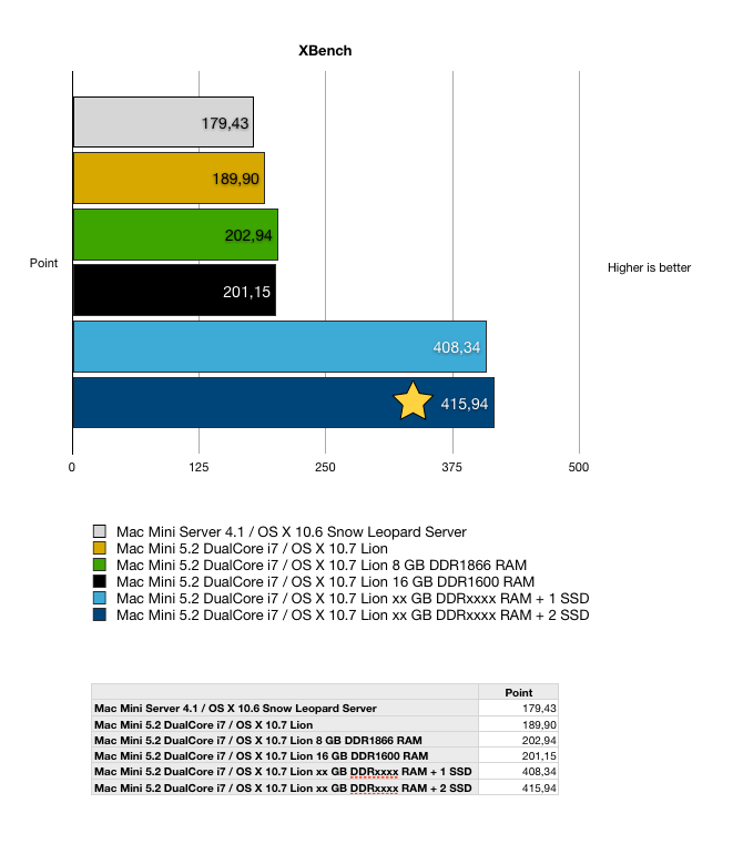

XBench:
XBench is also a synthetic benchmark but it looks like it's more accurate than both GeekBench and NovaBench as it favors speed above anything else.
The faster Kingston RAM gets higher score than the Corsair and also the total winner is the RAID0 system. Nice :)

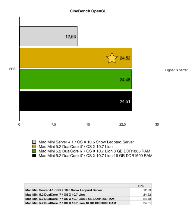

CineBench OpenGL:
It is practically identical no matter what configuration I used, except for the old Mac Mini Server C2D machine I started with.
I had heard a rumor faster RAM should give higher FPS, don't work that way on the MM with AMD graphics - maybe on the Intel HD graphics edition were it uses a portion of the system RAM?
Decided to not test on the SSDs as it didn't seem to change anything.

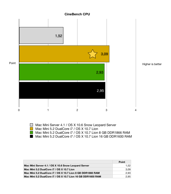

CineBench CPU test:
Same story goes for CineBench CPU test, same CPU all trough so no difference what so ever.
Didn't test it on the SSD setups.
A funny thing though, the stock MM 2011 gave higher scores, maybe because I later on had SMC upgraded and a few OS X updates from Apple?
The rest of the tests are made on exactly the same system with only the changes as described.

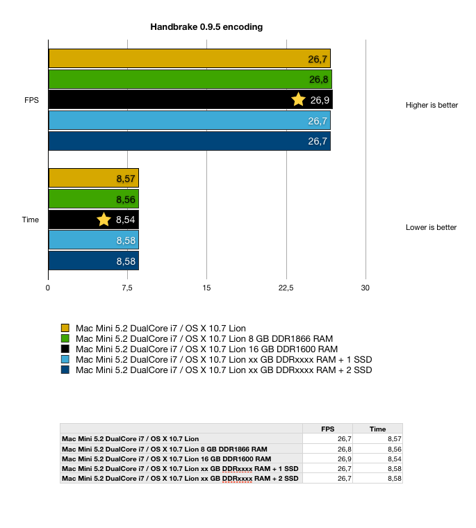

Handbrake 0.9.5 video encoding test:
One of you here at Mac Rumors Forum suggested to try a Handbrake video encoding test, so I did...
It faired pretty good - quicker than a Mac Pro with dual Xeon quad-core processor (that one scored 24.3 FPS in 9:51 minutes)!
Handbrake 0.9.6 video encoding test:
But there have been released a new edition of Handbrake since that guys thread started, so decided to give it a go in the new version also.
The old version favored more RAM (Corsair 16GB kit) were the new version favors faster RAM (Kingston 8GB kit 1867MHz).
