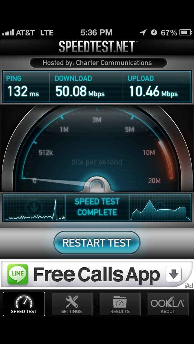

AT&T in Baton Rouge. I have had LTE almost the entire time I've had my phone since Friday night. Almost always at least 3 bars of it too. Most place I have all 5 bars. It isn't always lightning fast but it is 90% of the time. And sometimes whenever I end a call, it will take a little while to connect back to LTE from Hspa+ 4G. But I can live with that 🙂. It may be because LTE isn't at it's full strength here yet. But either way I'm not complaining 🙂
