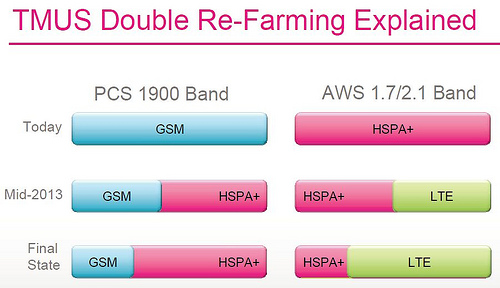

But basically, if you have an AT&T iP5 that doesn't have a serial number listed in the the thread, you will get LTE on T-Mobile, and you will get 4G, but only on up to 21 Mbps on TMobiles "refarmed" network. If you have a phone that does have one of the serial numbers listed, then you will get LTE, plus 4G on the refarmed network, plus up to 42 Mbps on TMobile's dedicated AWS spectrum.

If it's an early model, pre-March, you don't have AWS(1700/2100mhz) band support for 4G/HSPA+. If it's a later model you do.
You can compare serial number at this support site for concrete verification.
http://support.apple.com/kb/HT5720
If your serial number doesn't match. No pink in the right hand column for you. But you get the green, and you get the pink in the left hand column.
