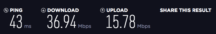

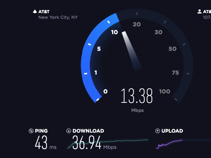

I've never heard of homebase before so I cannot comment on it, but I can say that with both my 6s and my 7+, my hotspot speed is identical to whatever my LTE speed is.
From my phone itself:
From my desktop tethered to the LTE:
Burned through roughly 300 meg total on speed tests, so I can assure it it's practically identical. Hope this helps!
