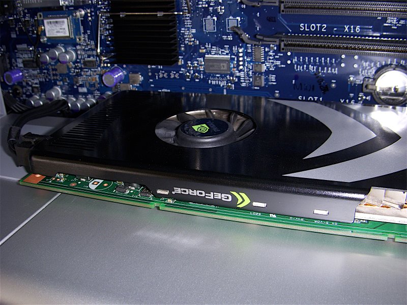

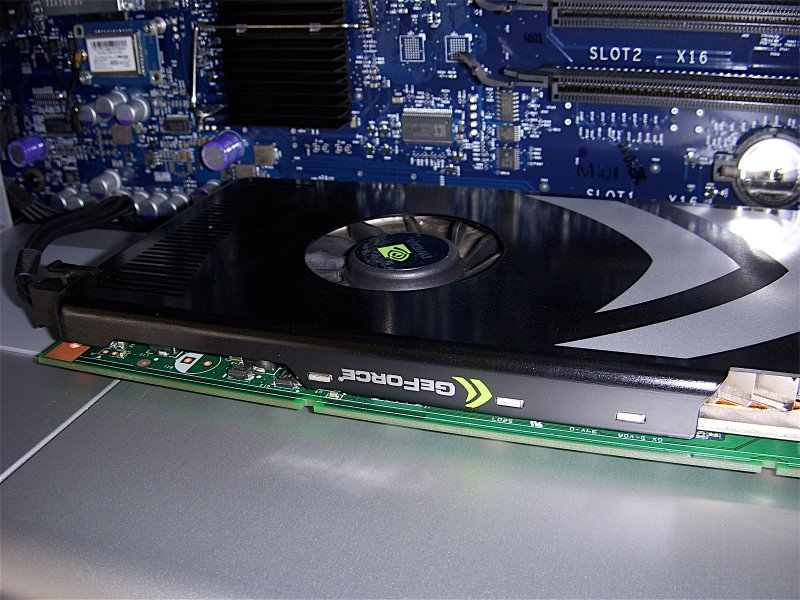

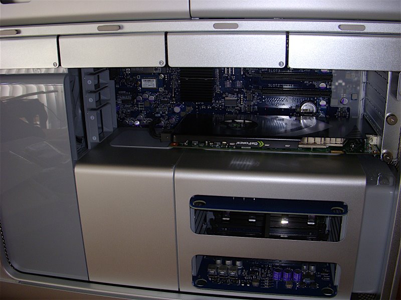

The 8800GT's shipping with the new Mac Pro have SLI connectors...
I don't know if the mobo supports it though for Windows
You don't need motherboard support, you need driver support. All SLI/Crossfire is done in software (except for the SLI/Xfire bridges but they are on the graphics cards).
