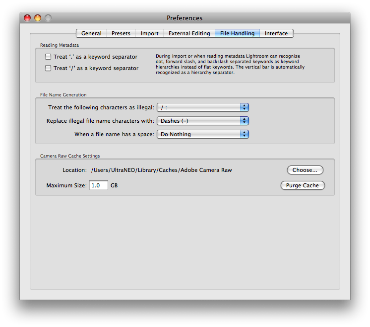

OK.. Just took a closer look at my copy of LightRoom2 there are no user settings to optimise RAM of any sort. The enclosed attachment is the only thing that remotely related to RAM and it's a Camera Raw cache.
...and how does that preclude LR2's ability to use available VRAM?
it doesn't.. though, in my opinion the OP should boost the overall system RAM to enable the application to run more smoothly, as you know previewing, opening and developing RAW files does take a lot of resources.
