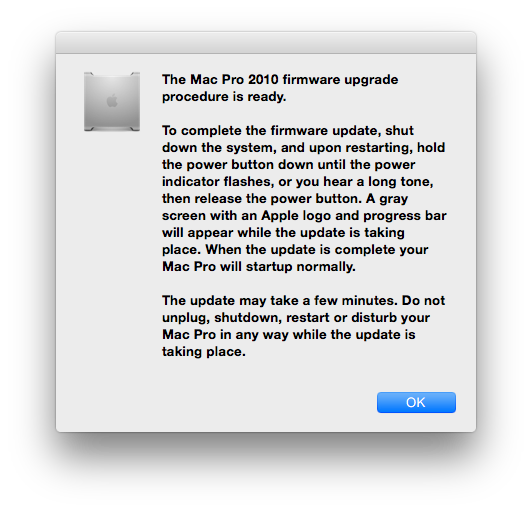

When it finishes and tells me to follow the procedure I go to shut down the computer
Did you click OK button?
