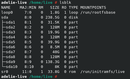

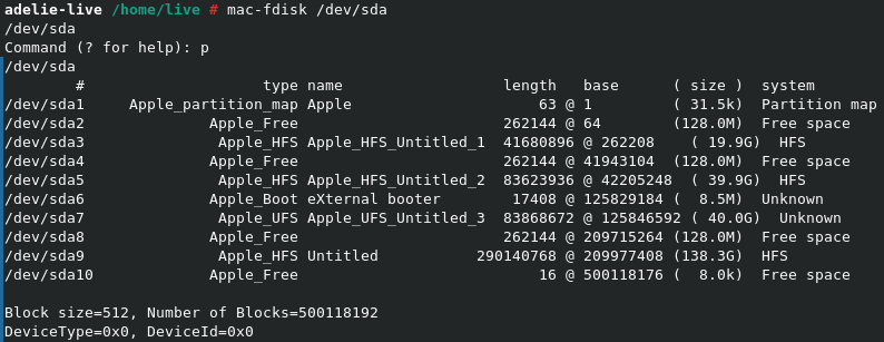

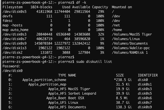

Here's some info on current partitioning: (the "Linux" volume is essentially empty for now, this is where I plan to install Adélie)
Logged on Sorbet Leopard :
Running from the Live Adélie DVD :
So... how to make sure I keep the Tiger, Sorbet and Documents volumes intact, while getting Adélie (and grub) installed...?

I didn't pay attention to this before but you're right there are 3 "extra partitions" created by the Apple Disk utilitity, each of size 128MB (here sda2, 4 and 8) that are deemed "free space", so I guess one may use them as one likes.

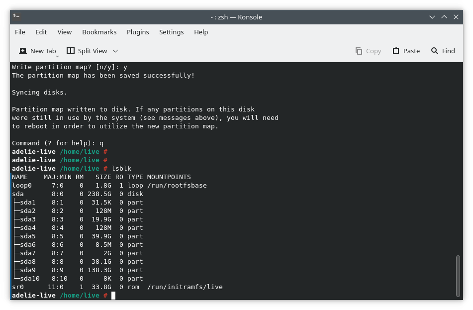

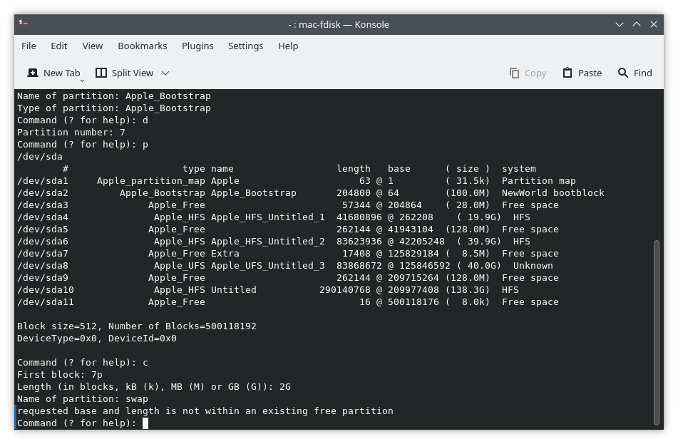

Oops ! Problem : after deleting 7p (which shrank it down to 8.5M, I did a "p" to check the partitions after deletion but didn't notice the small size), I could not create a 2G swap partition as planned, instead I got an error as you can read below:
So... what should I do next ? Do I need to use/calc start and end blocks to create the swap partition ?
I see the 138G "Documents" partition has moved from sda9 to sda10, not sure it's a problem though (I'll see what happens when I next reboot into Sorbet).
I see what happened.
Creating the bootstrap partition had moved all the partition numbers down by one, because not all of the free space was used to create it. As you can see, the 40G Linux allocation is now at sda8 instead of sda7, and (unless you didn't write this) you may have kiboshed one of your volumes (the 8.5M "Boot OSX" volume).
Well actually no, it's doing d 7 which did that, since what you see in the pic is partitions right after d7, so _before_ the attempt to create a swap partition.

Right. This was also after creating the bootstrap partition, and since the entire free space wasn't used for it, there is now a free space and a volume, and so all the partition IDs were bumped by 1.
OP
#8
Nothing is truly lost (as long as you didn't write the partition table), but try it again, now specifying to delete volume 8, create a swap there, and then create a root at volume 9.
Alternatively, you can fill the free space for the bootstrap volume using 2p for its size, which would result in the volumes not moving down
