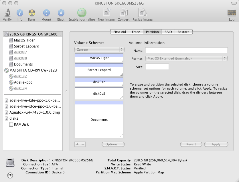

Obviously 90% of the actual install remains, but at least I got that off my chest and don't need to boot from DVD anymore to get into Adélie. I think.
Side note : oddly enough the Pbook rebooted to Tiger instead of Sorbet, and Disk Utility now shows this (Volume Scheme) :
to compare with what I posted in prev page :
Anyway Tiger, Sorbet (and Documents) still there and bootable so no harm there apparently, just this odd look in Disk Util.

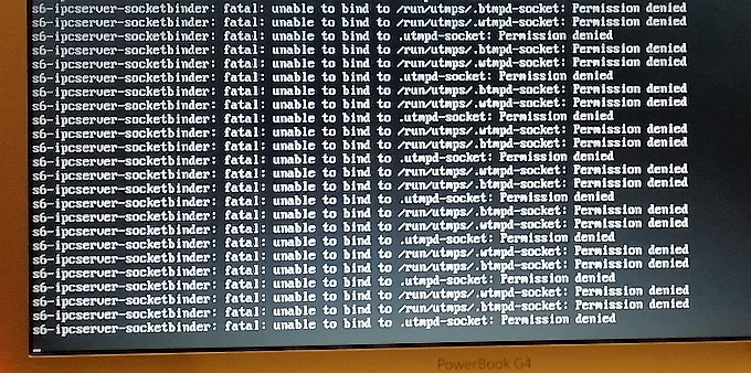

So... I booted into the newly installed KDE-text Adélie beta5, and was greeted with the following :
Beautiful, isn't it ? 🤡
I..... have no idea on this one.
But the first thing to check for "permission denied" would be the permissions on whatever is being accessed; in this case ".?tmpd-socket" files
Yeah, and then on to the next issue (not sure I could even fix this one)... and I haven't even started installing any package ! 😏

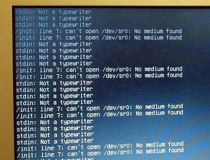

Well... took the plunge, trying the Lubuntu remix as suggested above, been able to boot it from usb (which is near miraculous w/ some Powerbooks, thanxx to hours of looking for a usb thumbdrive the Alubook would kindly accept to boot from, and it appeared to be the very last of the 6 flash drives I have, of course right ?).
Anyway, I could get to the boot: prompt, entered live video=TV-1:d video=offb:off nosplash as required, it started to do its things... until a certain point however : it looks like the boot-up script expects to get something from the CD/DVD drive, not from the usb drive :
Obviously if all it takes to go thru this is burn a DVD with the install, I will (reluctantly since it's a PITA with my setup) do it, but I wouldn't mind if another easier solution was available. 🙂

It’s been years, but those messages are normal IIRC. Do you have a USB stick with an LED in it to verify that it’s still being accessed or not? Booting from USB is SLOW on PPC Macs. It might take quite a bit longer to fully load vs from cd/dvd. If you waited like 5 minutes and nothing more happened, then yeah it probably failed somewhere.
If you are going to burn a cd or dvd, use the actual 12 or 16 live/install iso’s. The persistent USB version isn’t meant to be installed. Good luck. 🙂
Hey @wicknix, glad to read from you ! 🙂
Yes the usb stick does have a led on it, and IIRC it was still flashing while I was getting these repeated error messages (tens of them). I let it go for a few minutes then decided s'thing was wrong and stopped it, so what I'll do is give it another try and be more patient this time around.

so probably the one I d/l is only intended for install from a DVD, not an usb stick, which would explain the error messages. Anyway I'll try to figure this out and post an update later.
EDIT : that link doesn't work anymore, I get a "That item might not exist or is no longer available" on 1Drive... 🙁
EDIT 2 : the usb drive that was booting fine yesterday doesn't boot anymore... Ok so DVD burning it is.

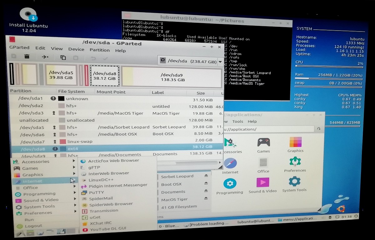

So I booted the Lubuntu 12.04 remix from DVD, and though after a while I had a blank screen and thought the thing failed, when I moved the mouse to my surprise the desktop appeared, even got the 2nd monitor to show a copy of the Alubook screen so I could play around using that monitor (though not at native resolution).
Here's a screenshot below (couldn't copy the screendump to usb nor network so had to take a picture), haven't installed it yet just running a live session to see what can be done, but quite happy I'm finally getting something Linux at least working ! 🙂

I was always a fan of my 12 remix. So lightweight, quick, and more period correct for the hardware. If you do install it, due note the ubuntu 12 repositories are down. You are limited to the software i preinstalled. Having said that, i feel like i loaded that iso up with most everything a person would need (within reason). The browsers (Interweb & Spiderweb) are still newer than TFF/InterWebPPC/AquaFox as they are a mix of FF52.9 & 60.9 and should still serve you well. Good luck, and have fun. 🙂
@wicknix, yeah it looked pretty snappy for the little I tried to do with it. And the collection of s/w you've put in is quite impressive indeed.
Need to determine how to separate the 2 displays/desktops, the Alubook is 1024x768 while my monitor is 1680x1050 but running at 1024x768 (duplicate the main display i/o extending it).
Also couldn't get access to the internet neither via ethernet (connected to a Win11 PC who shares its connection, I've tested it while booted in OS X and it works fine) nor via Wifi, looks like the Broadcom chip is not detected although I've seen the drivers as part of the install ISO, but I may be wrong on this, need to investigate further.
I also couldn't write to an usb flash drive (which otherwise works fine in OS X on the same machine), I think it was set "read-only" IIRC, no idea why.
At some point I'll try the install, in fact I kinda' lied involuntarily in prev message, I was also able to run the Adélie 1.0beta5 desktop from live DVD, things went bad when I tried to install it on the SSD - hopefully will be better off with this promising 12.04 remix. 🤞

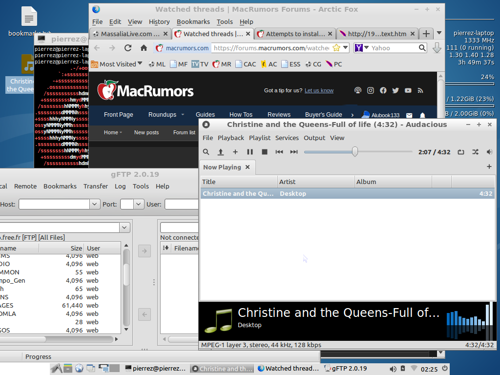

CPU : on high heels while on this page, but pretty calm when in the threads watching page (https://forums.macrumors.com/watched/threads).
Network : now able to browse the web, exchange stuff between Linux and the Win11 PC (via browser, own simple web script) and use gFTP, all this via wifi. Ethernet bridge decidedly not working (I think it stopped working after a Win11 forced update, what a surprise ! :/), in fact I have unplugged the ethernet cable to avoid recurrent error messages.
Audio : fixed - at least can play an mp3 song, a good starting point. 🙂
Reactions: wicknix
CPU on high heels while on this page
Probably do to the ads. I included a custom hosts file to block ads system-wide. Just do this:

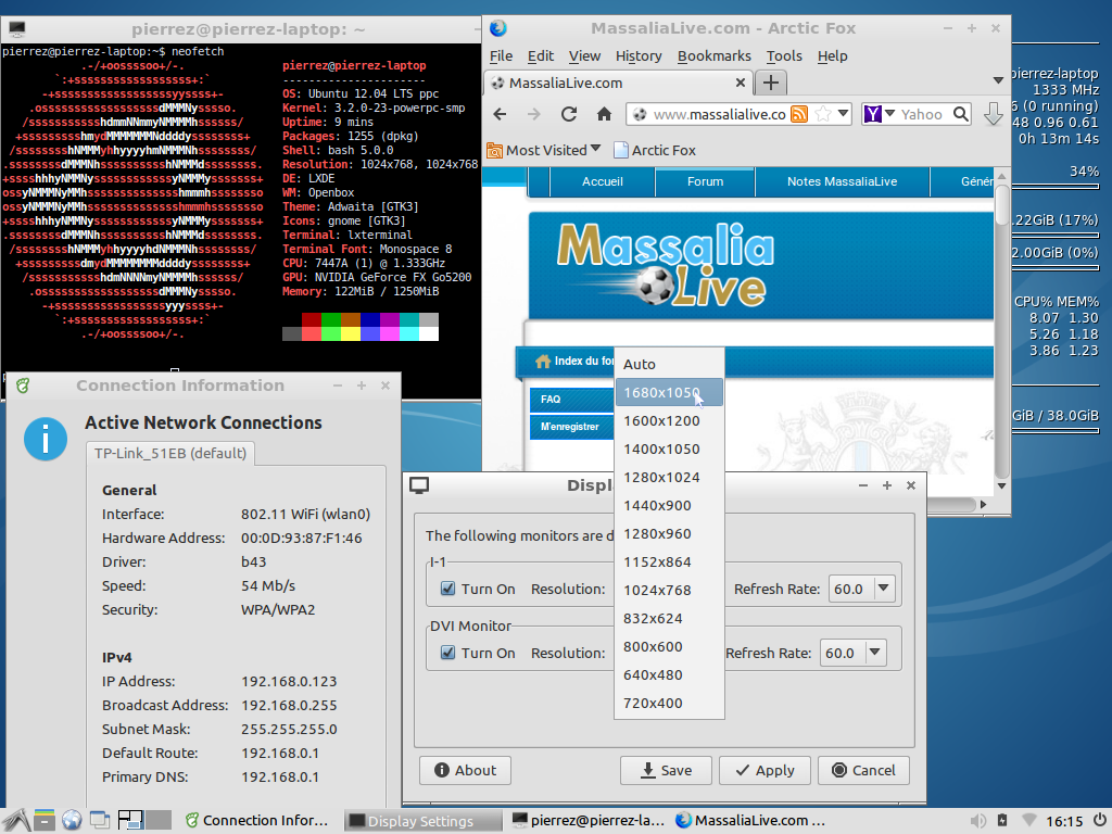

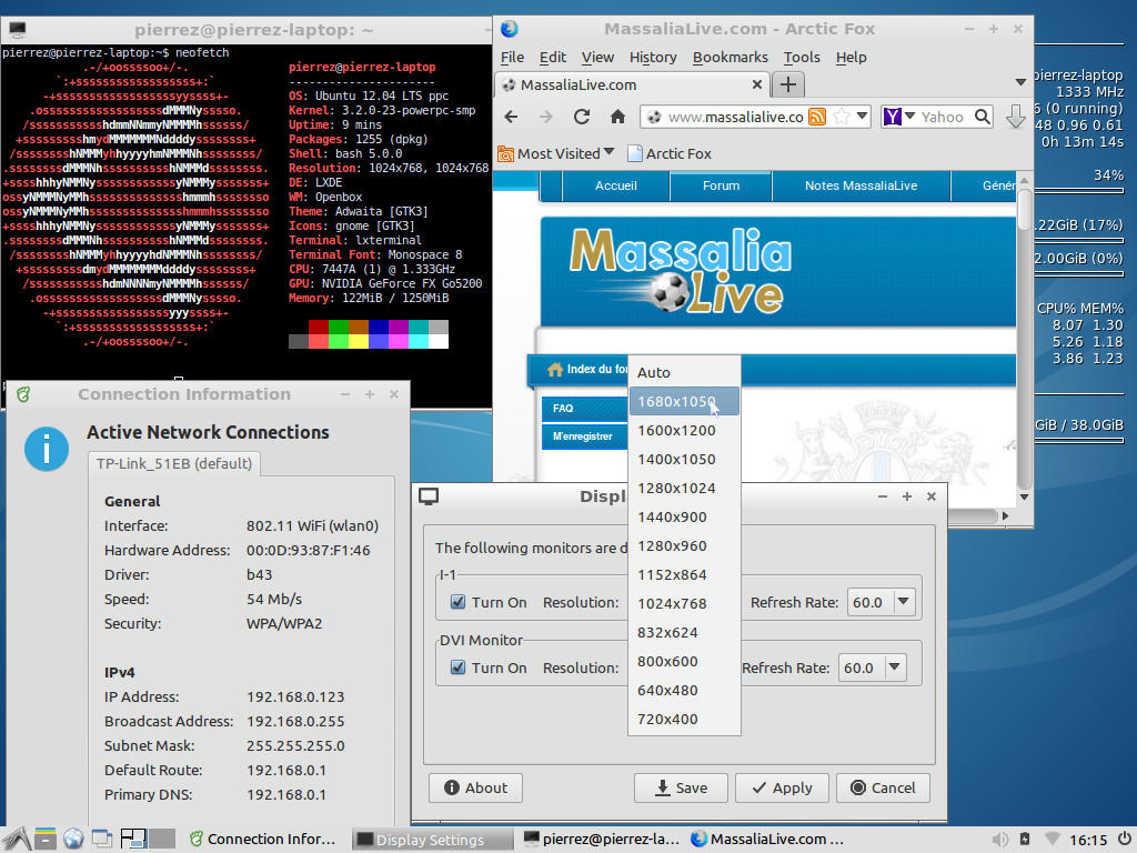

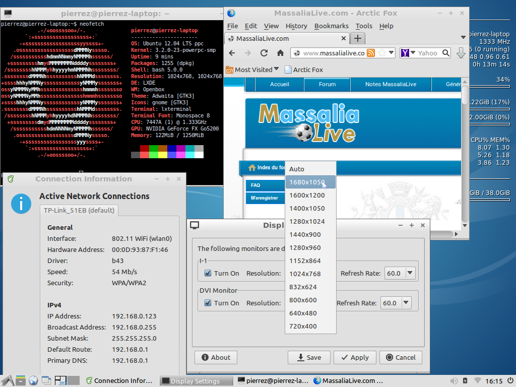

Now looking into being able to use an external monitor (Viewsonic 22" 1680x1050, great one and 0 dead pixel after >12 years of daily usage).
The monitor is correctly detected since that resolution is indeed offered among others, however internal and external displays are set to mirror one another (the Alubook 1024x768 display being "king") instead of having the external monitor as an _extension_ of the main one.
I've found this explanation on how to change this behaviour, not sure it's effective though. I've tried this : sudo apt-get install arandr as suggested, but it refuses to install with an error message that I can't paste here for god knows what reason.
Any idea how to do this ?
EDIT : just saw your last message, will try this right away, thanxx !
