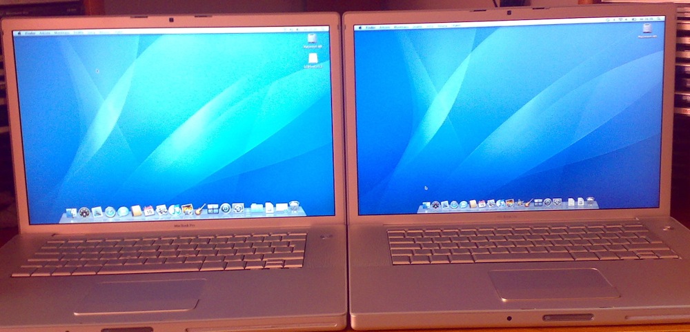

at the left SR 9c67 display and on the right penryn 9c80 display. they dosnt have yellow issue butttt.... screens are terrible because they have these shadows, its like watching on the dirty screen... i think apple is not capable at this time put some good screens on mbp. also look at the difference between brightness. Old SR screen is much brighter. i would say at this time apple sucks.:mad:

I can't see the shadows in your pictures. It looks like the one on the right is just darker overall, but that could just be that the photos don't show the problem as clearly as you see it. Have you tried calibrating the display?

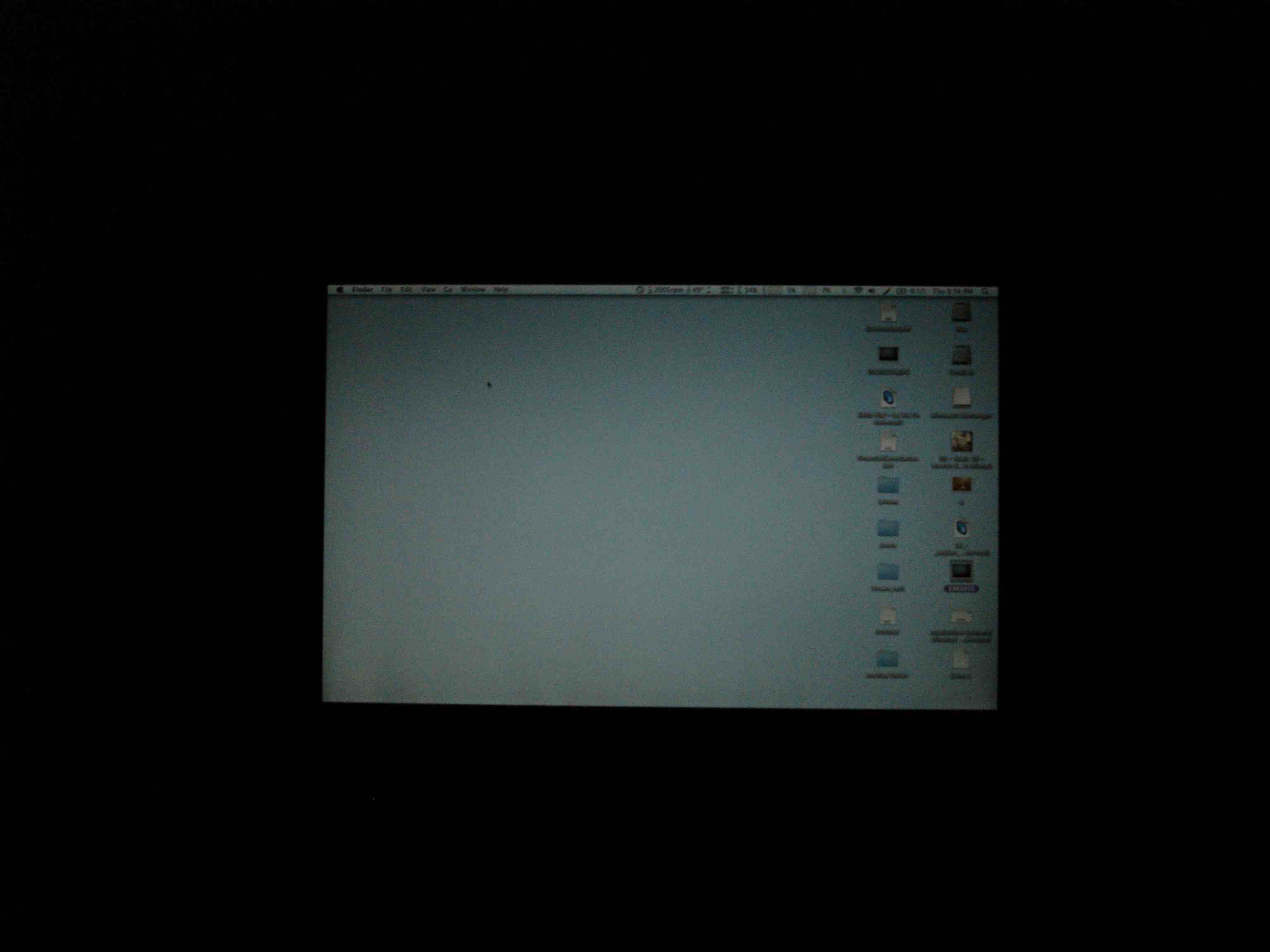

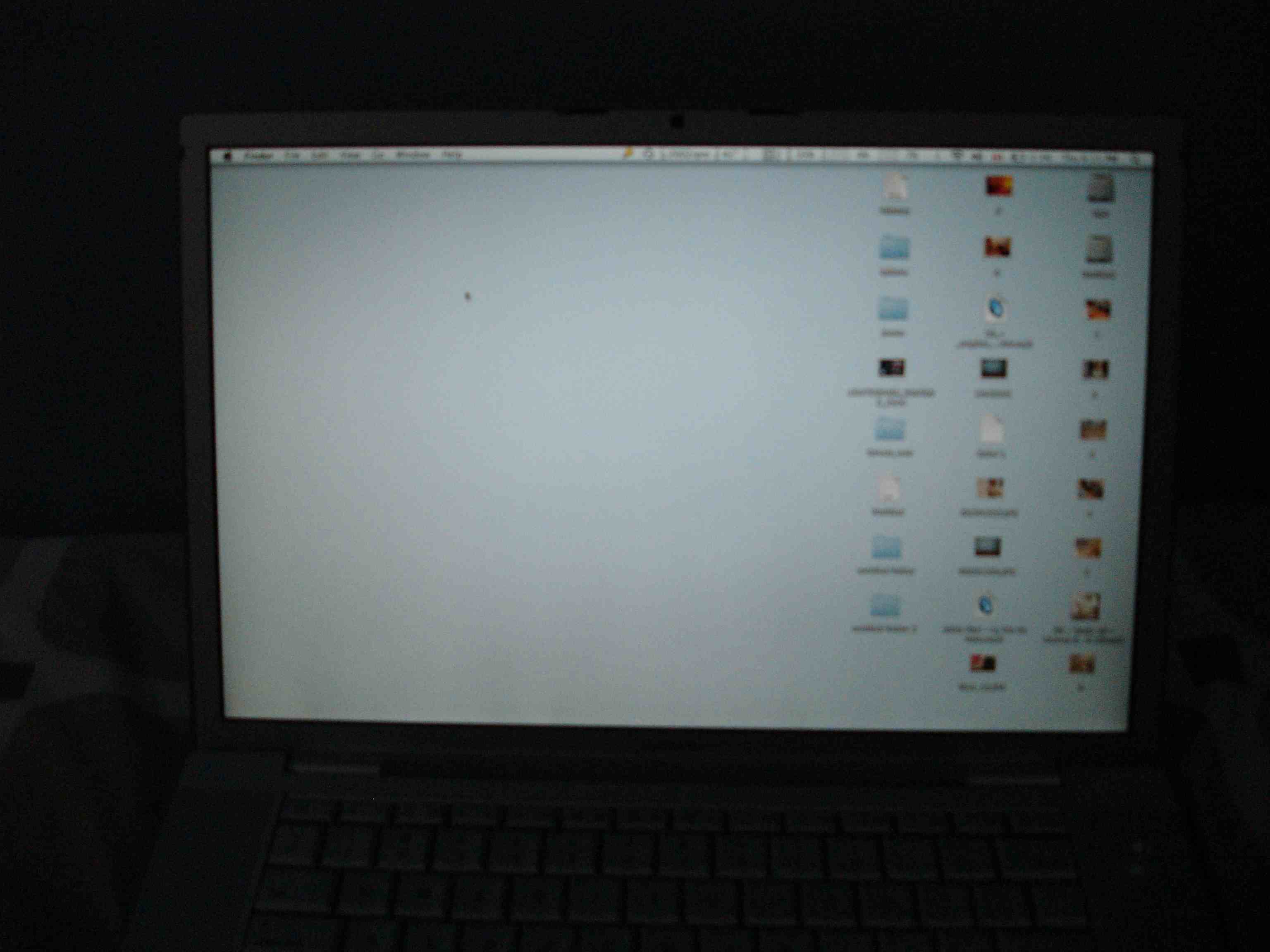

Second, i want to say, i just back from my 3rd display repaired today.
I got a LG again (9C67) LP154WP2-TLA1, this is still the pervious SR MBP LG display. The 9c81 is TLA2.
This one seems fine to me. very very minimal yellowing on the bottom.
And a little bit bright strip along the bottom left, only noticeable when the brightness is low ( less then half). This LG is very white , a little bit uncomfortable compare to my warm and yellowish Samsung. And the bottom left is brighter then the rest.
I would go for it. unless someone can take a picture side by side to compare
LG vs other Display in terms of color quality. Which i think the samsung i have owned is very vividly in terms of color.
CHECK MY PICS,, do u think this one is good to go ?

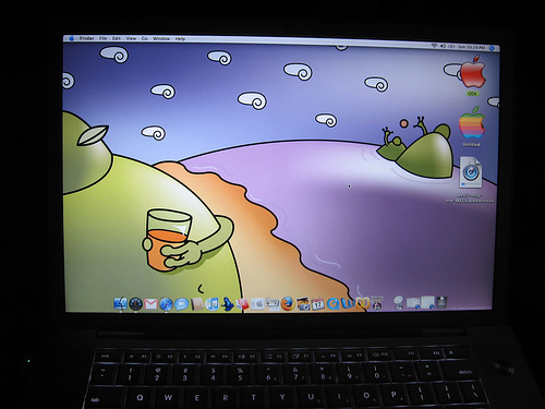

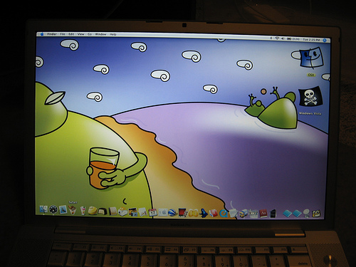

Color difference b/w LG and Samsung
This is the pic taken by jjahshik32
Showing the differences between his LG and Samsung.
1. LG
2. Samsung
