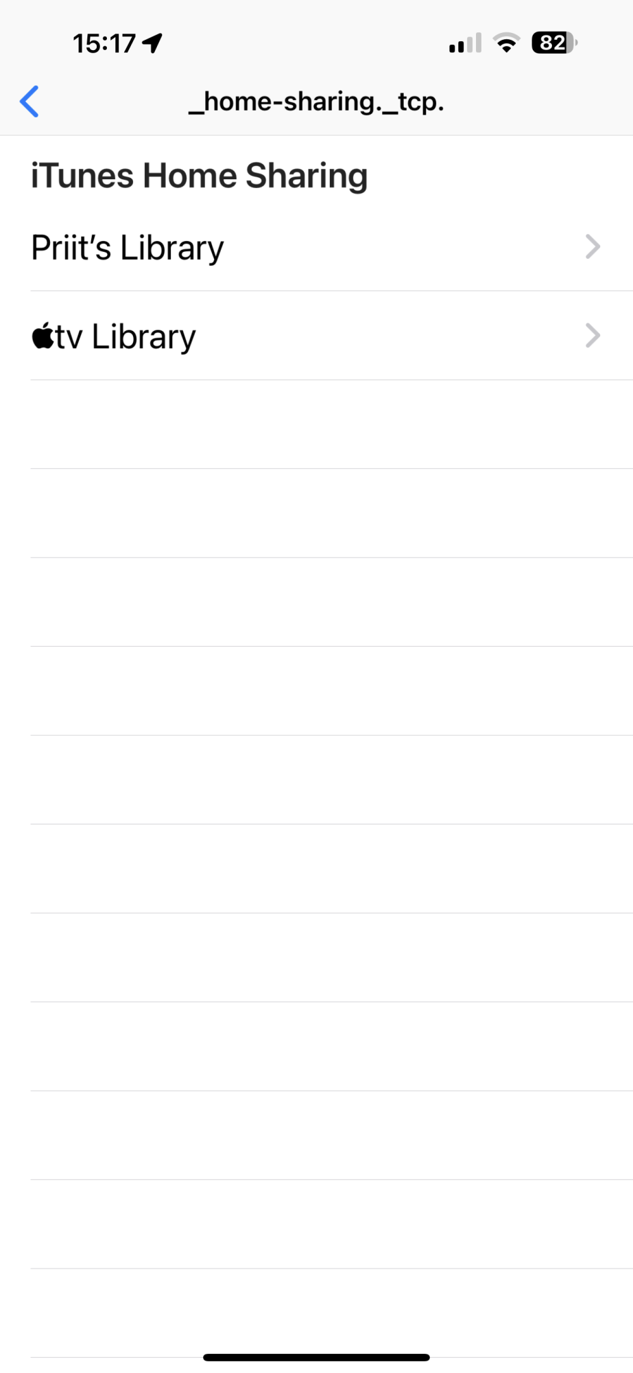

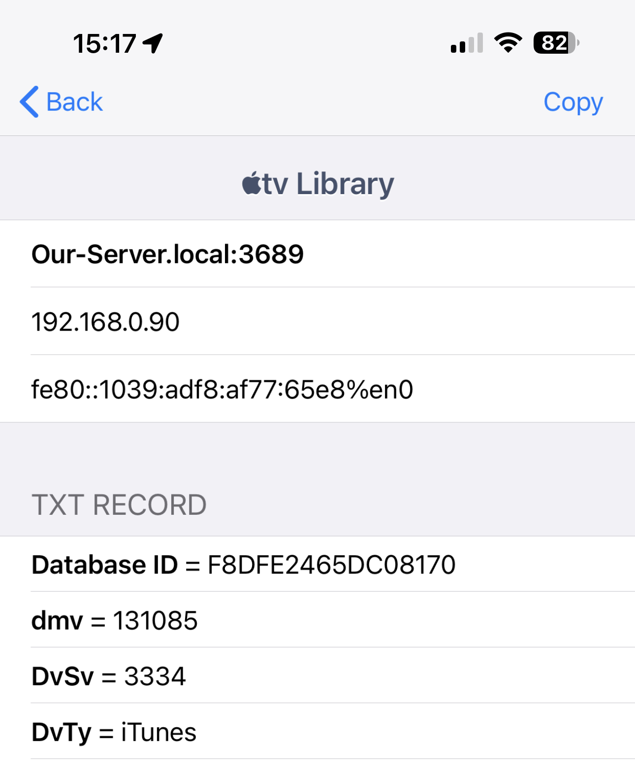

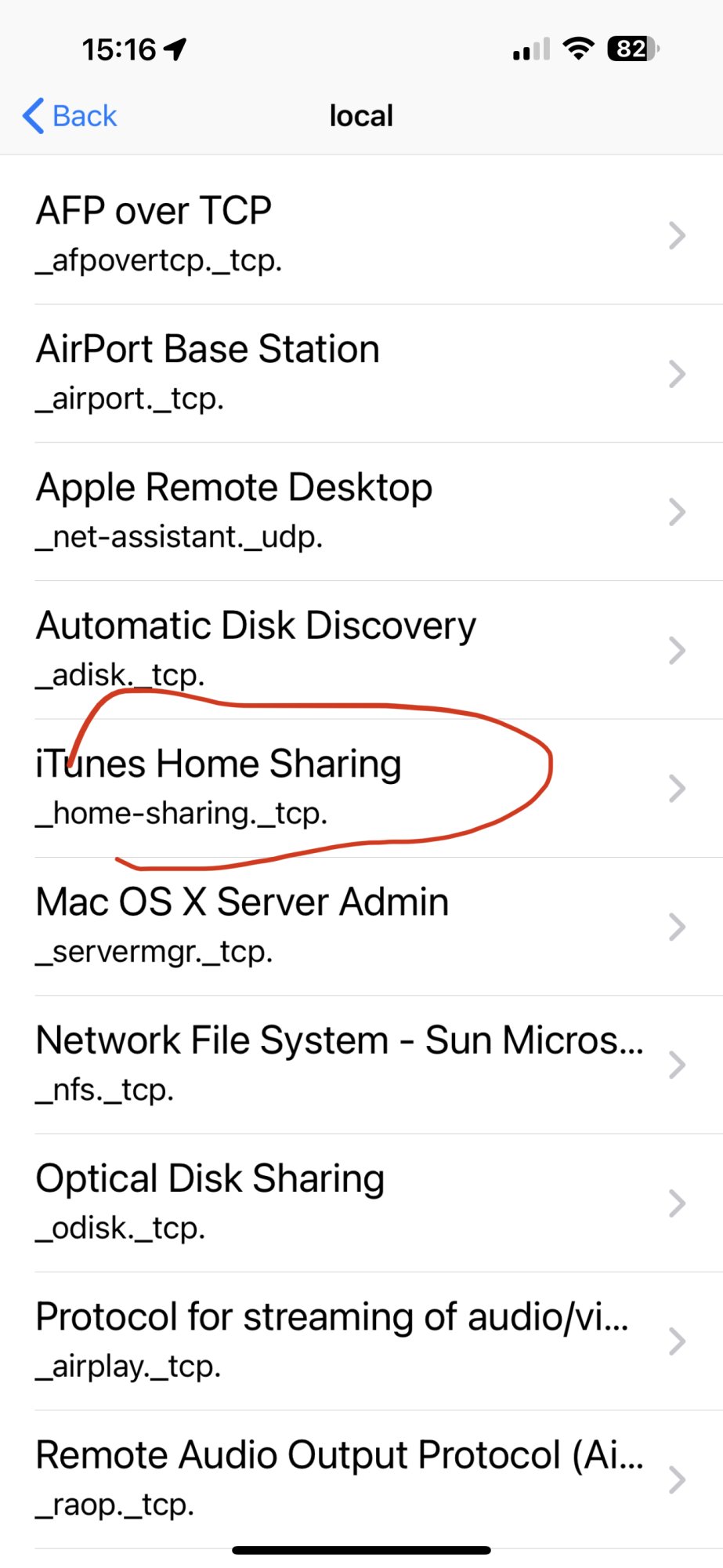

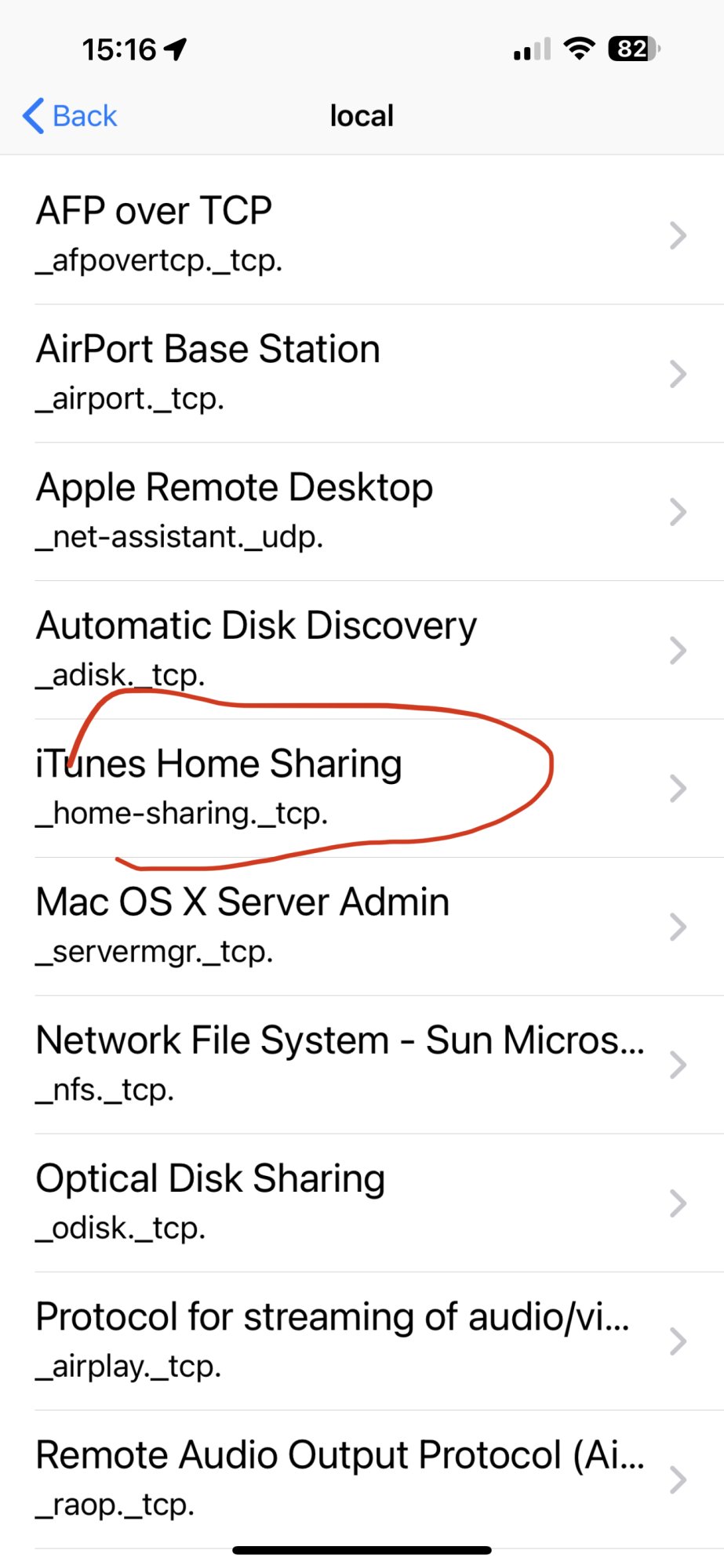

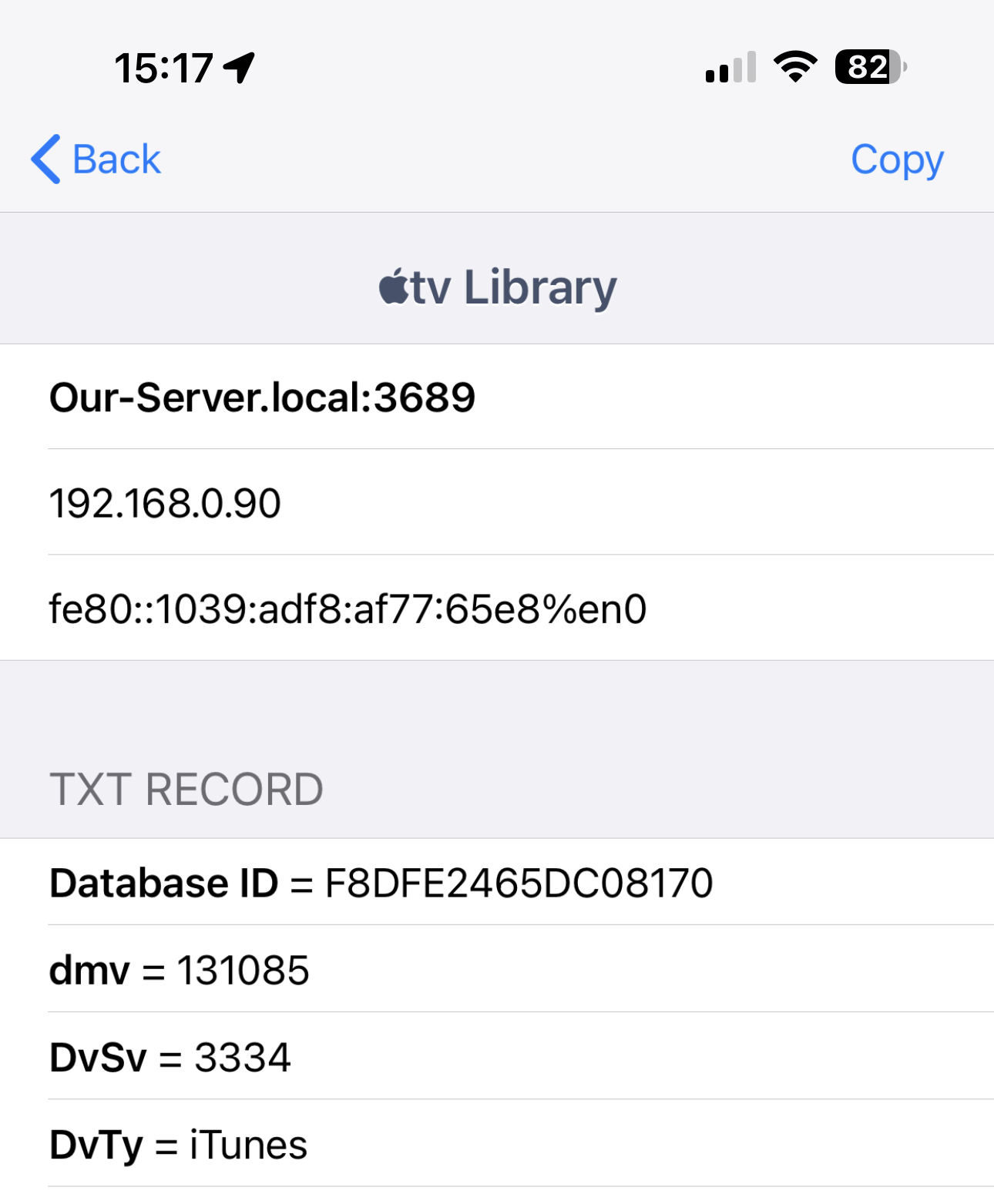

I would check with the DNS-SD discovery app, whether the Home Sharing service is properly advertised on your network.

FWIW my network infra is also all Apple's AirPorts.
